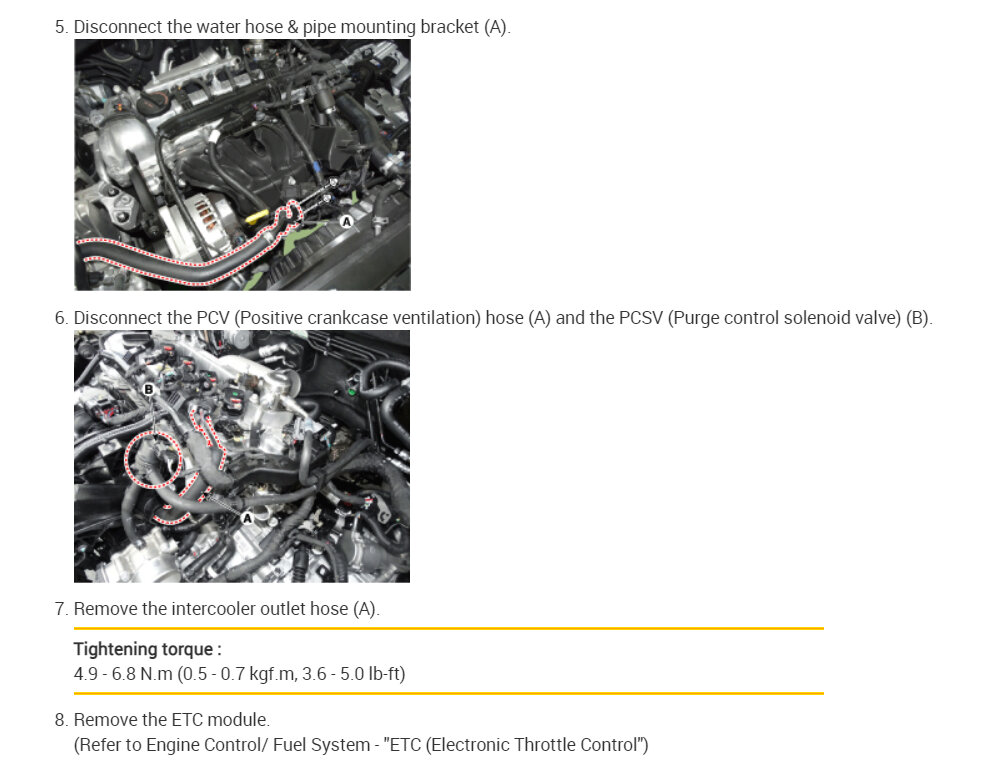

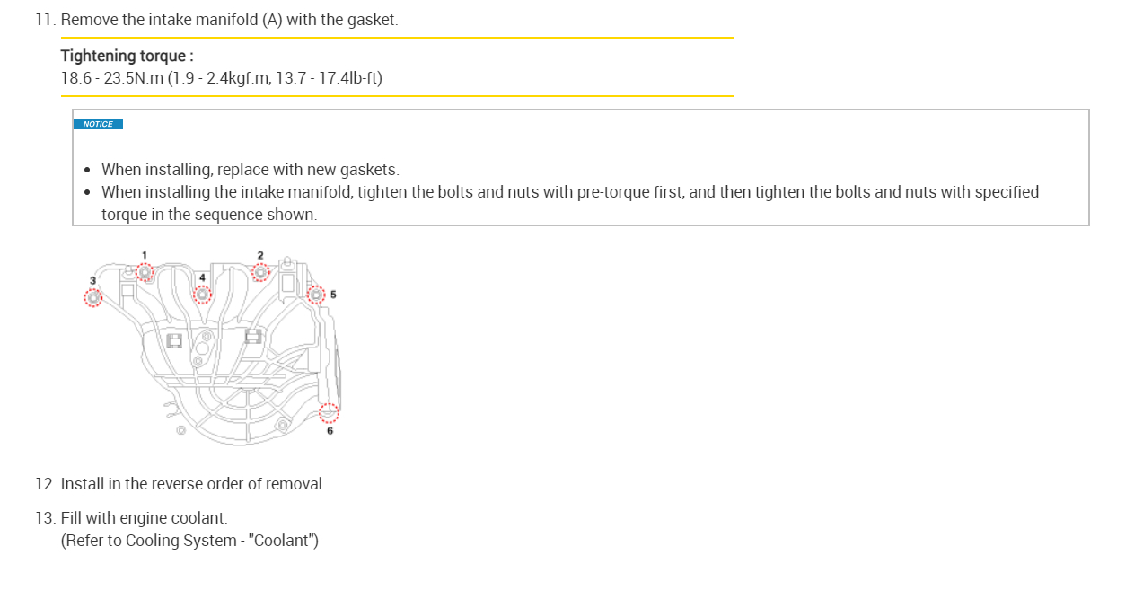

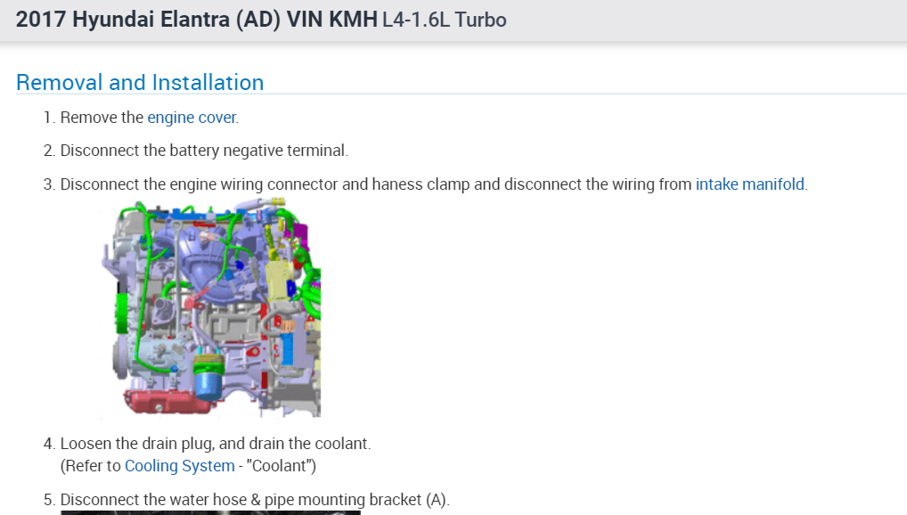

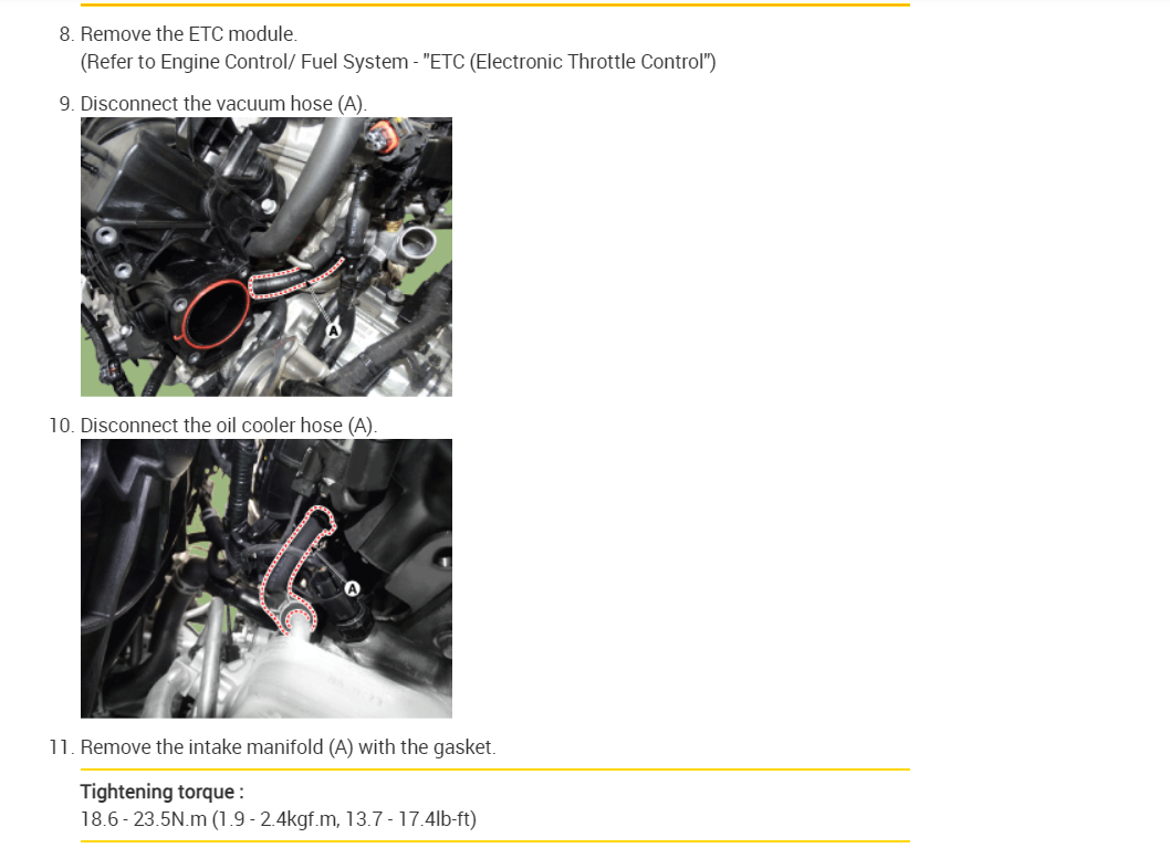

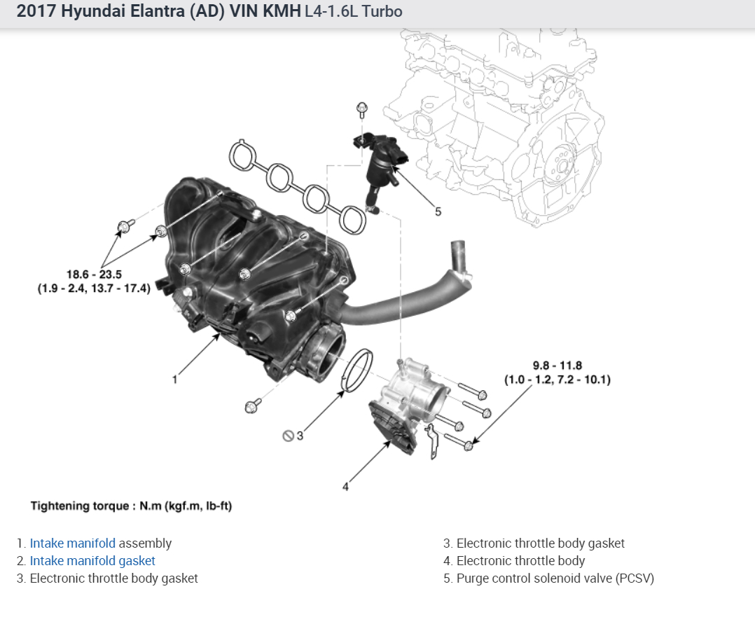

VIS valve? I have looked in the engine wiring diagrams, and the intake manifold itself and cannot find what you are referring to? Check out the images below. Can you upload an image for the part you are talking about? Check out the images (below). Please get back to me.
Nov 4, 2022 at 12:51 PM

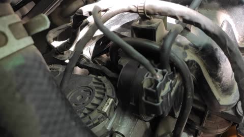

Yes, it's VIS valve! it doesn't move when the engine is running...
Nov 5, 2022 at 4:45 AM

Thanks for the video. Yep, it is not moving, Please remove the vacuum lines to see if one of them has vacuum, if so replace the valve.
Nov 5, 2022 at 1:07 PM

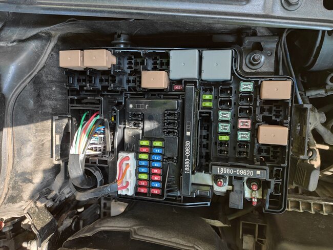

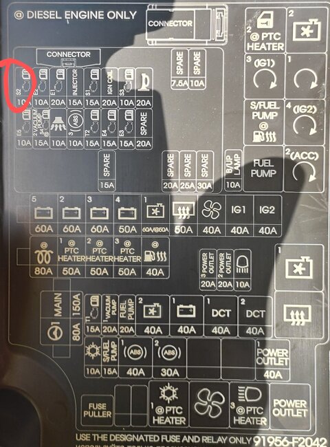

VIS and PCSV valves are connected to the same 10-amp fuse in the main relay. but this fuse is not damaged.
It's S2 fuse.

Check out the intake manifold image above there is no intake runner control. which country is this car from?
