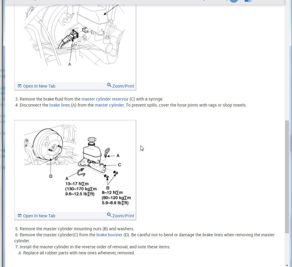

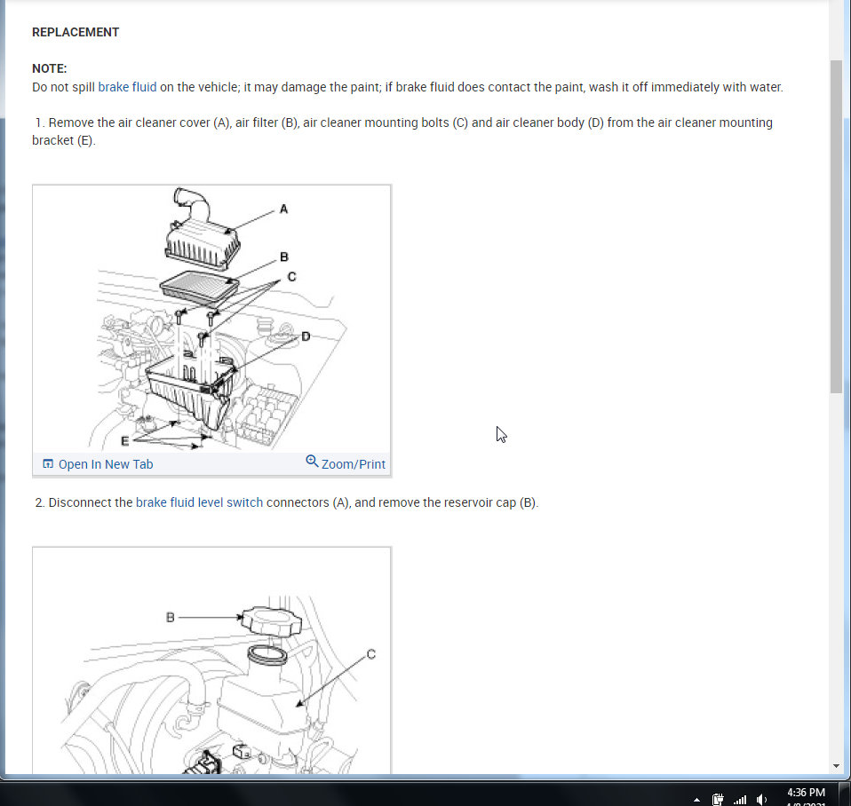

Plus here is the process below from the manual on how to replace this.
Please run through this material and let us know what questions you have.
