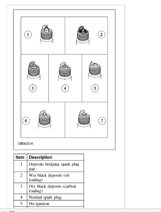

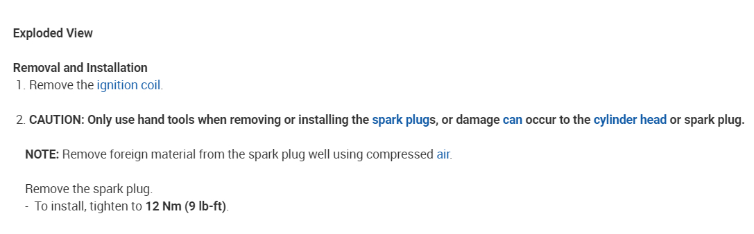

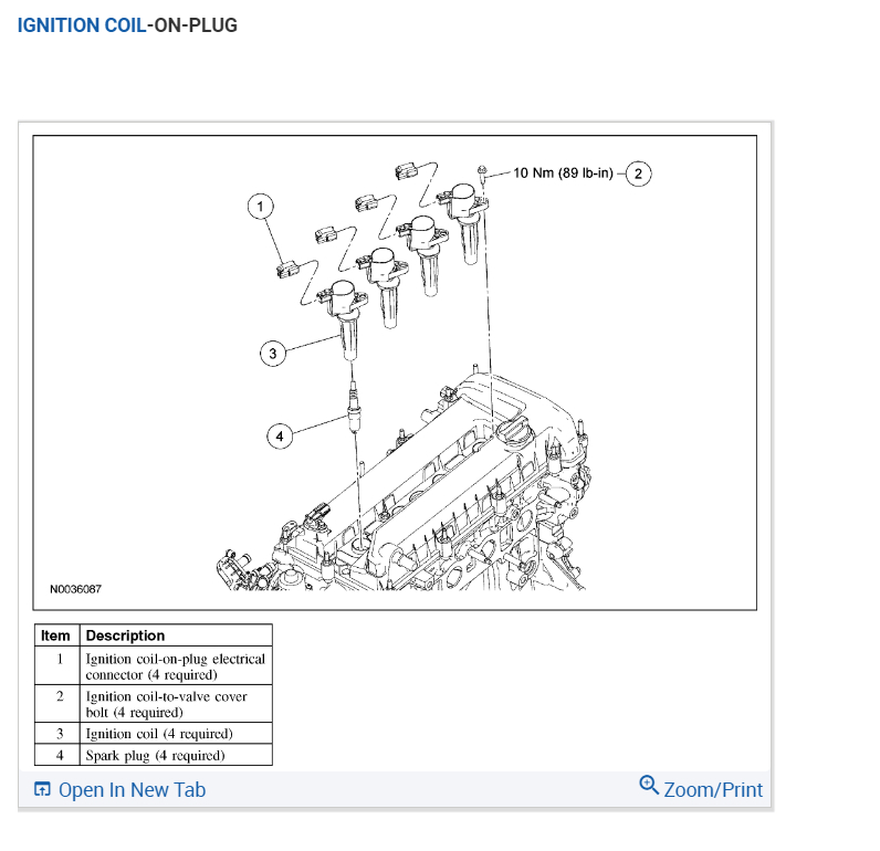

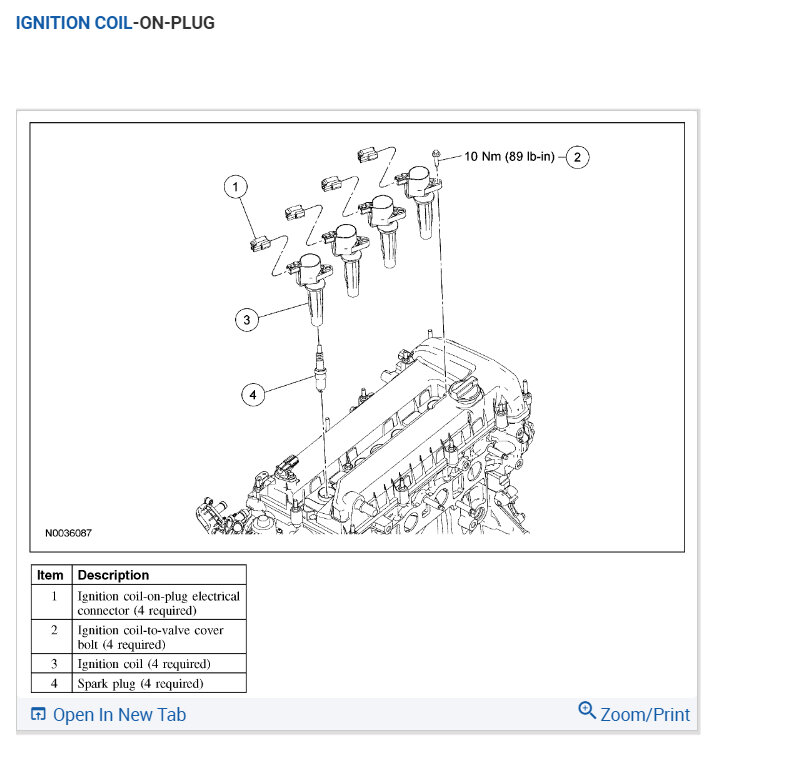

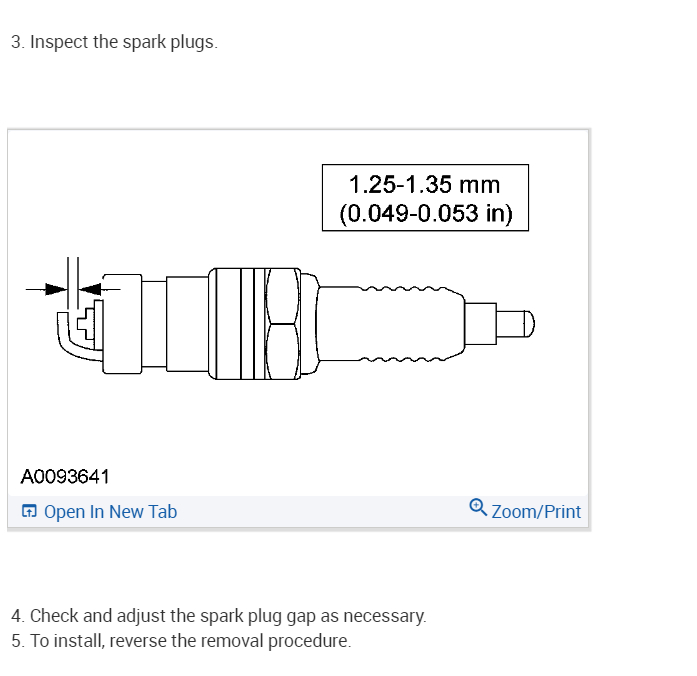

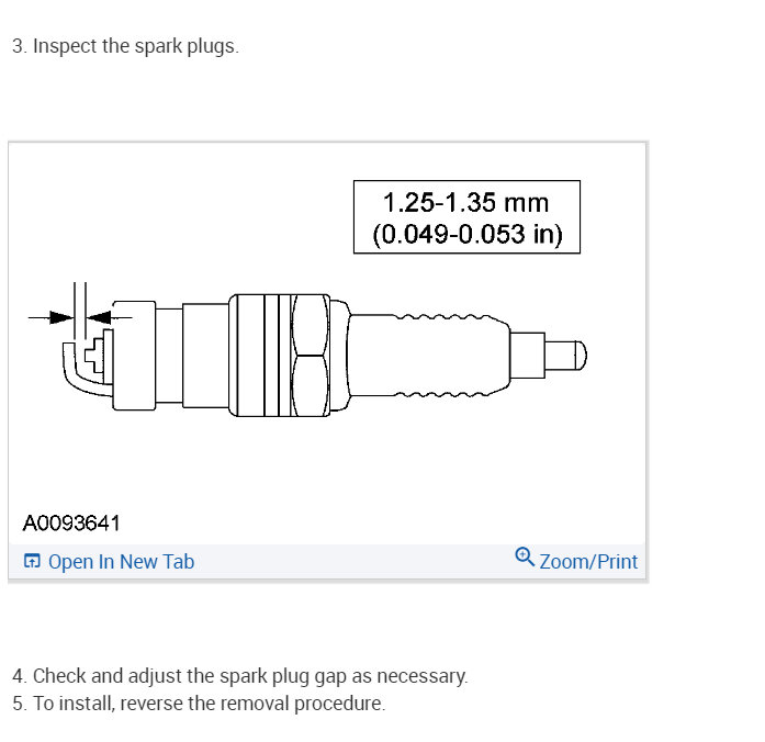

This is typical when the engine needs a tune up. I would start by replacing the spark plugs and then service the throttle body. here are guides to help fix the problem and the instruction in the images below to show you how to do the job one your car. I would also replace the ignition coils they go out as well.
https://www.2carpros.com/articles/how-to-tune-up-a-car-engine
and
https://www.2carpros.com/articles/engine-misfires-or-runs-rough
and
Original spark plug .................... AGSF22YPC
Replacement spark plug .................... AGSF22YPC
Gap - 1.25 - 1.35 mm (0.049 - 0.053 in)
Torque - 12 Nm (9 lb-ft)
Check out the images (below). Let us know what happens and please upload pictures or videos of the problem.

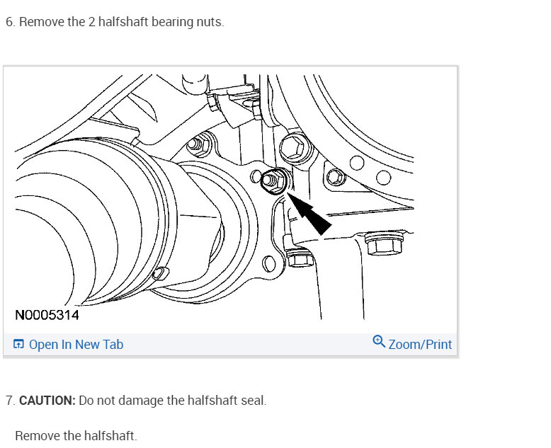

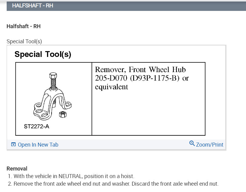

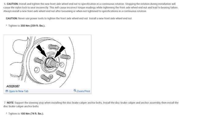

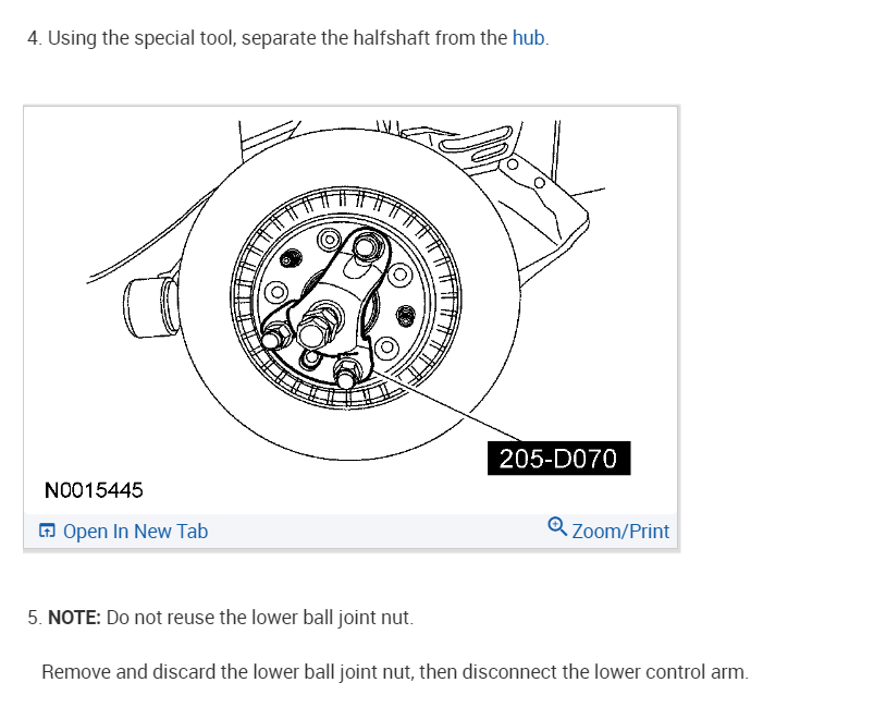

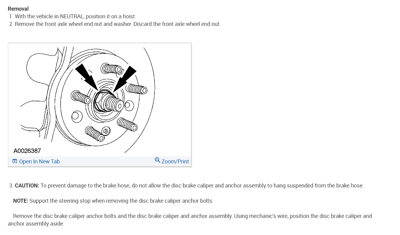

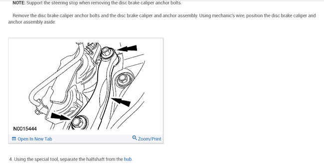

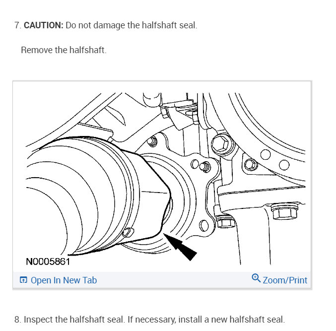

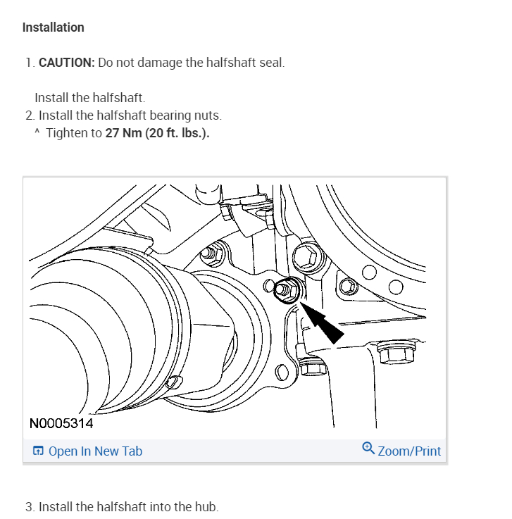

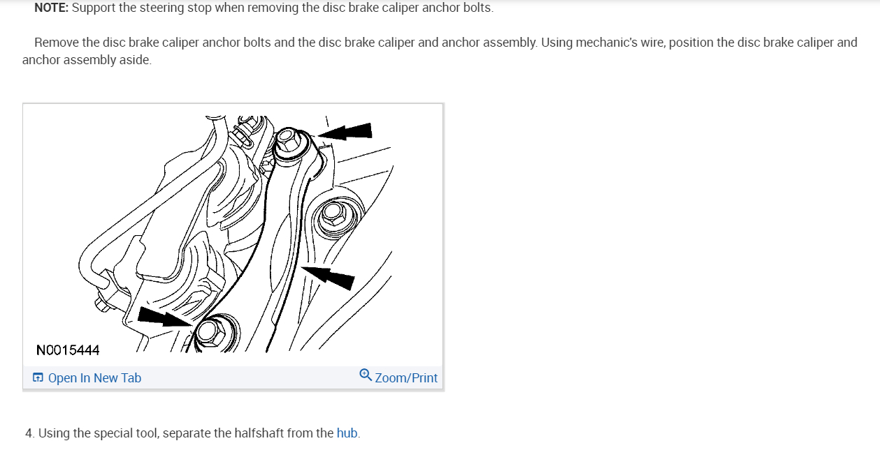

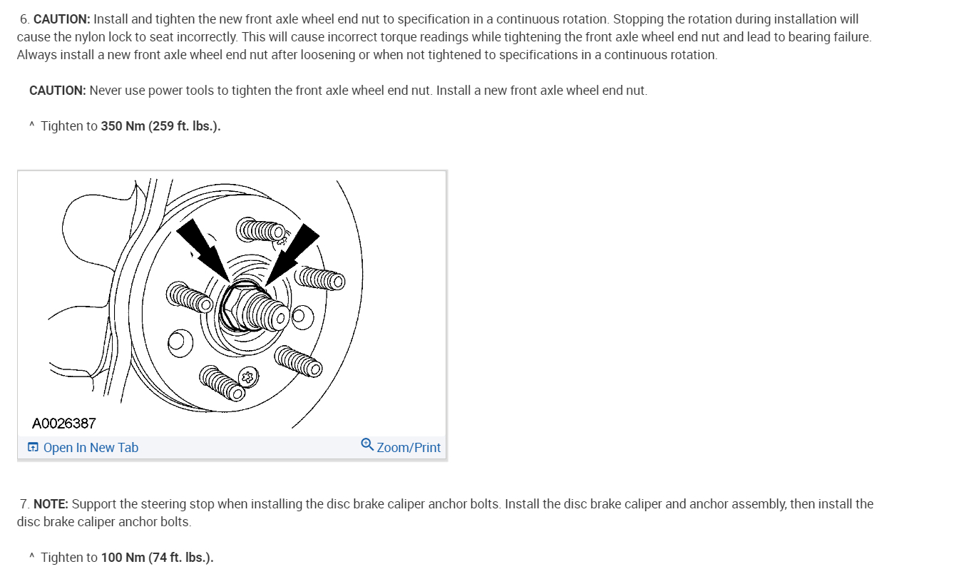

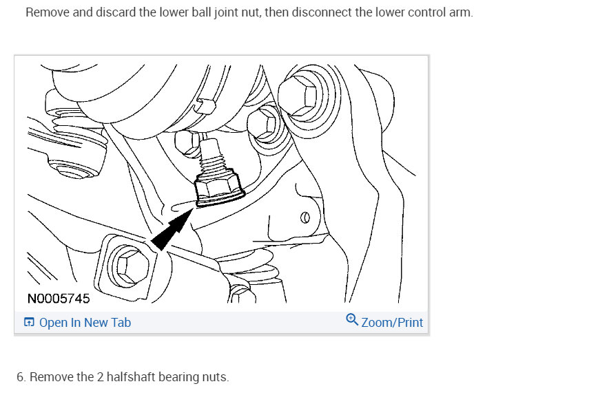

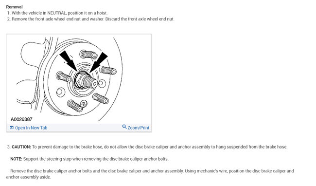

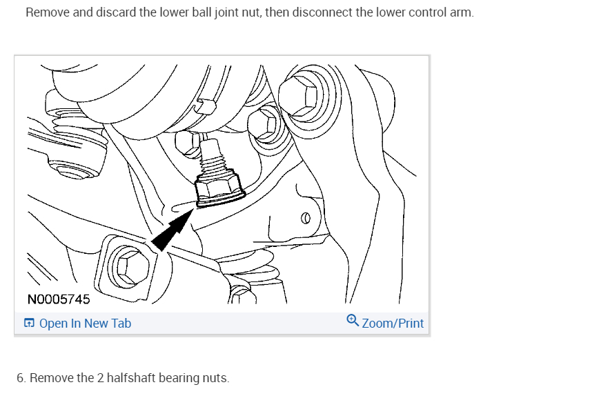

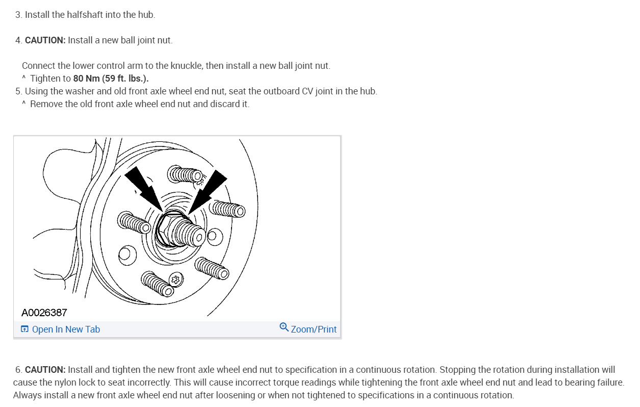

Let's try this again, it sounds like you have bad CV axles which can cause this issue. Here is how you can change them out in this generic guide to help walk you through the steps and check out the images below on how to change them out on your car.
https://www.2carpros.com/articles/replace-cv-axle
