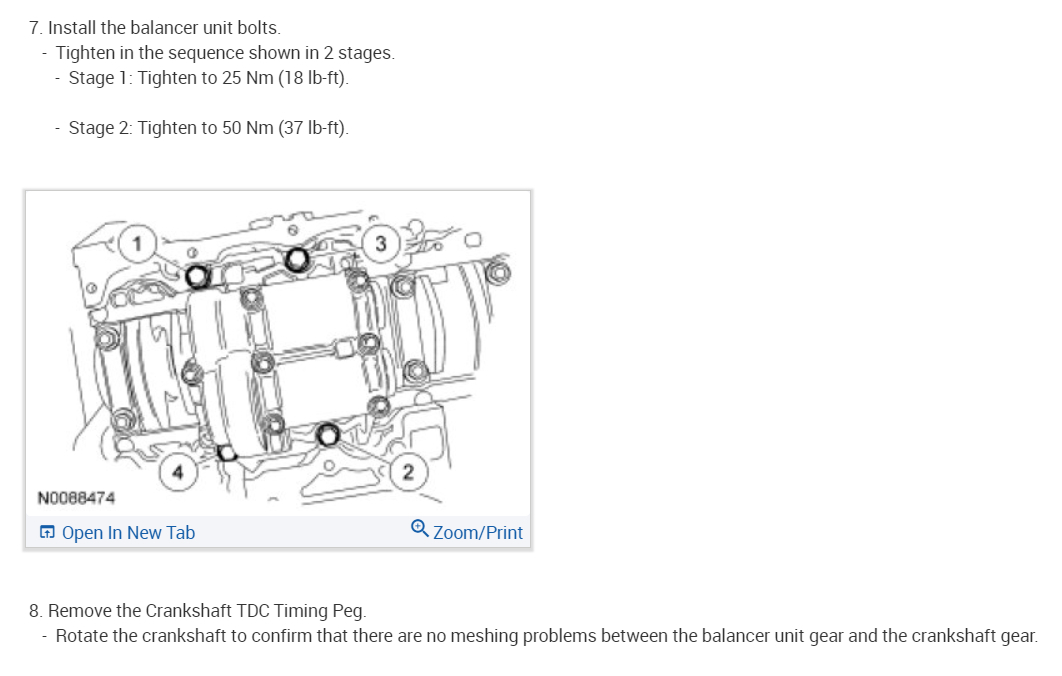

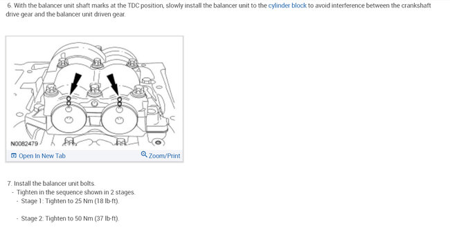

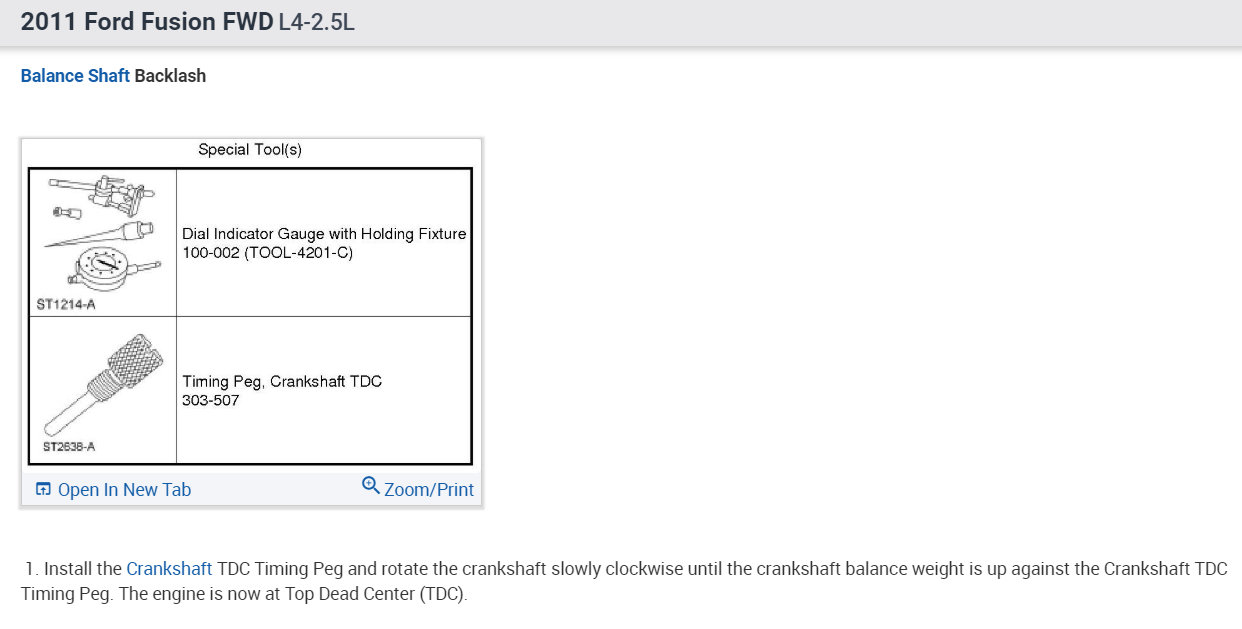

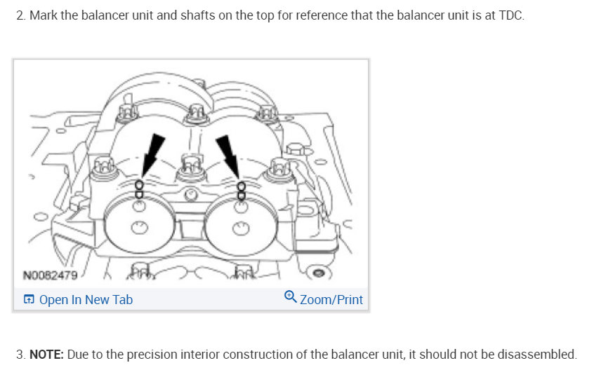

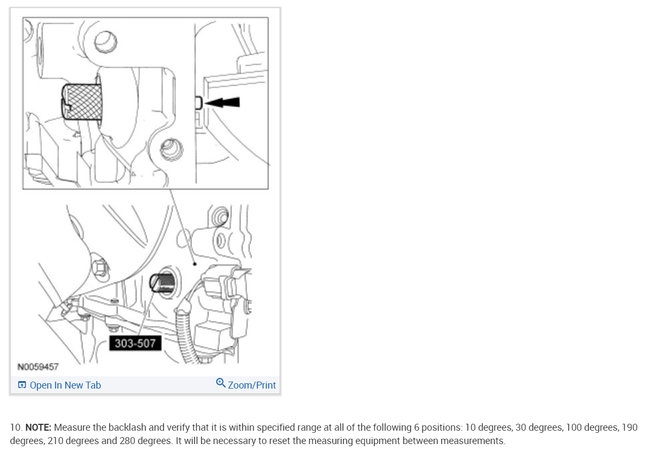

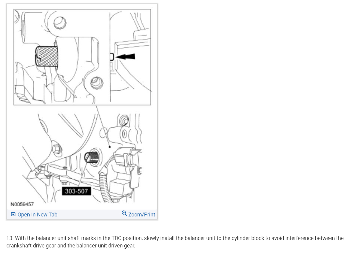

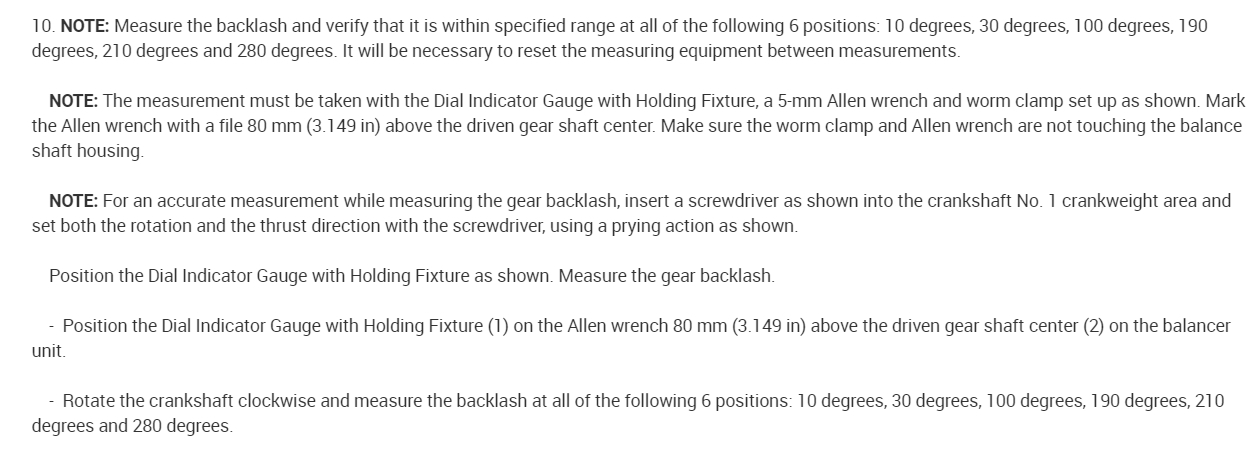

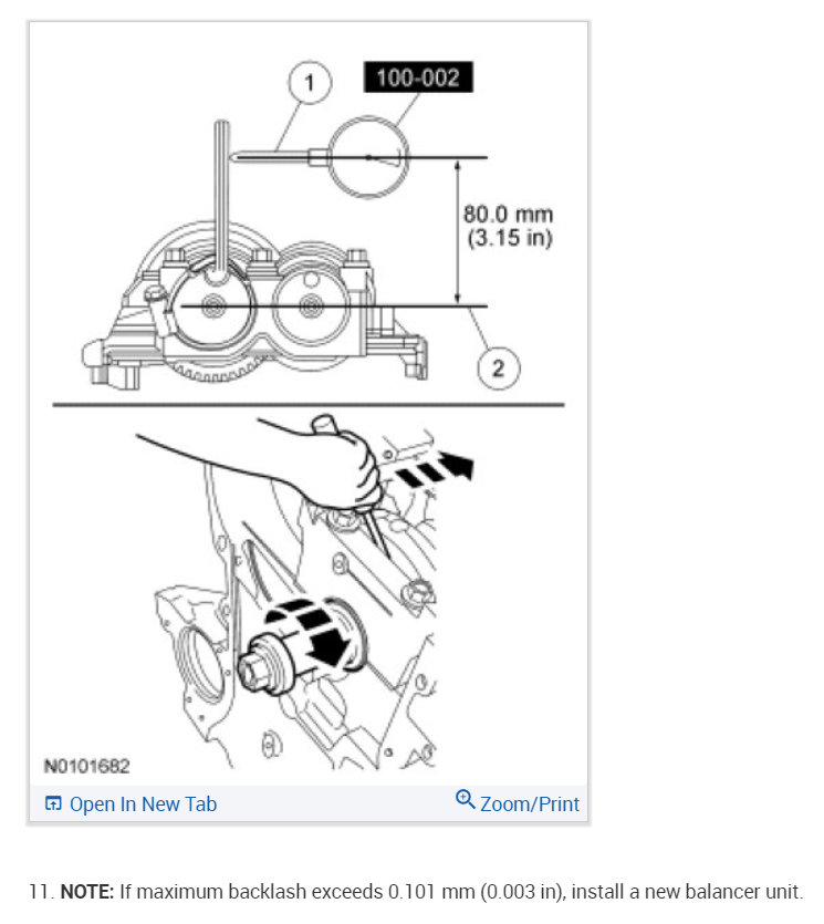

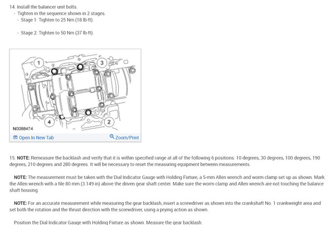

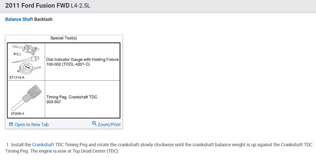

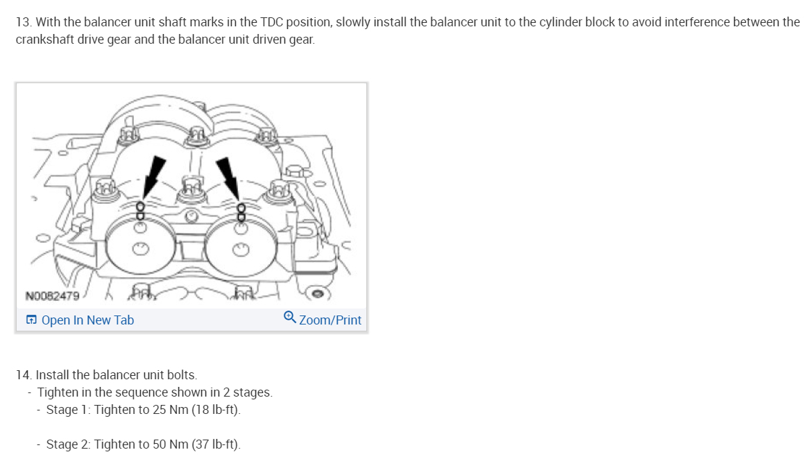

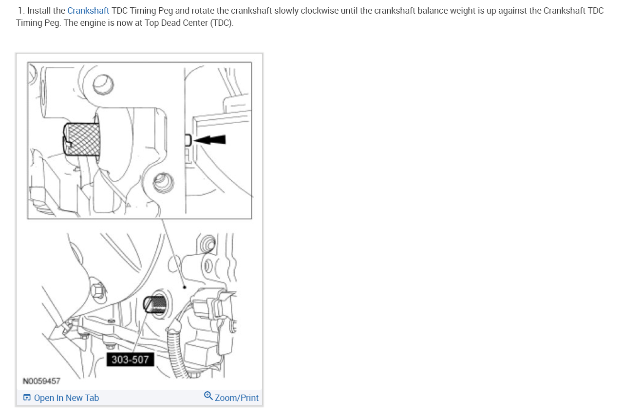

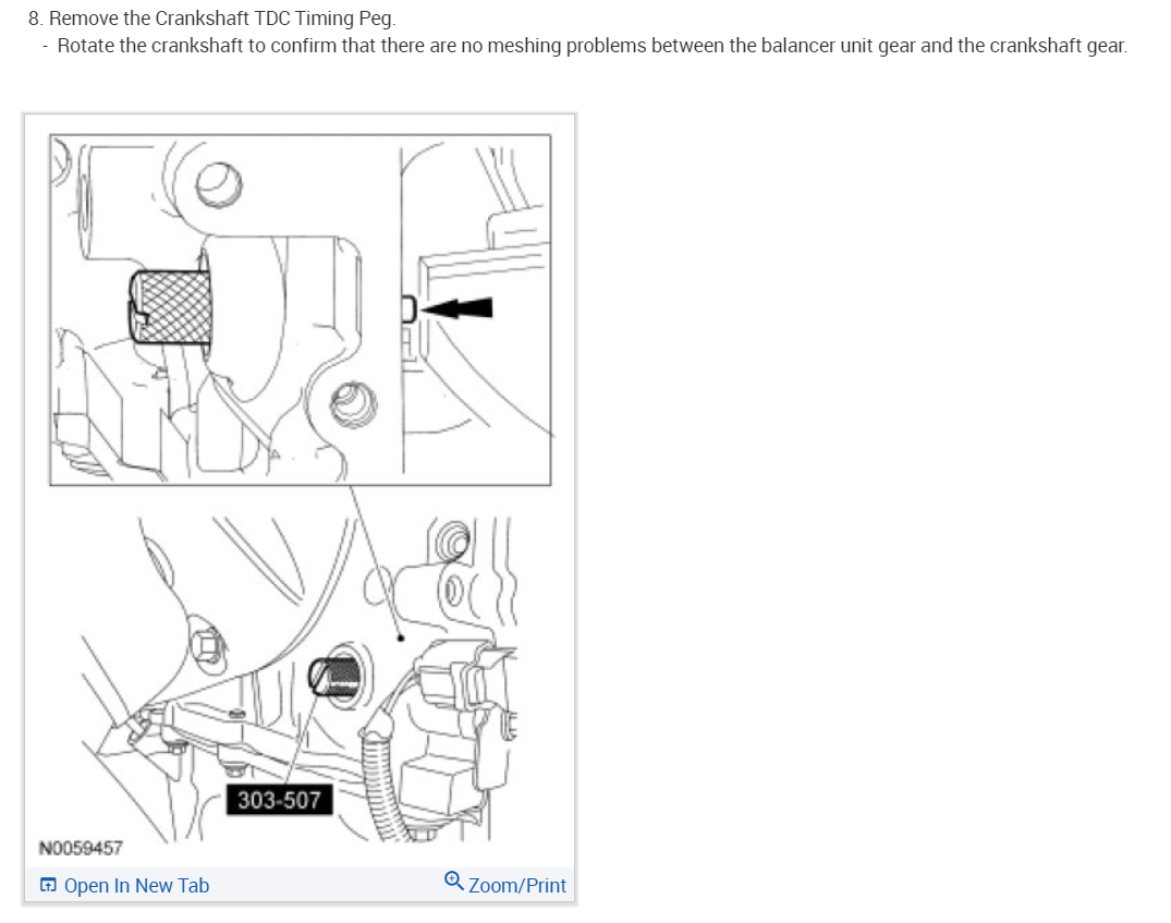

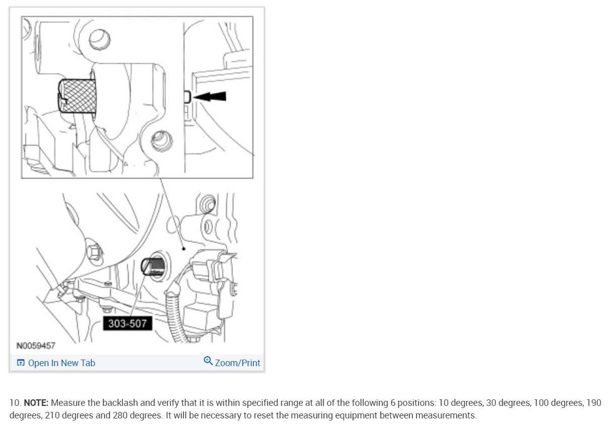

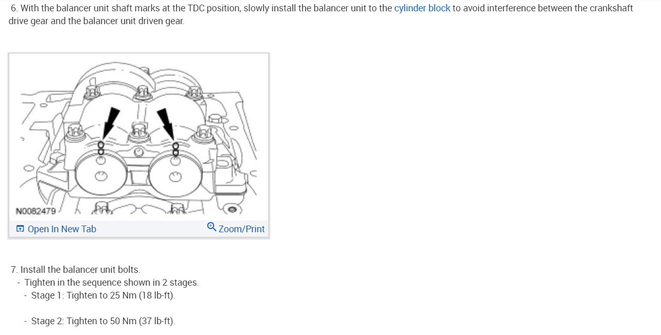

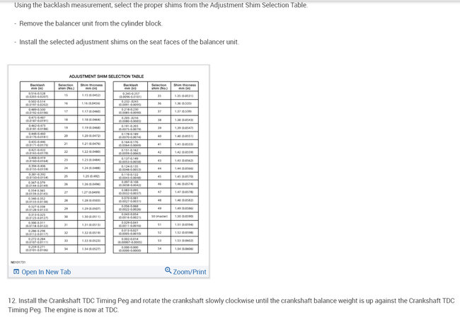

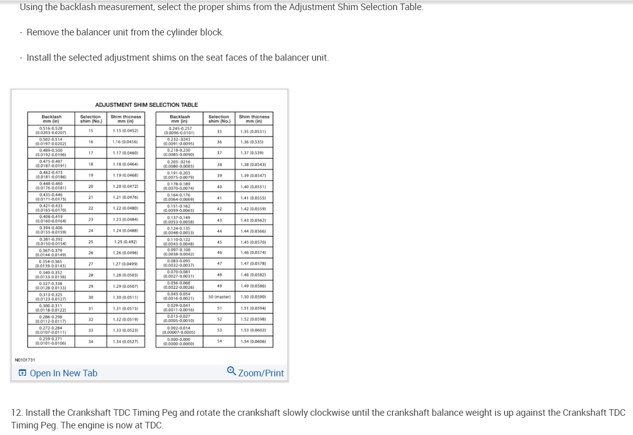

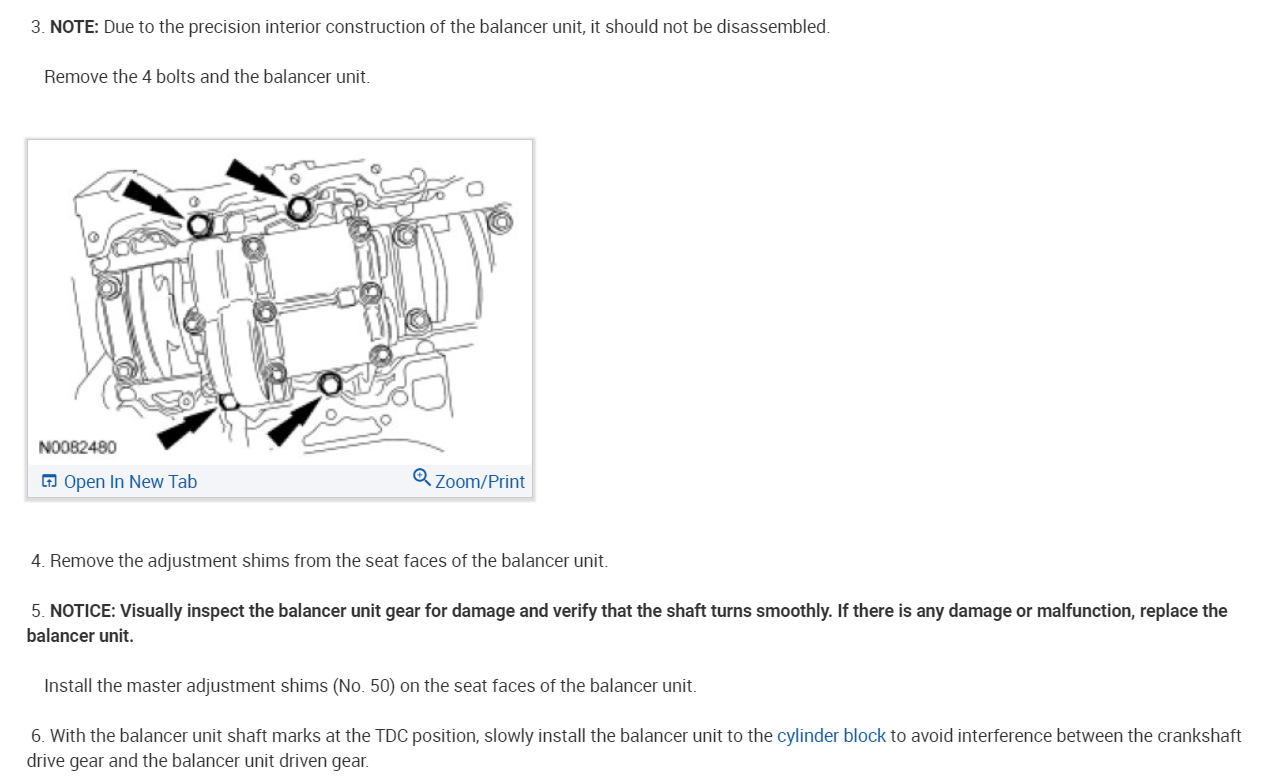

Yes, this is a balance shaft engine which could be worn or broken not cancelling the engine vibration. Here are instructions for checking the balance shaft component of the car. Check out the diagrams (below). Please let us know what happens.

After I wrote my update, the car idled very well over the weekend. I was pleased. Today it seemed more like it had been. Confusing.
I don't think that I will spend $400.00 for the dial indicator in the instructions. Looking at replacement parts I could replace the whole balance assembly for under $200.00.
I assume this assembly is at the bottom of the engine. Does the engine need to be pulled to check or replace the balance shaft?
Feb 11, 2019 at 4:49 PM
If the balance shafts are a problem it vibration would not come and go and it would be noticable. The engine oil pan needs to come of to check the condition of the balance shaft module.
