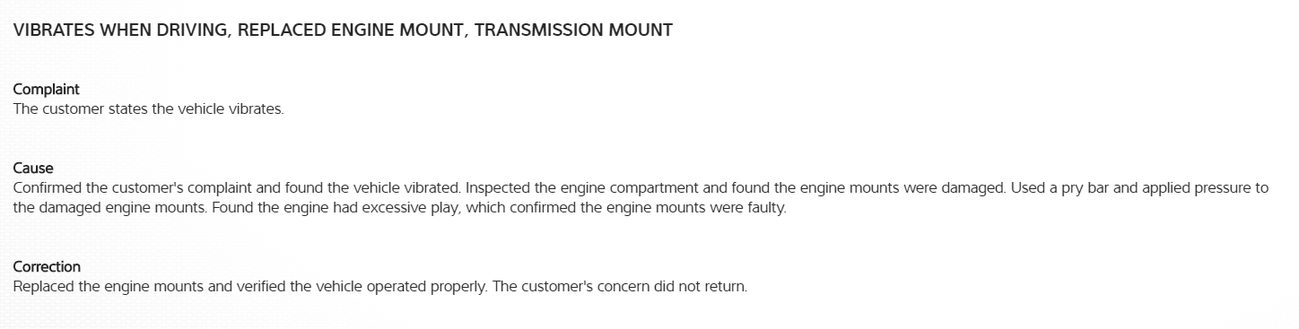

Hello again,
Have you inspected your motor and transmission mounts? down below I've included a probable diagnosis for your issue and the fix. Let me know what you find out.
Thanks,
Alex,
2CarPros
