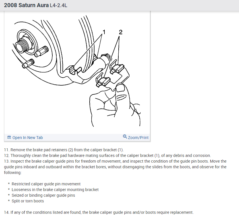

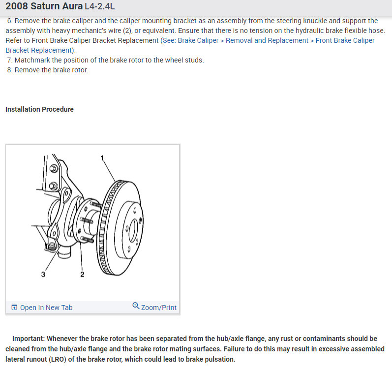

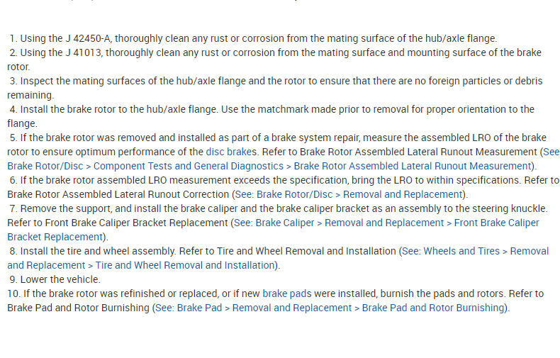

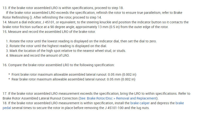

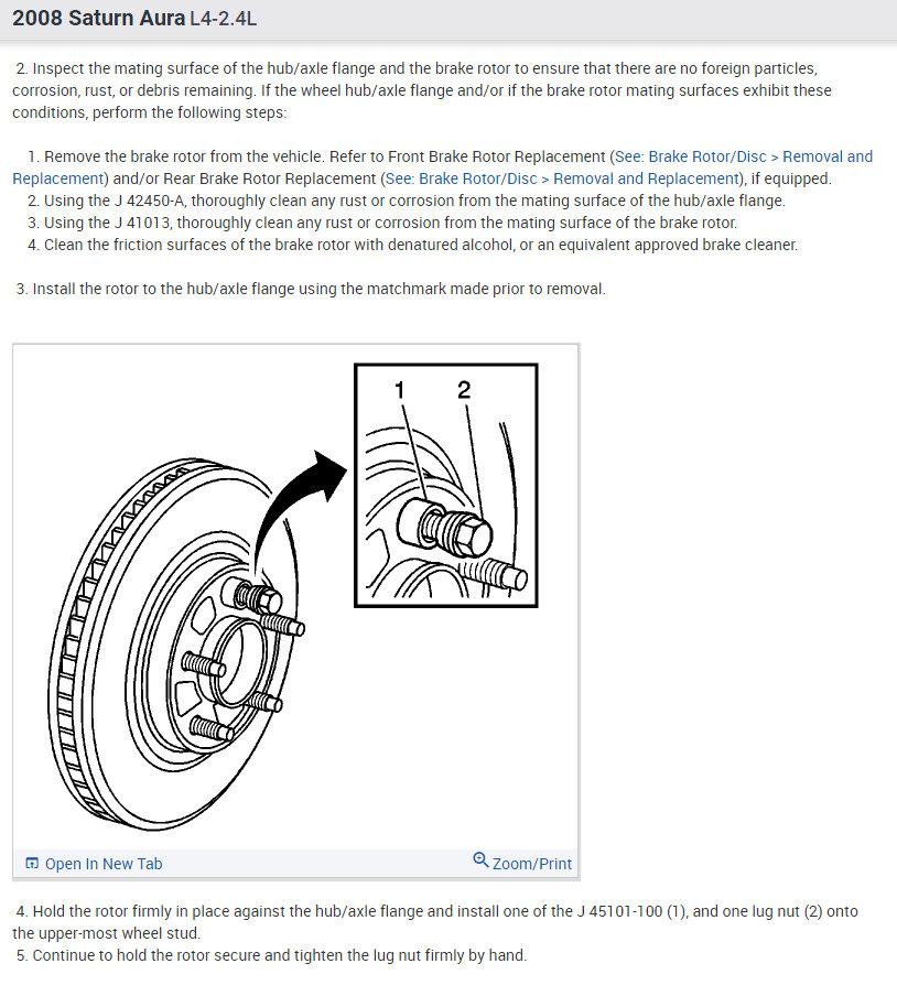

If the brake pedal pulsates when depressing the pedal, then it is likely wrapped brake rotors.
You have mentioned that the rotors were resurfaced few months ago, but keep in mind that if the rotors were at or below the minimum specifications they can be wrapped much easily.

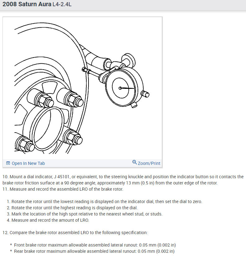

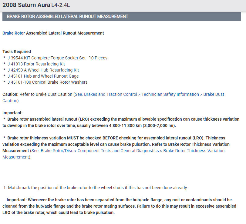

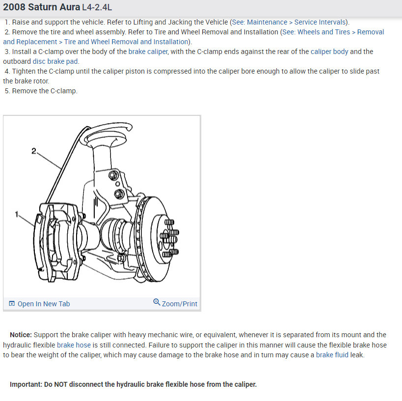

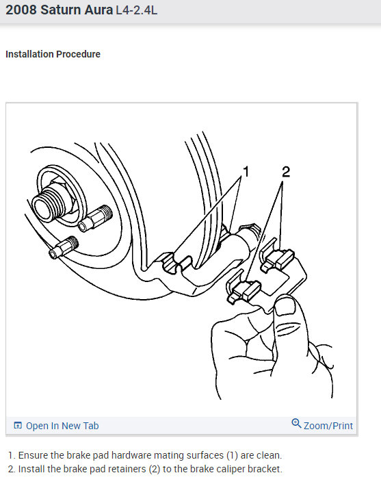

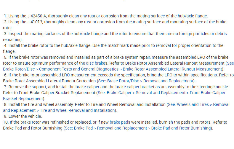

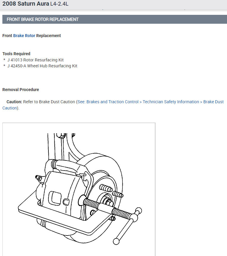

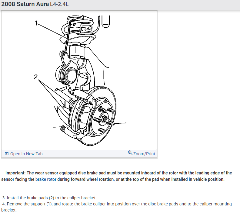

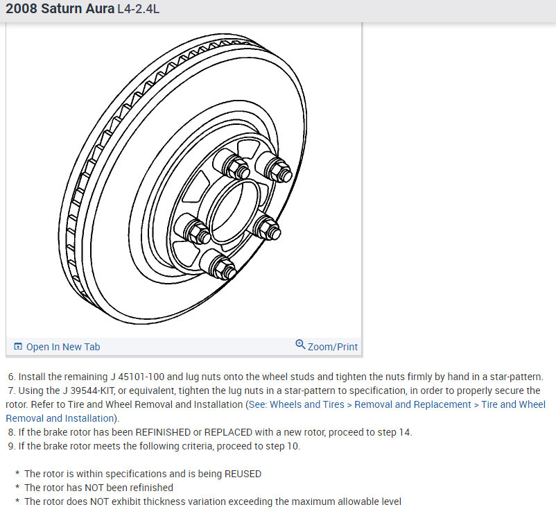

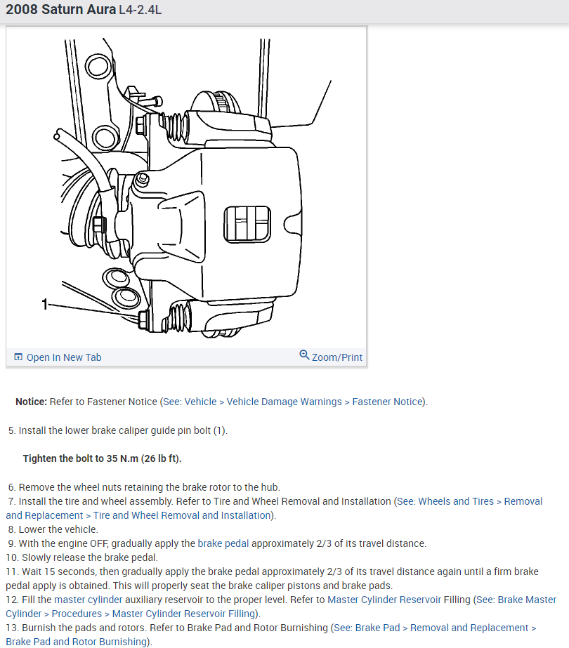

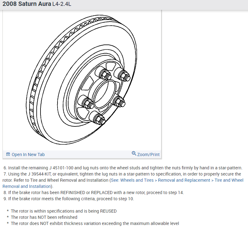

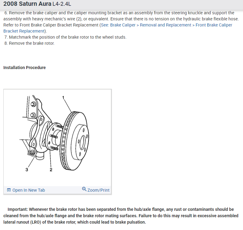

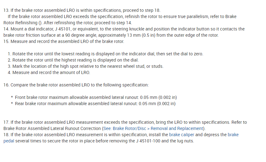

Check the runout of the rotors. This will tell you if they are wrapped. I have attached procedure for the runout test.

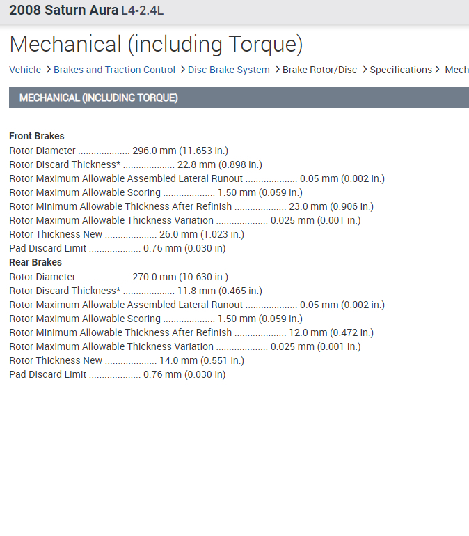

Also you need to check the thickness of the rotors as well.
Rotor Discard Thickness is 22.8 mm (0.898 in.) for the front.
See below for all the specifications.
