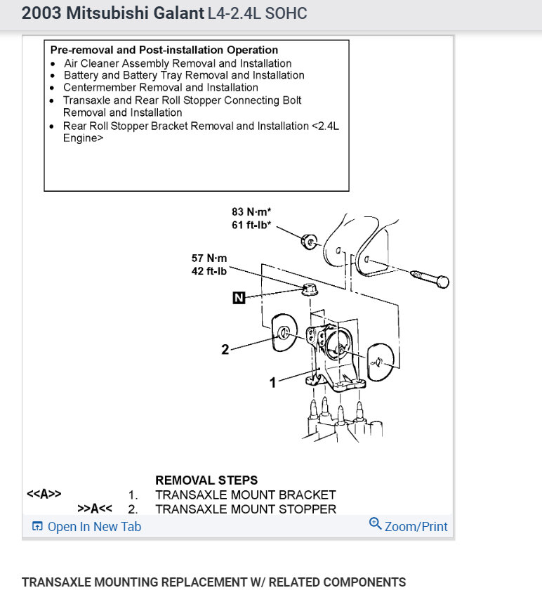

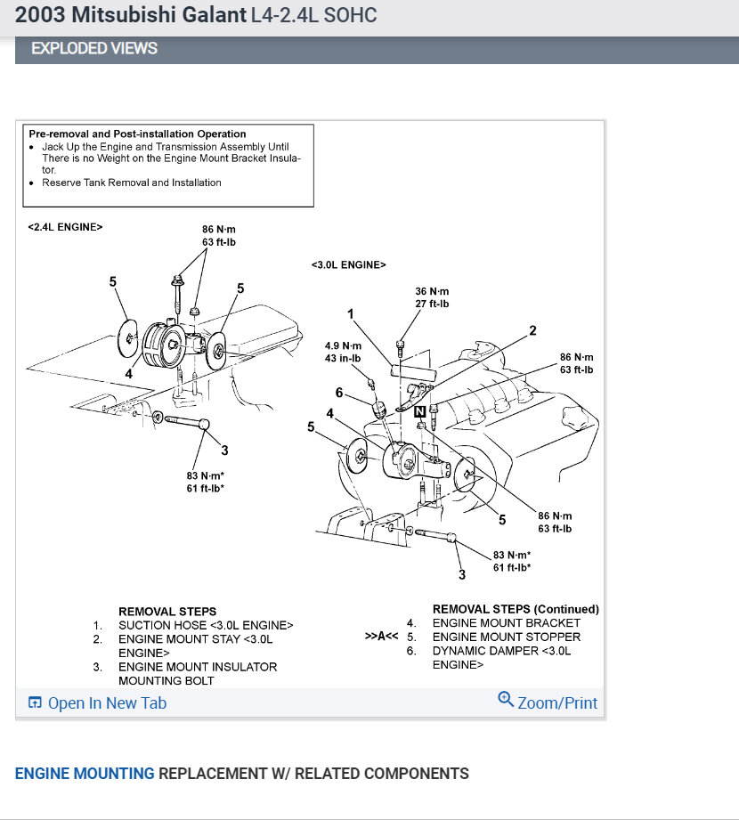

The car ran fairly smoothly before. Two of the motor mounts were worn out so I decided to replace all four. After everything was put back together, I started the car, and it had a slight vibration in park, but an insane vibration felt through steering wheel and dashboard and door when in drive with foot on brake. Does it in reverse also with foot on brake but not as bad.
Car seems to sound louder as well.
