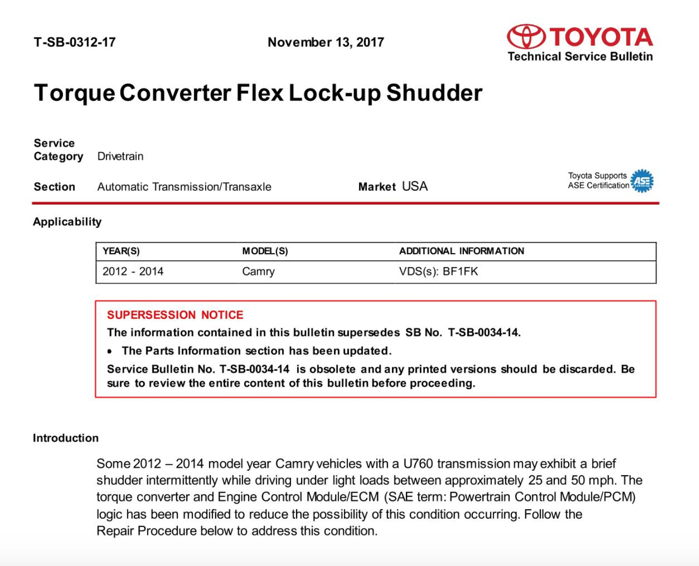

I have found a TSB (technical service bulletin) which may be applicable.
I have attached the first description, it is only applicable to certain vehicle VIN's
Toyota TSB 0312-17
It looks like you may be out of power-train warranty but i would still say it would be worth contacting a Toyota dealer to see if the TSB is applicable. If it is applicable you may be able to get Toyota to cover it as it is a known issue.
The repair includes replacing the torque converter and reprogramming the PCM.

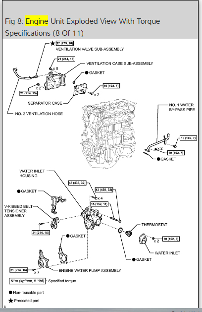

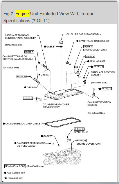

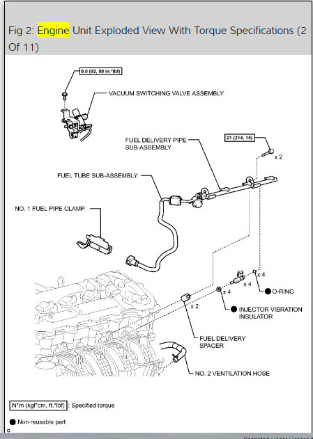

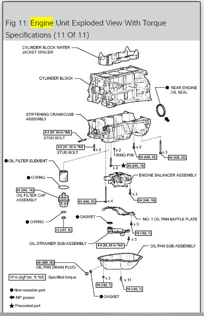

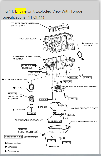

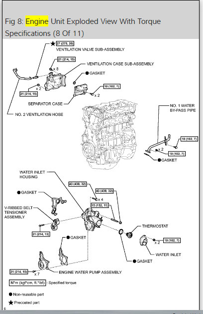

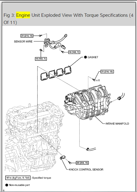

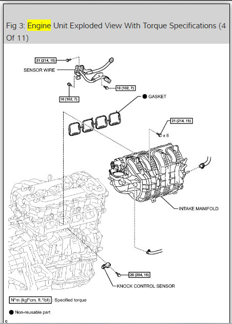

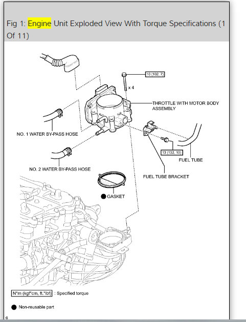

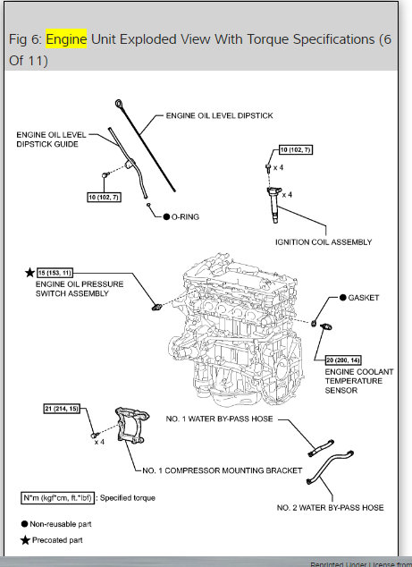

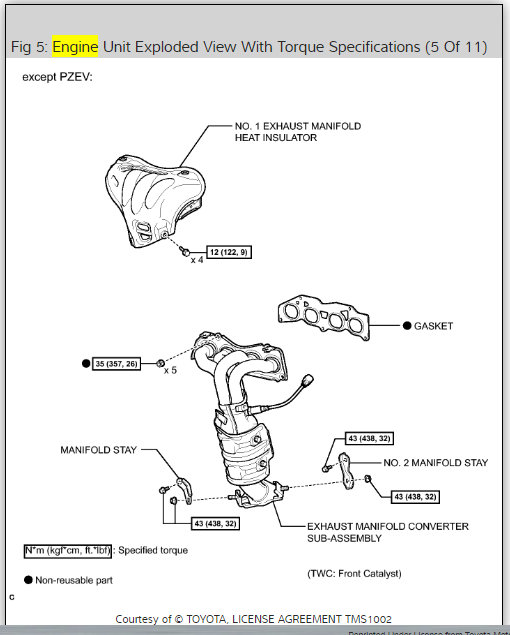

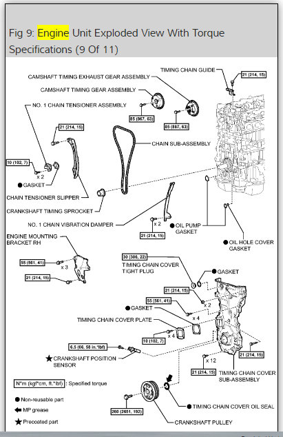

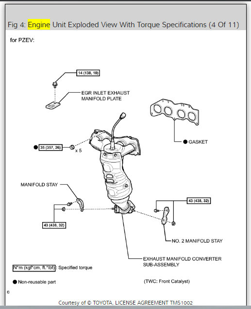

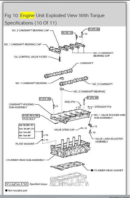

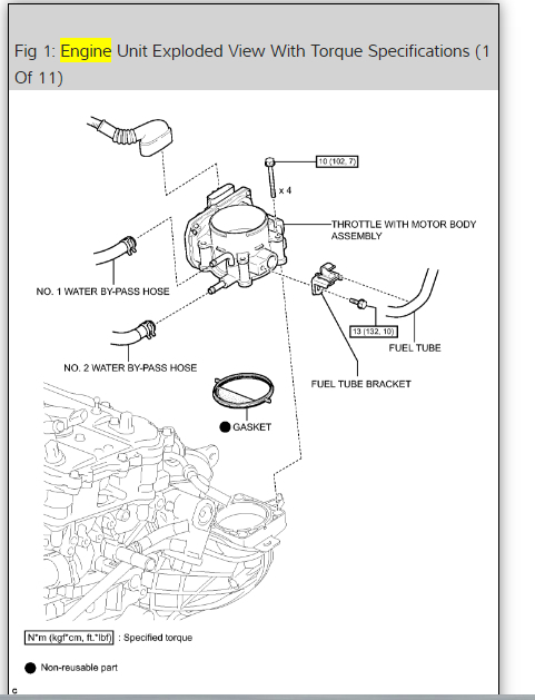

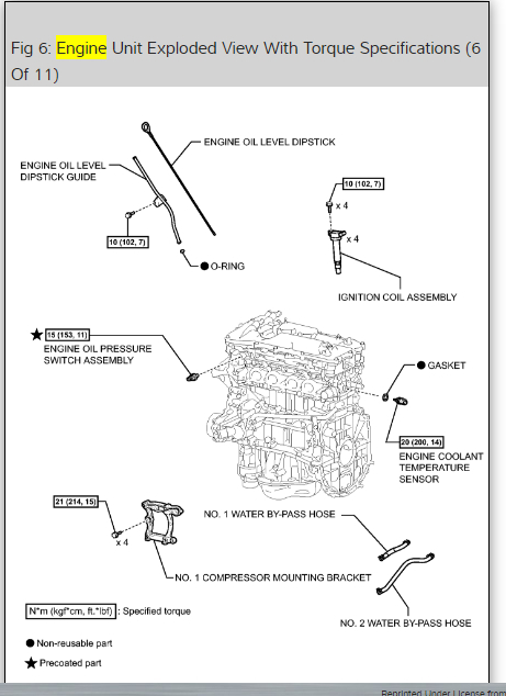

I have also included explosion engine diagrams of your vehicle's engine in the diagrams down below. Please go through this guides and get back to us with what you find out.
