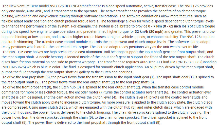

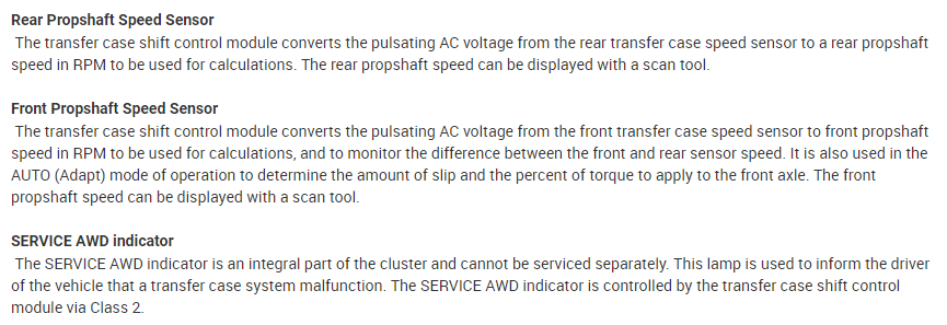

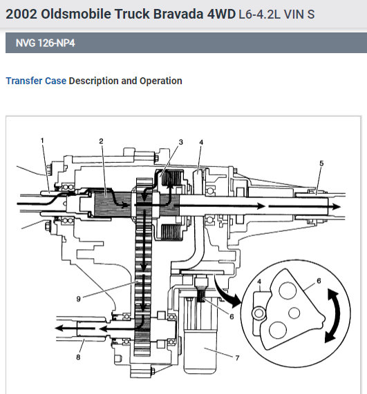

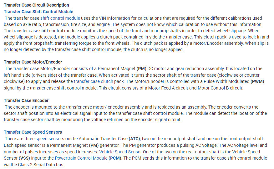

Usually when it comes to noises, squeaks, and rattles we ask to have you make a video with your cell phone and upload it here. This gives us a better idea since we can't listen to the vehicle in person. I've attached description pictures below of the transfer case operation you asked for. Hope this helps and thanks for using 2CarPros.
