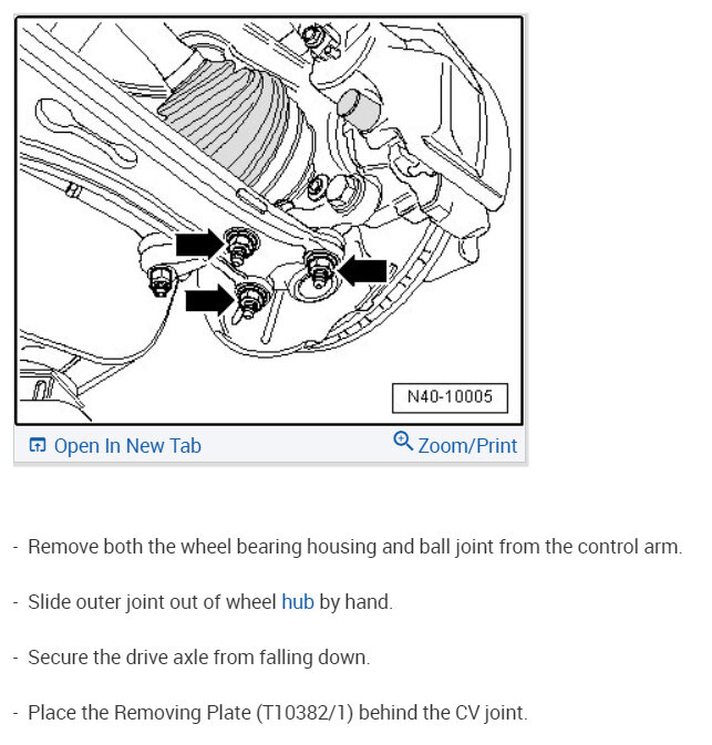

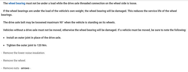

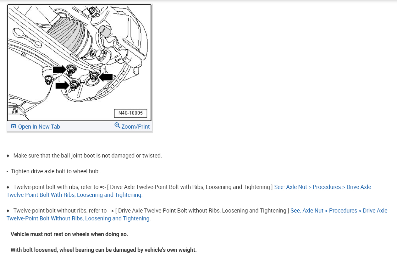

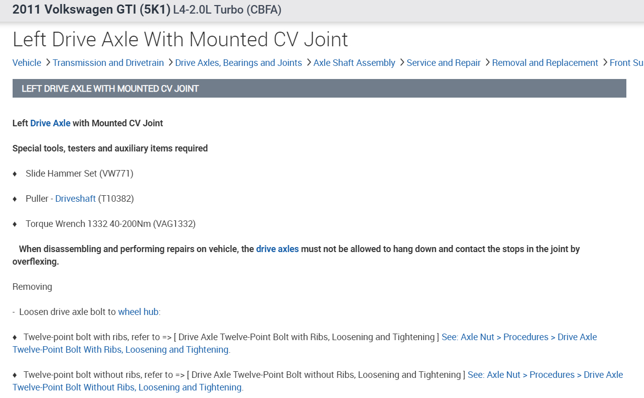

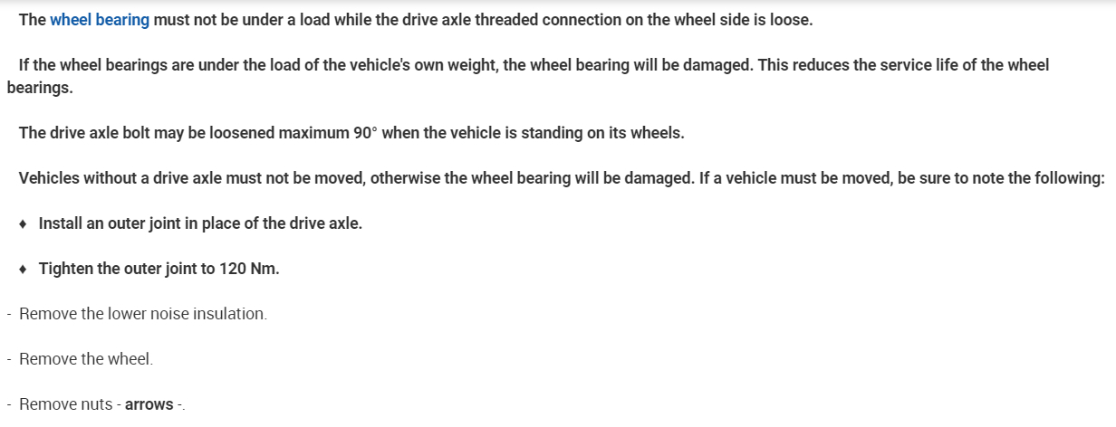

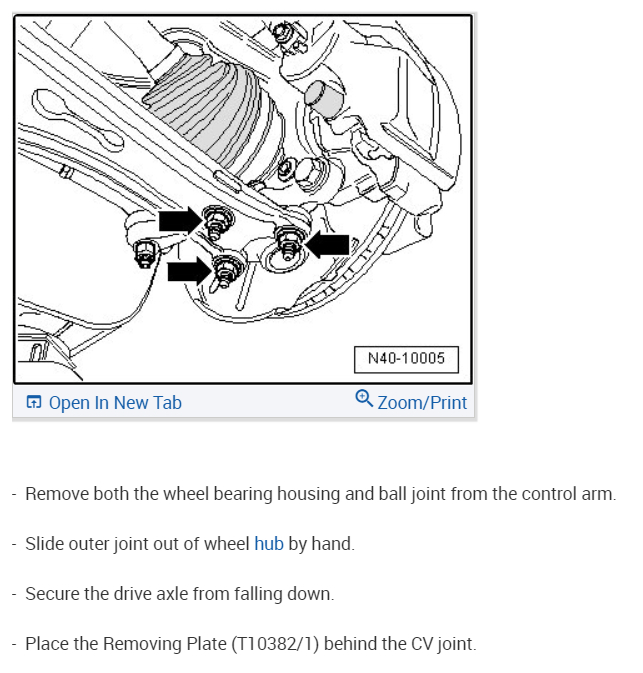

If you have not changed out the CV axles this could be the problem due to worn out CV joints. Please check out this guide and see why this could be the cause:
