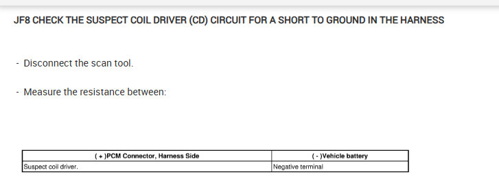

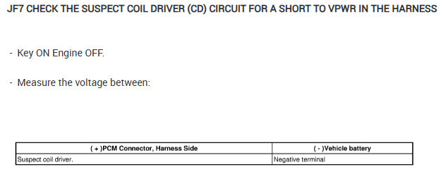

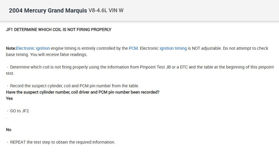

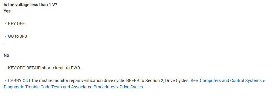

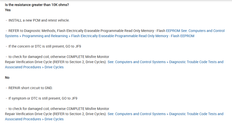

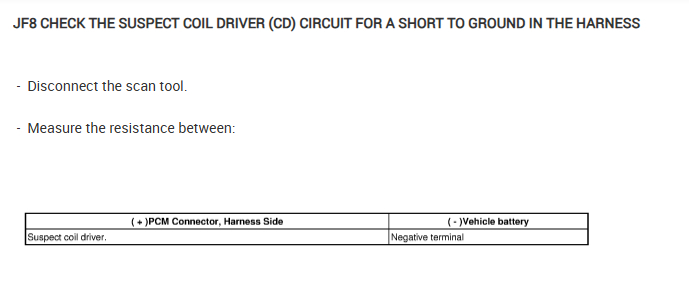

Car has the codes P0354, P0355, and code P0357. Before it had P1336 and P0128 as well as 0355 and p0357. The car had blown out coil pack #4. I re-tapped cylinder 4 and put in a new plug spark plug insert and coil pack, also i put in a new thermostat because of code P0128. Because of the codes i had a mobile mechanic confirm my first code read.
