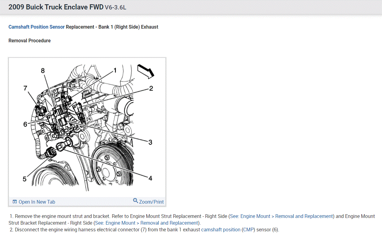

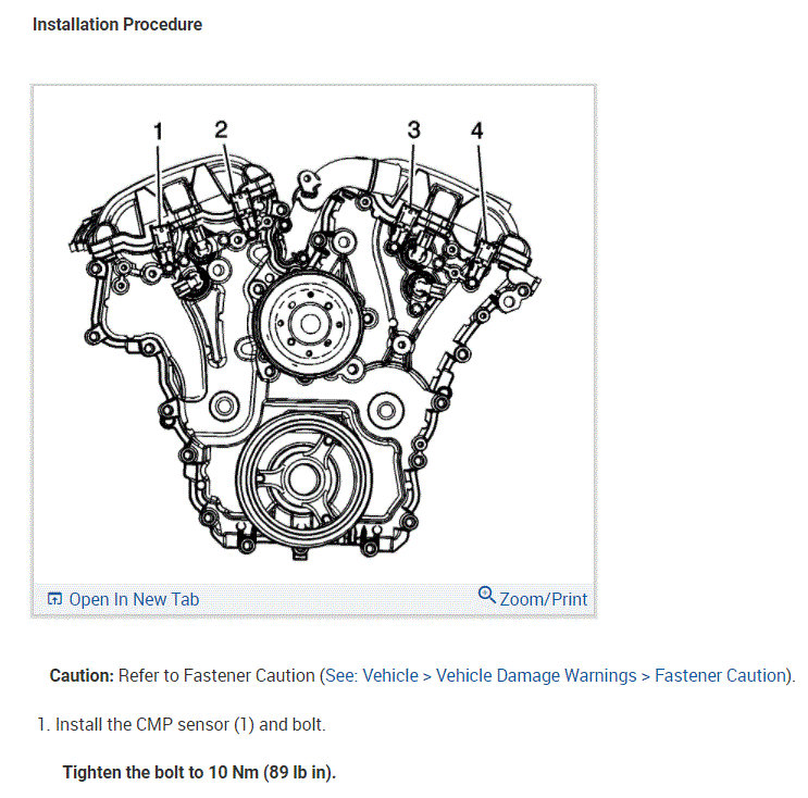

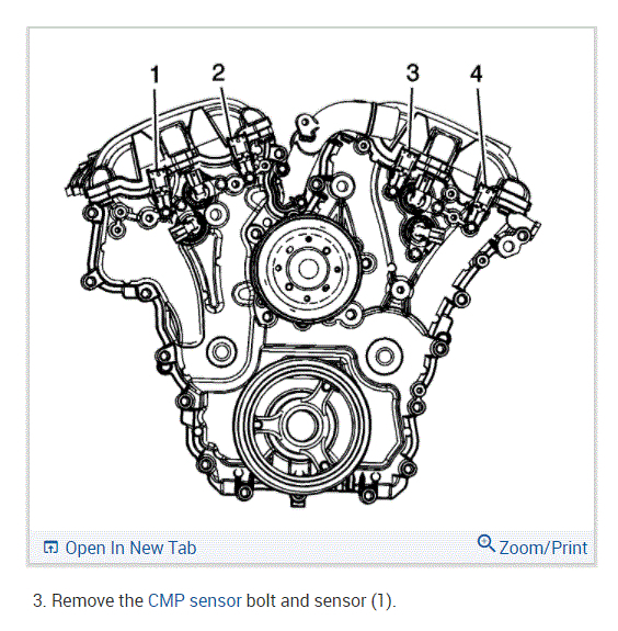

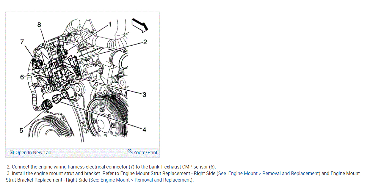

I am going there after work today and see if they can tell me which camshaft position sensor it is and plan on starting there.
