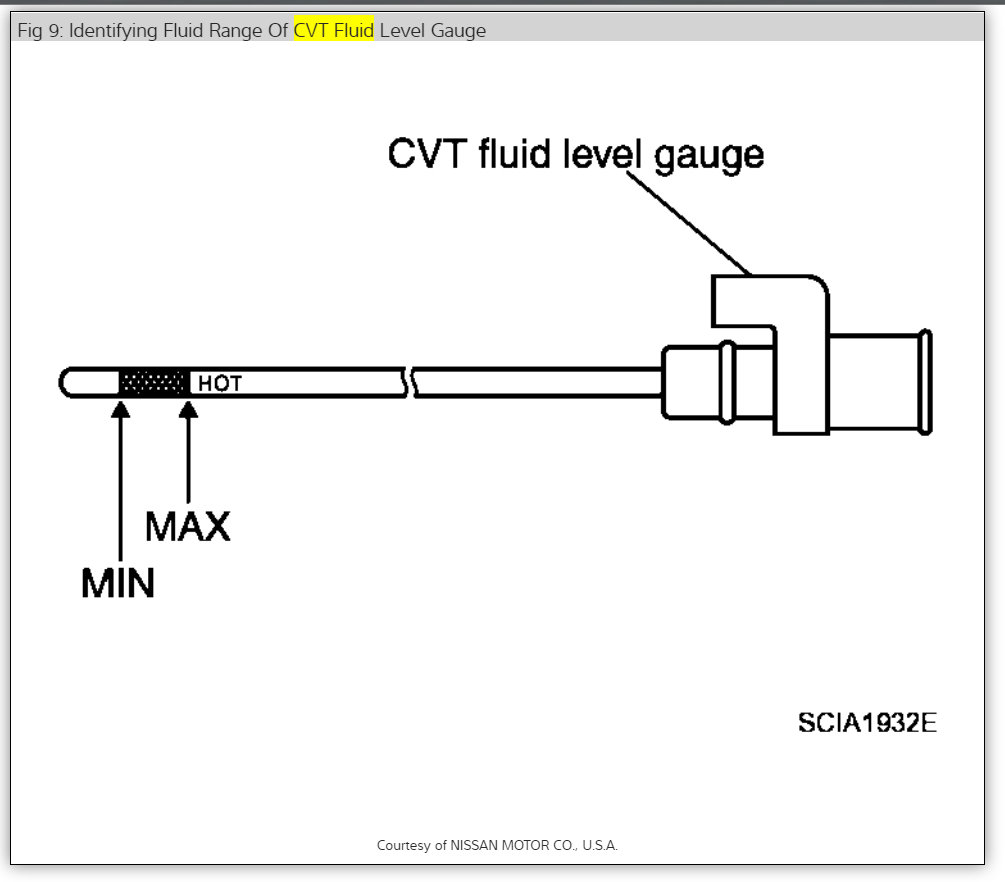

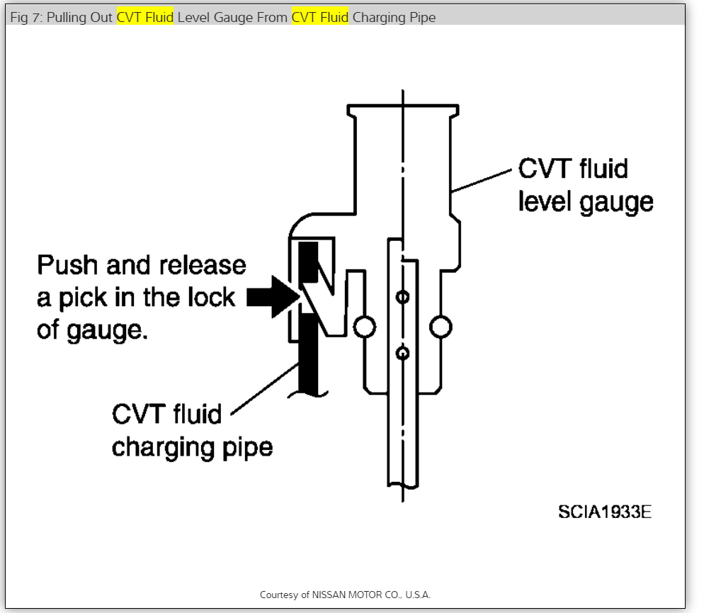

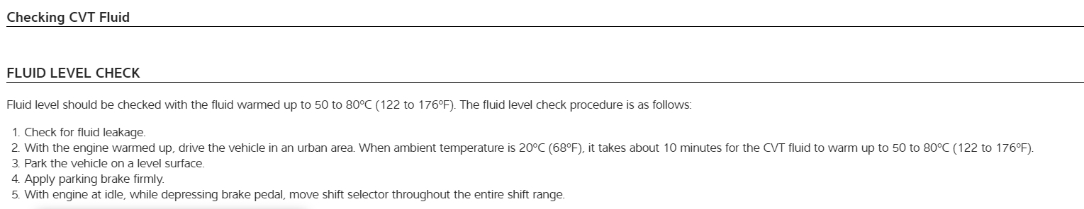

It sounds like the transmission is low on fluid which will make it slip.
Here is a guide that will help you see how what you are in for when checking it:
This car has a CVT transmission which have problems (FYI).
Below are diagrams on how to check it in your car.
