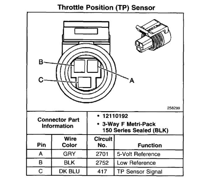

I check the TPS connector with the connector unplugged with a DMM and got to read about 1.6V on the signal leg (dark blue B con. #66)
I thought I should be reading close to 0 volts.
5 volts is present on the reference leg (grey wire B con. #33)
No volts at ground leg.

I attached the connector diagram for the TPS. Check or back probe the low reference wire with the key on and closed throttle.

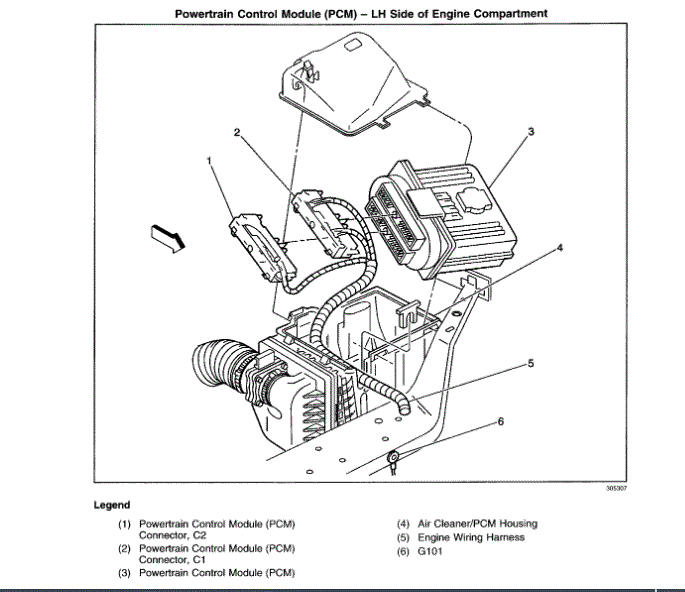

I suspect the ECM is the issue

I still think we are heading to an ECM.

The ECM needs to be checked by someone with the special equipment needed.

Thank you, I will look for someone to check the ECM.
