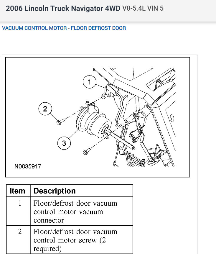

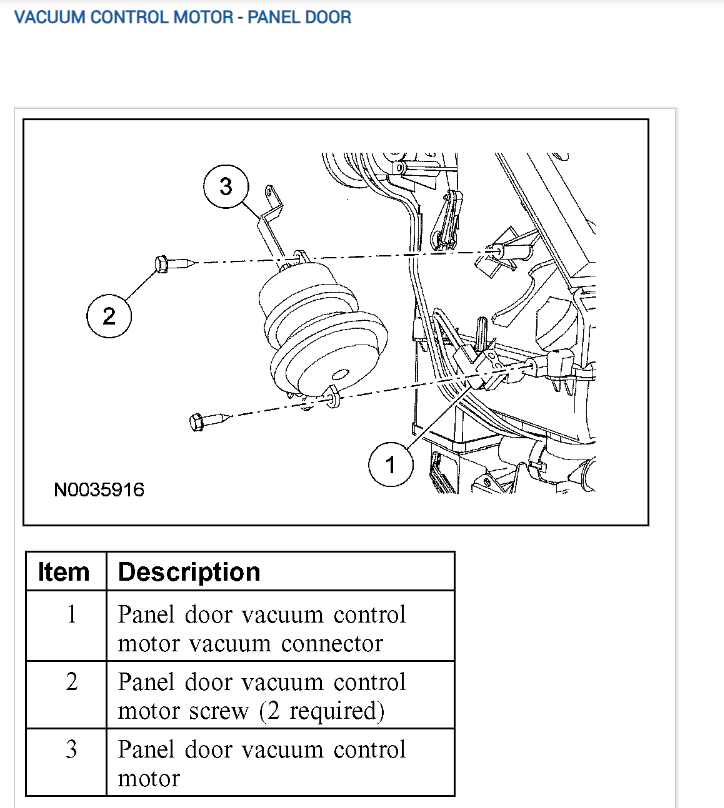

I have another question. The vent control module obviously isn't working. Air comes out from the defrost, the dash vents and the floor. I have the new control module. But I have been unable to find any information on it. Where it is located or how to access it. Can you provide that information?
Sep 16, 2024 at 3:09 PM

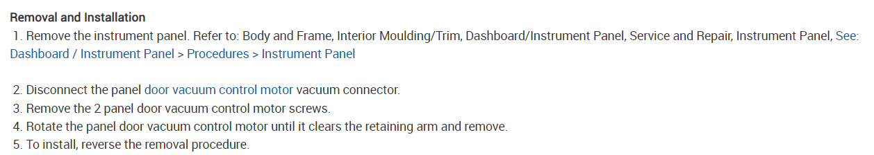

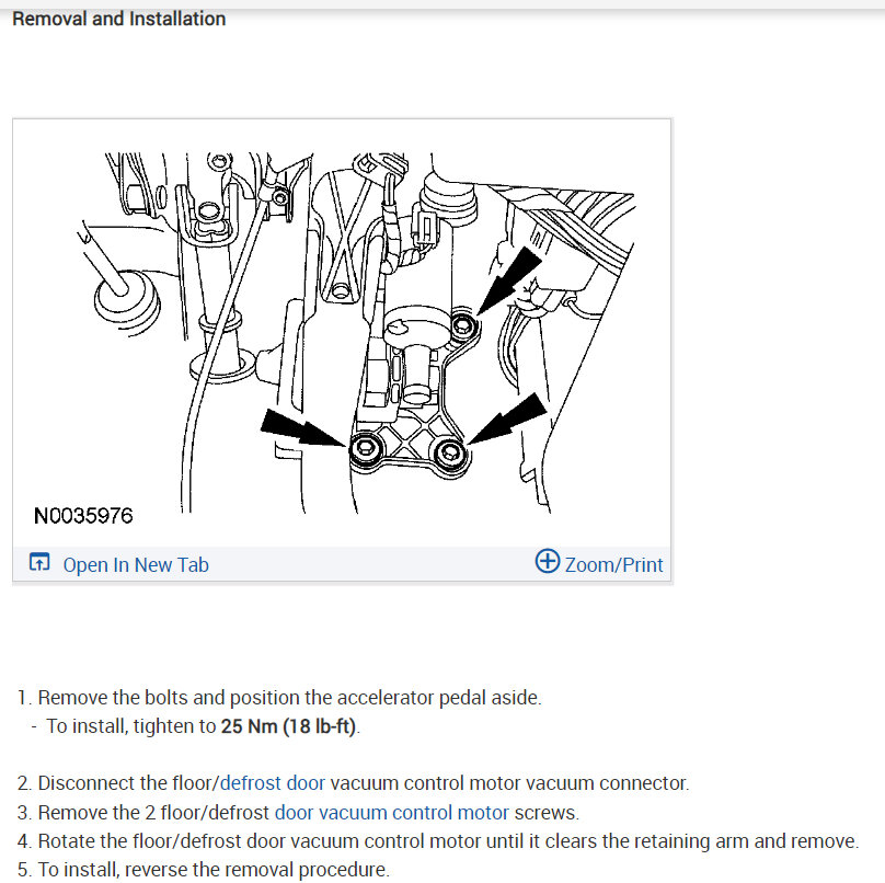

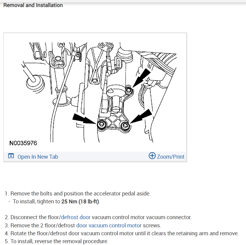

So, these are a vacuum controlled vent system and what happens is the HVAC system loses vacuum because the small vacuum line under the hood falls apart. Here is a guide to help you fix it and I have included information on the location of the blend door actuators.
https://www.2carpros.com/articles/air-vents-stay-in-the-defrost-position
Check out the images (below). Please upload pictures or videos in your response of any problems so we can see what to help you with.
