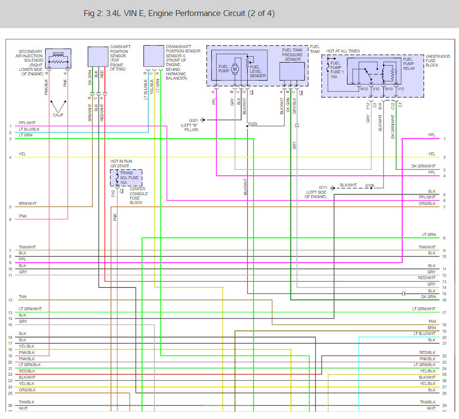

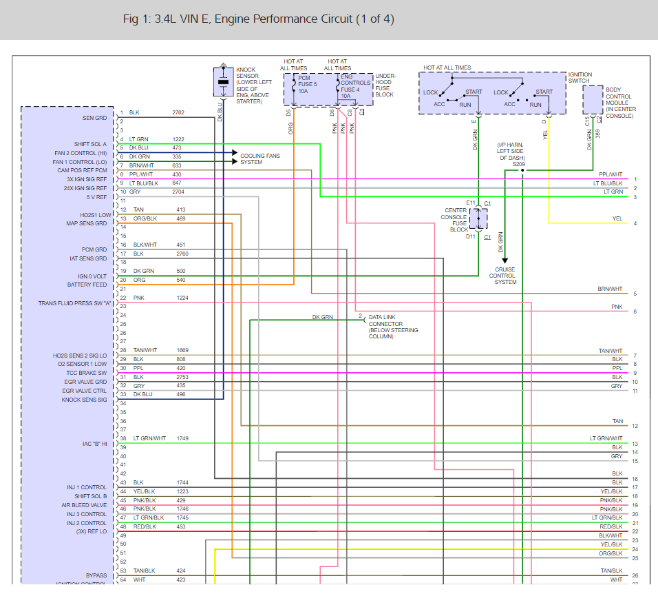

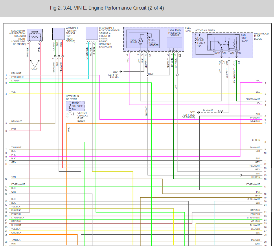

It sounds like you did the fuse and not the relay? If you did the relay then it sounds like you have a bad connection at the fuel pump. Here is a guide that will show you how to test for power at the fuel pump:
If it is not getting power in other words the relay is not coming on then I would check the wiring, here is a guide for that:

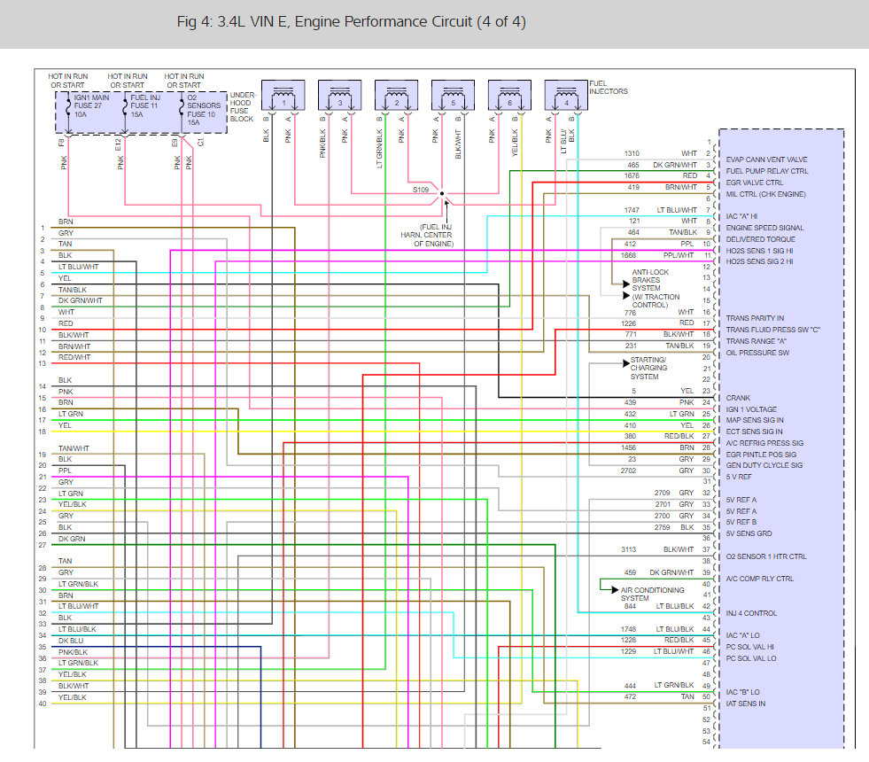

I would unplug all fuel injectors and then check for pulse. I am thinking a shorted injector can "lock up" the injector driver in the PCM.
https://www.2carpros.com/articles/how-to-test-a-fuel-injector

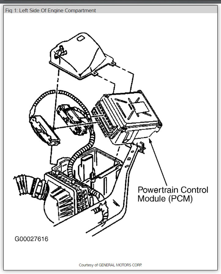

Last I would say the computer is having a problem if everything else checks out. Its location is below.
Please let us know what you find.
