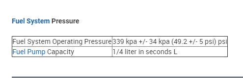

Once I know the model and engine size, I can get you the manufacturer's specs as far as fuel pressure, specifics for testing pressure, and so on. I have a feeling it is the pump, but want to be sure of the vehicle type before I continue and give you inaccurate information.
