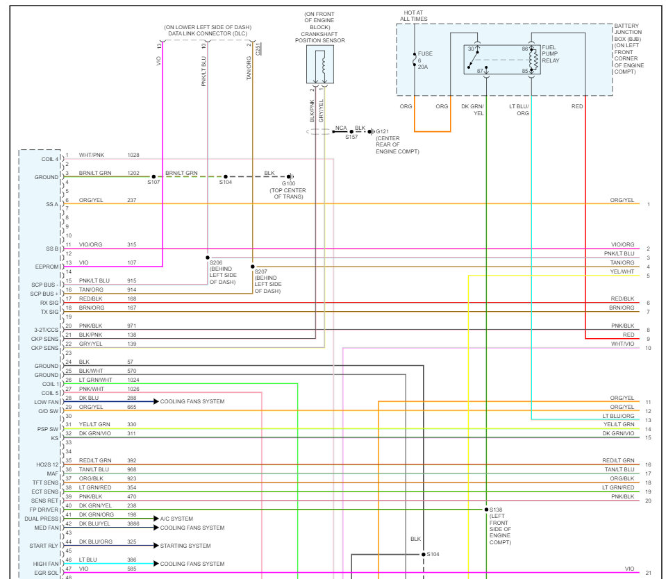

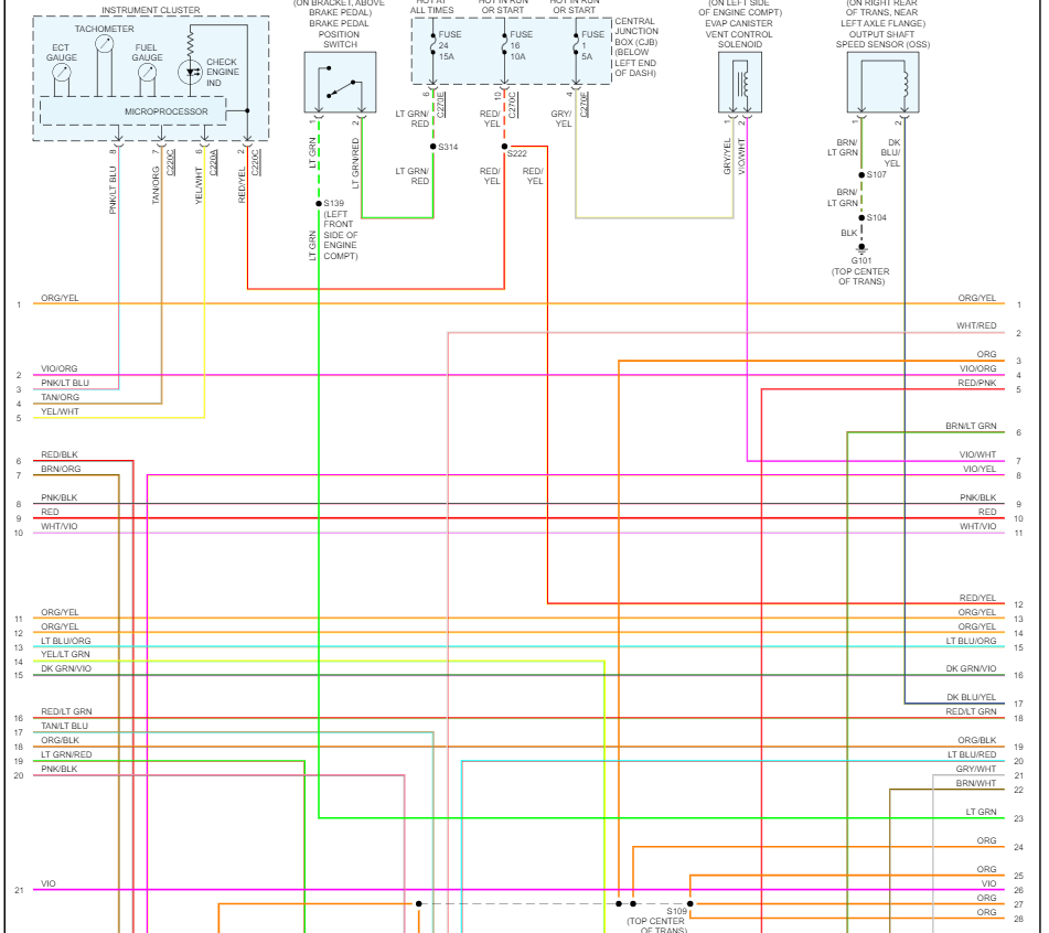

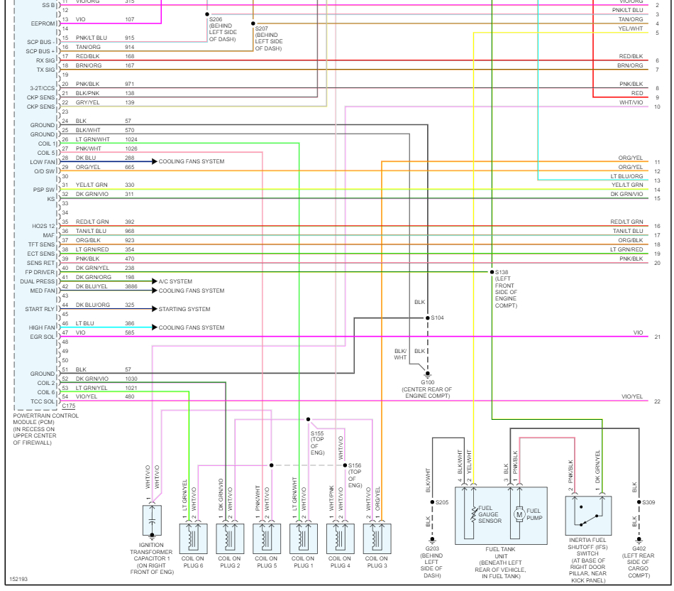

Let's check the voltage at fuse #6 which powers the pump. Please do the test with the key on. this guide can help, and I have included the fuel pump wiring diagrams so you can see how the system works:
