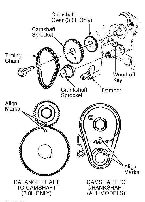

unfortunately you didn't go into great detail with your first question. However if you have less than 100 psi per cylinder then I'd think that the timing chain either broke or jumped time. this could happen if you got it running then revved it and due ot age and not knowing condition of chain/tensioner etc cause that. the low compression leads me to believe that because that is what happens when a chain jumps time. I imagine if you kept turning it over it would finally start because it would jump again close enough to start. It would run like crap however. If you test your compression on all the cylinders and they are in the 90-95 psi range then I'd really suspect timing chain. no compression should be less than 100 psi see pic

did a wet test on cylinder with 50 and it came up 25 points. The car ran perfect before I changed the intake gaskets. I agree, it looks like the timing has slipped. Vehicle has 85000 miles on it. Don't know what to do next. customer will never believe this. Did a bleed down test on yo PSI cylinder. Could hear air through the intake until I rotated the engine. Then there was air out the tail pipe. Rotated the engine some more. There was no From intake or exhaust which I believes tells me that the valve are OK. Very slight blow by from dip stick. Can't or don't want to believe the cam timing has jumped..What do you suggest? Tony

Tell the guy straight up like you say and see if he will be ok tearing down for timing chain if not then broom it . It's not your fault hell it says 85k but may be way more or maybe it sat for a very long time. I had a car one time came for a no start, started it and blew two rods right out the oil pan he had used so much ether to try to get the damn thing running.
