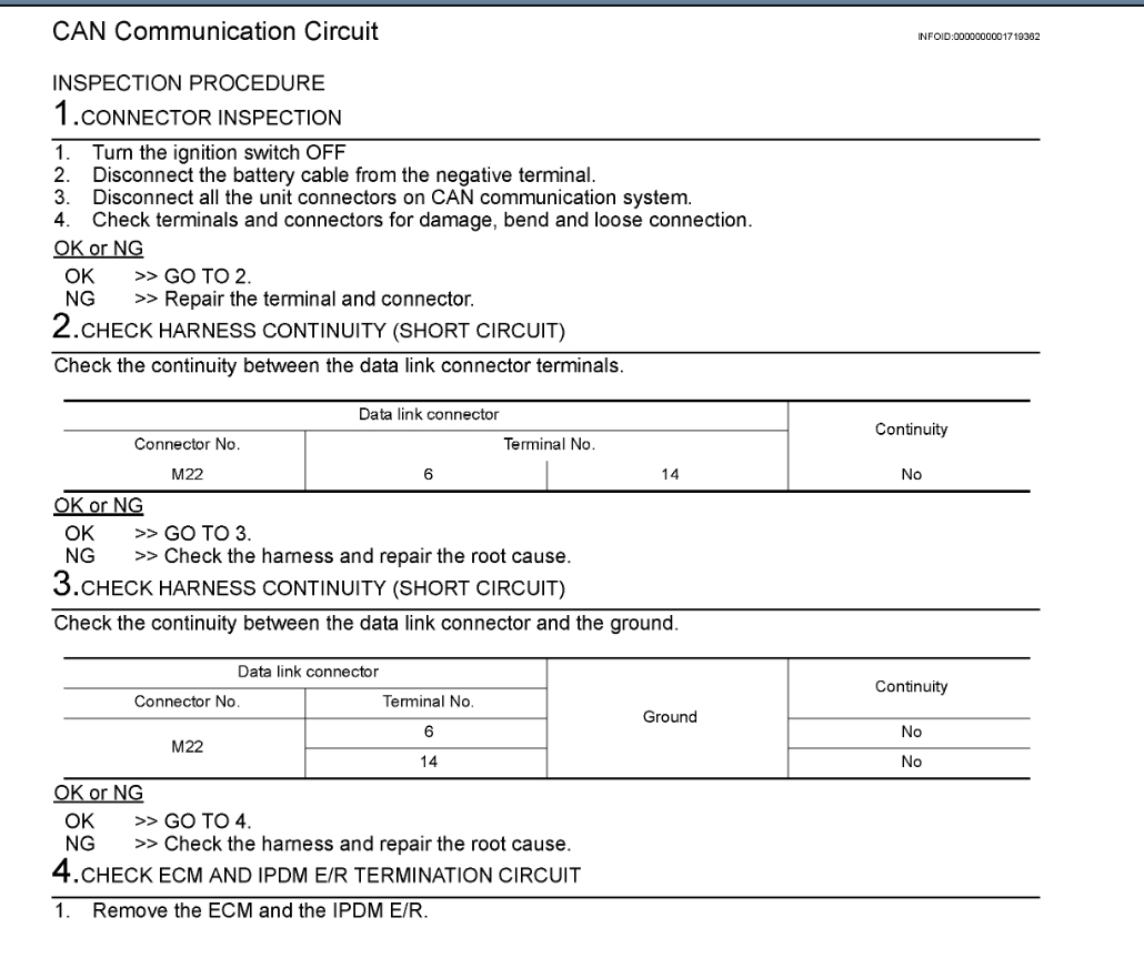

No communication between scan tool and computer.

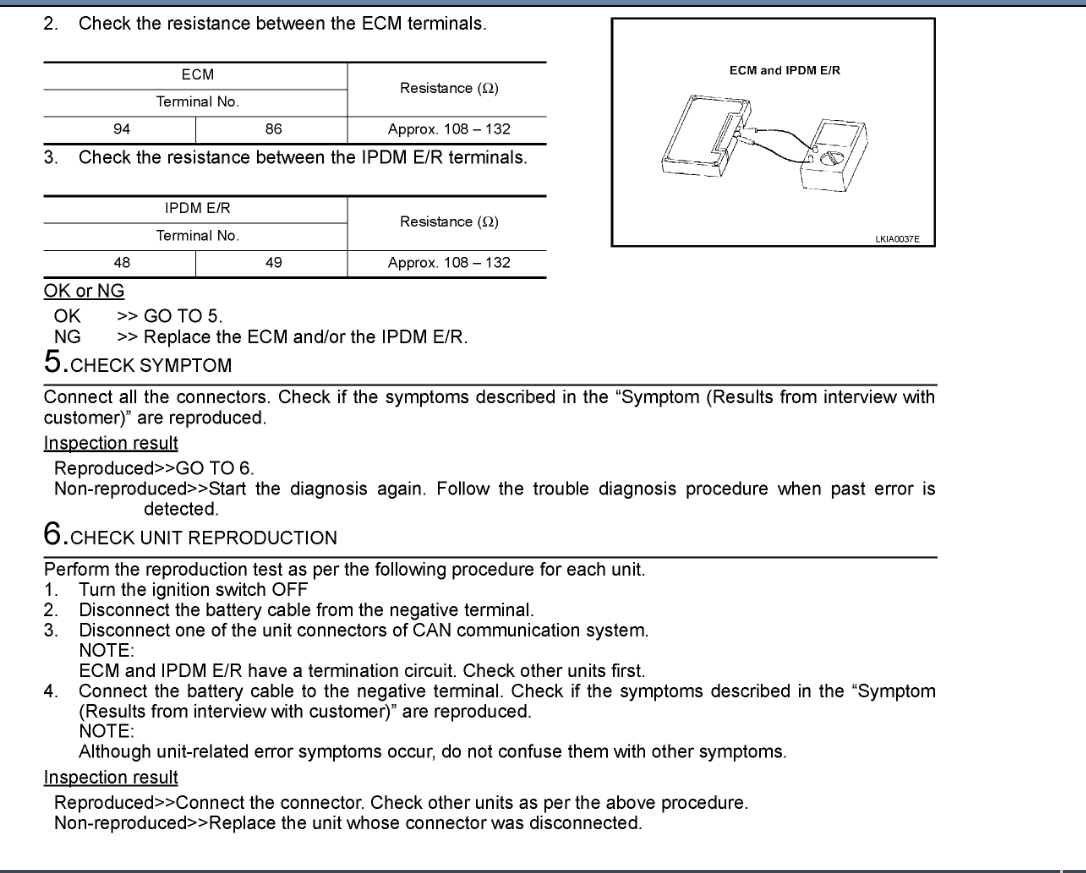

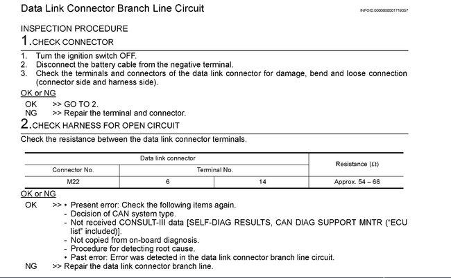

This sounds like your vehicle could have a problem with it's Controller Area Network (CAN). In the diagrams down below I have included the factory diagnostic troubleshooting guide for your vehicle's CAN system. Please go through this guide and get back to us with what you are able to find out.
Thanks,
Alex
