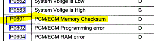

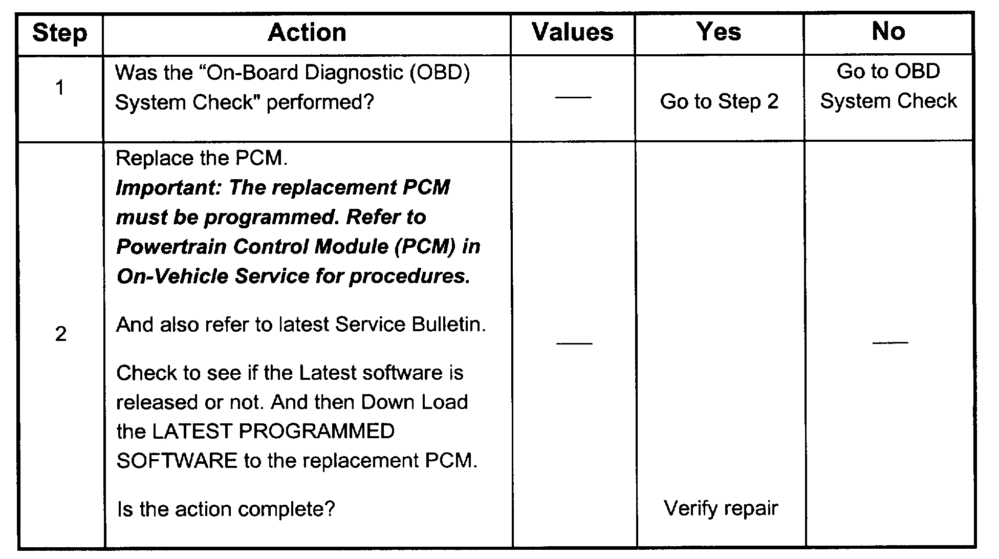

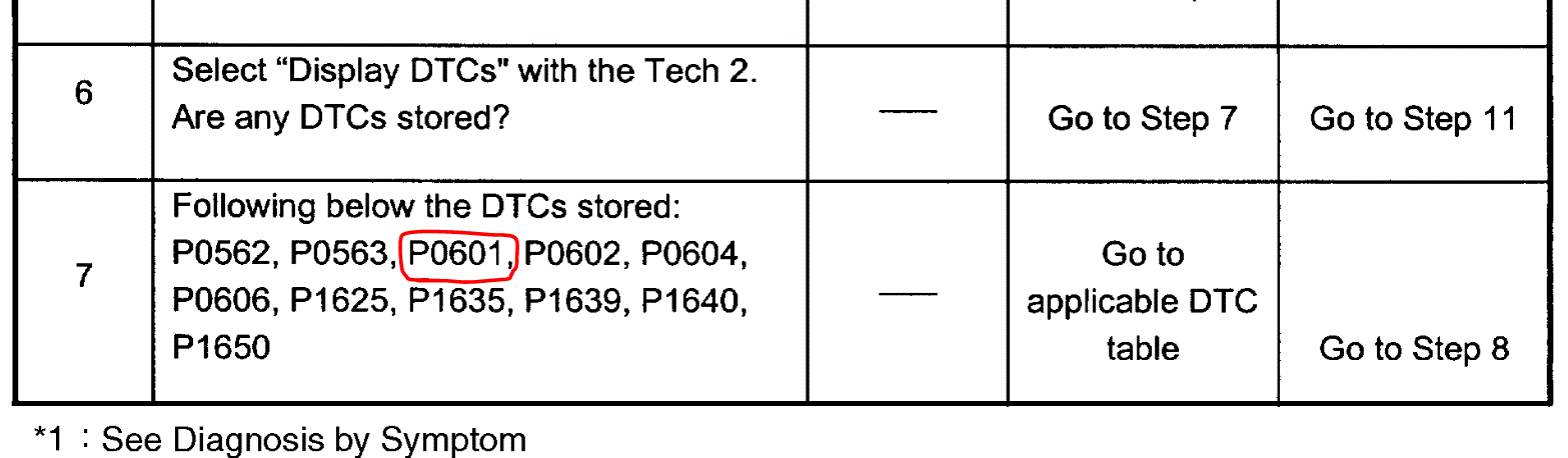

If you look at pic 1 below, it shows where to check next if a P0601 is present. When I go to that number in the DTC table, it indicates what you see in pic 2. I select 601 from that table and here is what I get. See the remaining pics.

Steps 1 - 2
see pic 3
DTC P0601 PCM Memory
see pic 4

That is why I am suspecting the PCM. I hope that makes sense. Could I be wrong? Absolutely. However, this is where it is pointing for me.
