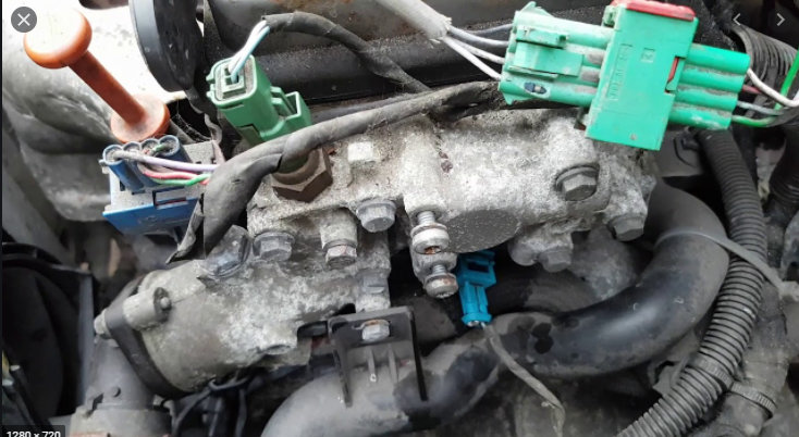

This sounds like the engine coolant temperature sensor is not working correctly. we should run the codes to see what comes up. On this car running codes might be tough because it is manufacturer specific. Here is how we do it in the states:
