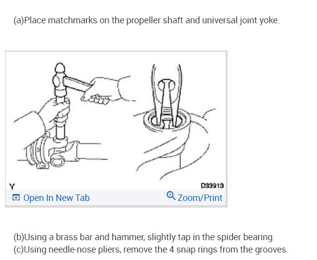

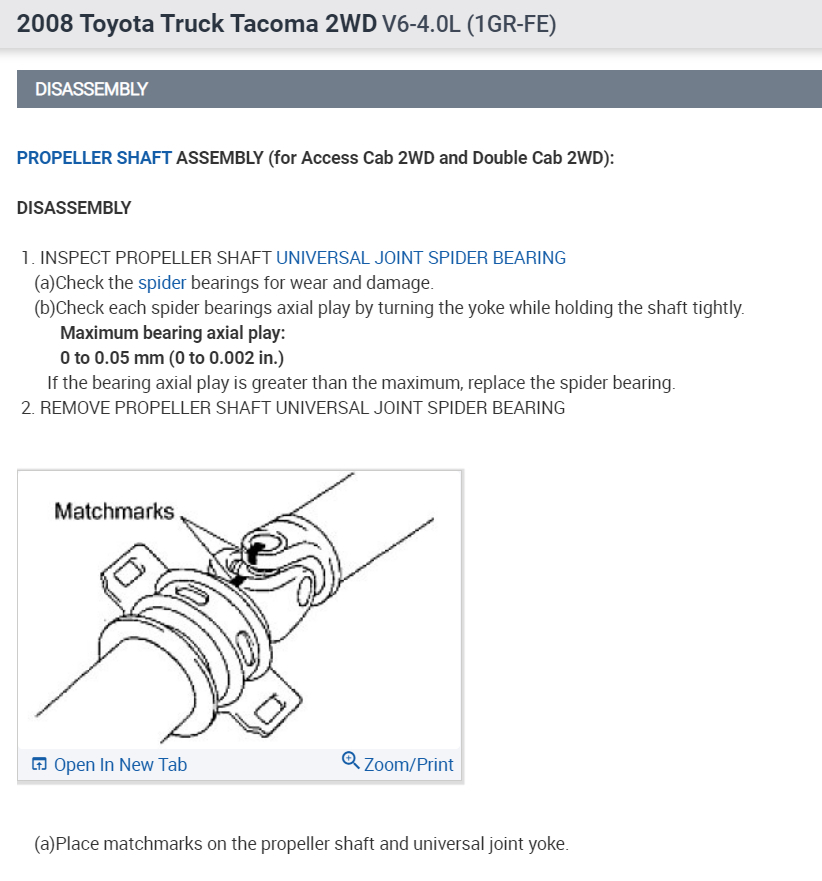

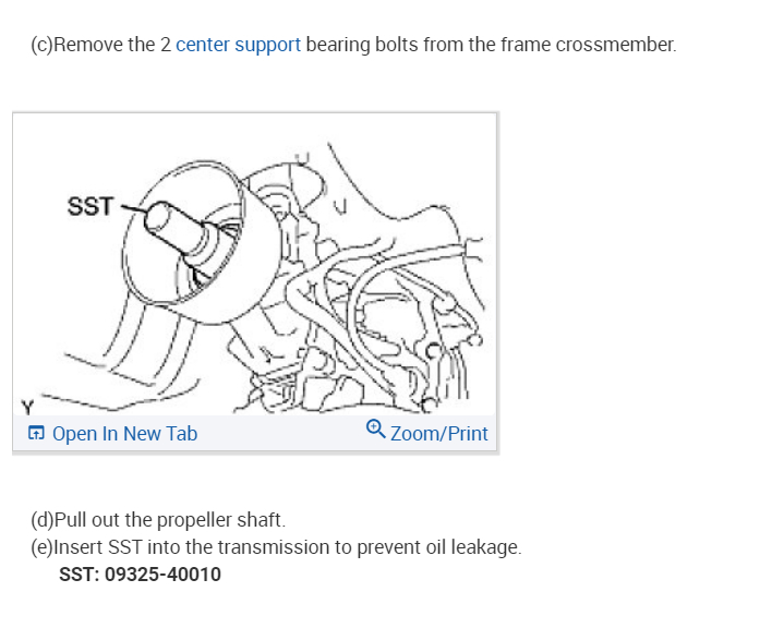

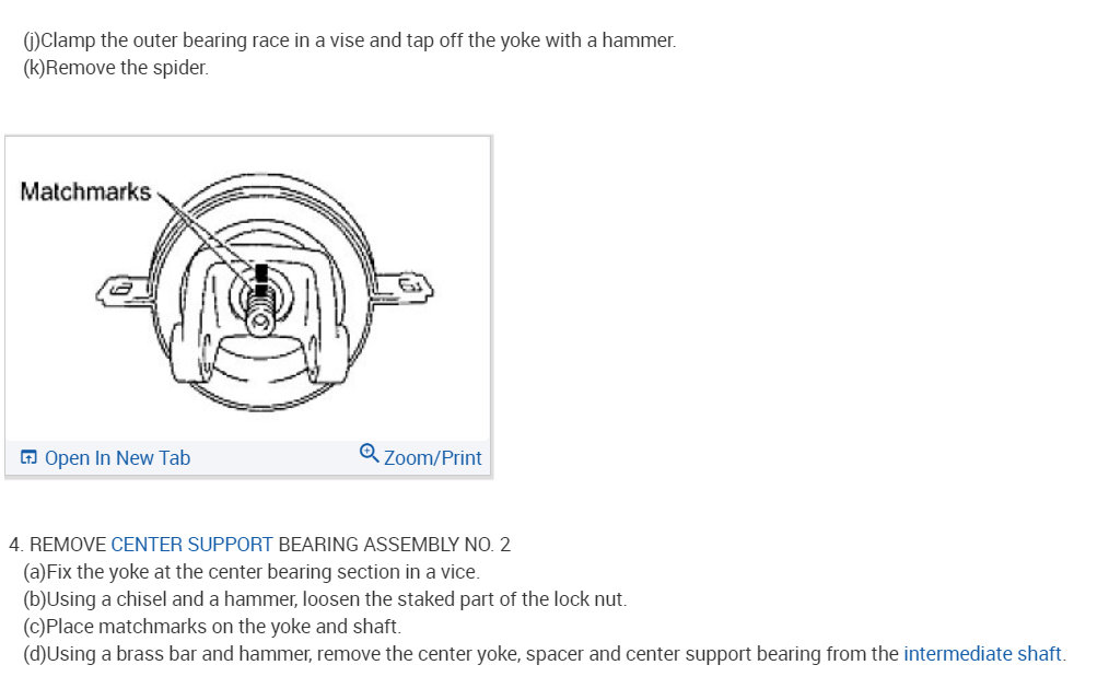

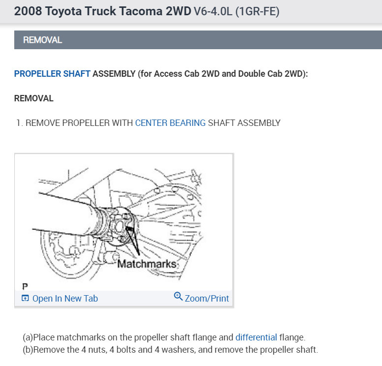

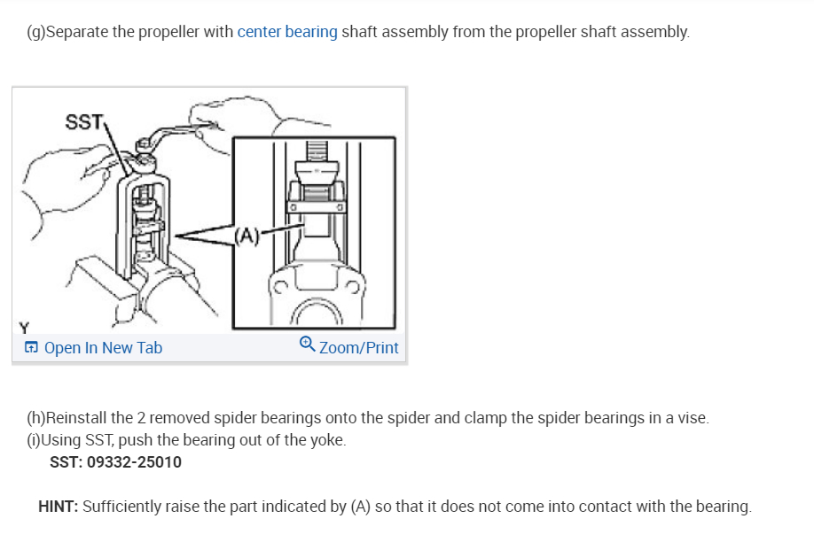

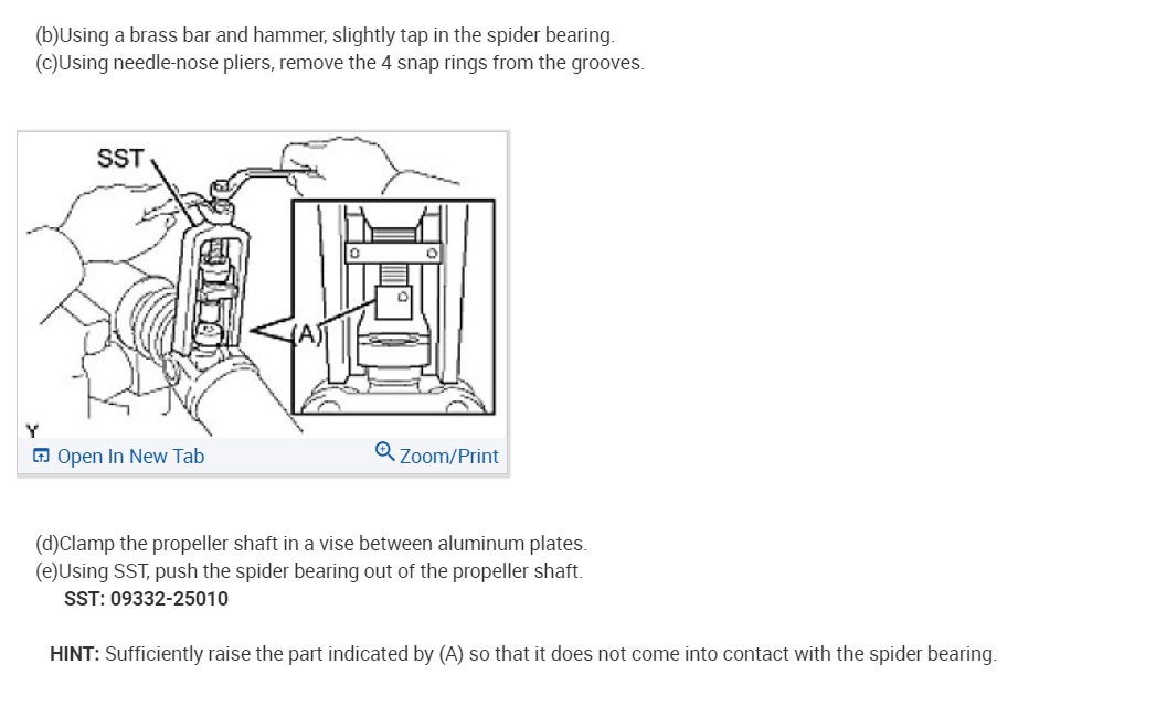

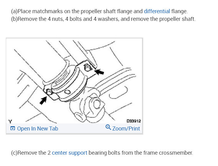

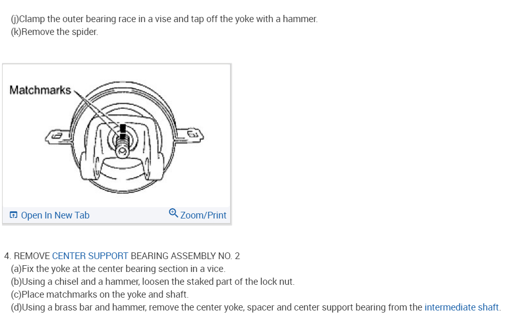

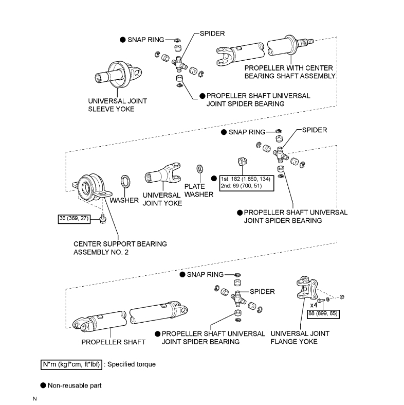

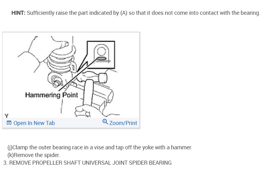

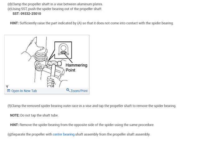

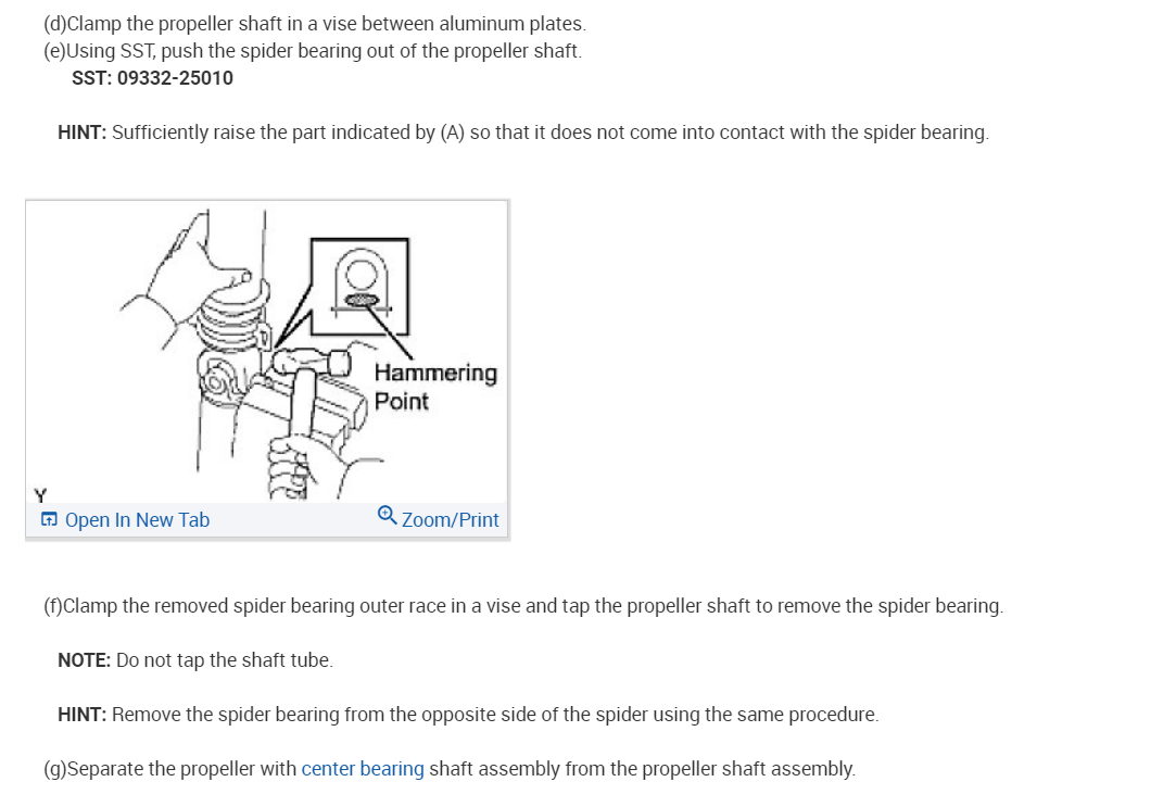

This is common when the center support bearing of the driveshaft goes out and needs to be replaced. here are diagrams below to show you how to remove the driveshaft so you can replace the bearing. Check out the diagrams (below). Let us know what happens and please upload pictures or videos of the problem.
