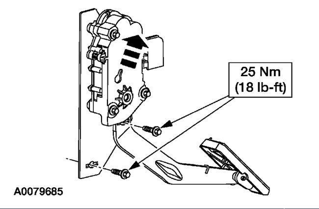

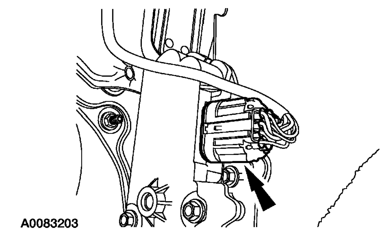

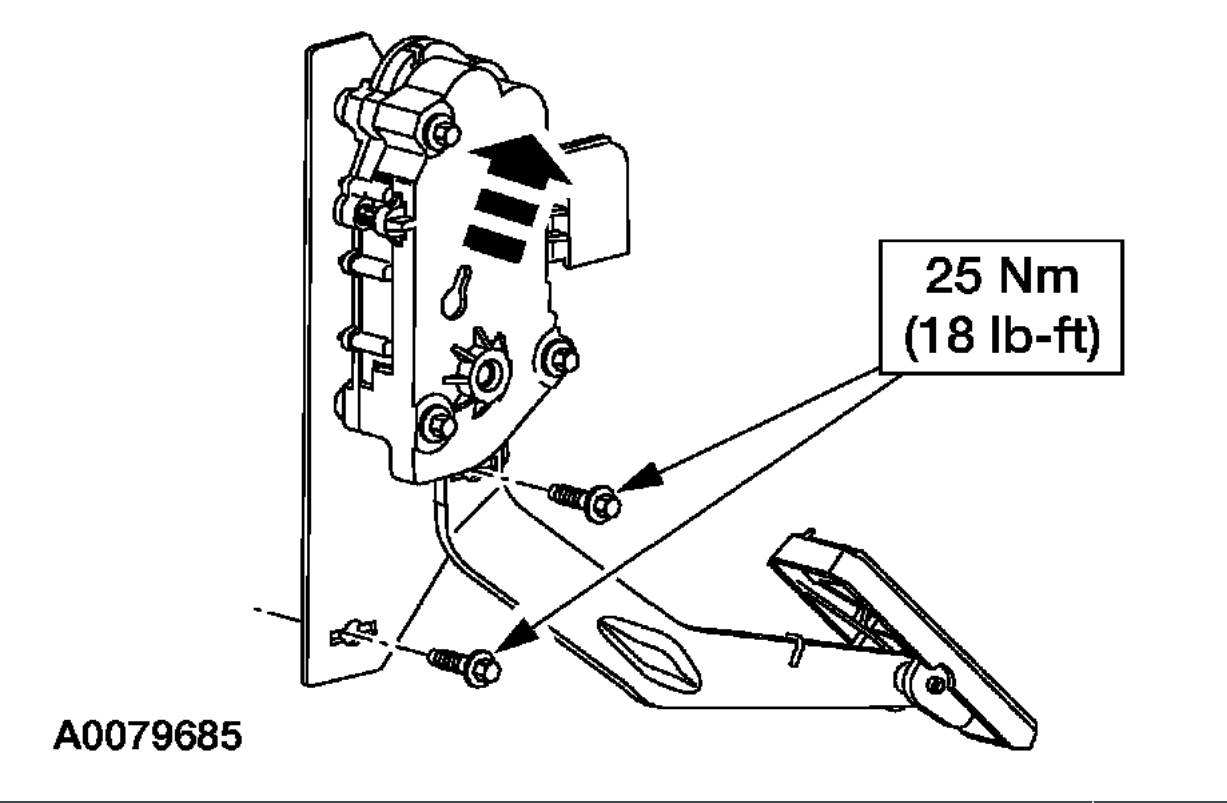

I attached the procedure for you of the replacement of the sensor.
It is a plug and play, no programming required.
ACCELERATOR PEDAL
Removal and Installation
CAUTION: The accelerator pedal and sensor assembly is a non-adjustable, calibrated unit and must be handled with care.
1. NOTE: The red clip must be pulled out before disconnecting the electrical connector.
Disconnect the accelerator pedal position sensor electrical connector.
2. Remove the two bolts and slide the accelerator pedal and sensor assembly up and off the anchor bolt.
3. To install, reverse the removal procedure.
