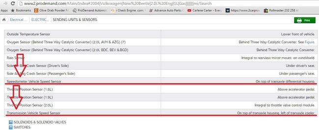

I'm trying to figure out where my vehicle speed sensor is located.

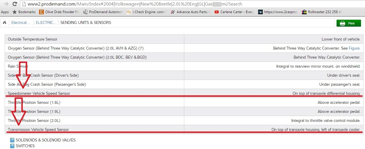

CJ MEDEVAC
  • 11,004 POSTS
CAN YOU SEE THIS?
SCREENSHOT FROM PRODEMAND
IF THIS AIN'T RIGHT, SEND YOUR VIN
HOPE THIS HELPS!
THE MEDIC
