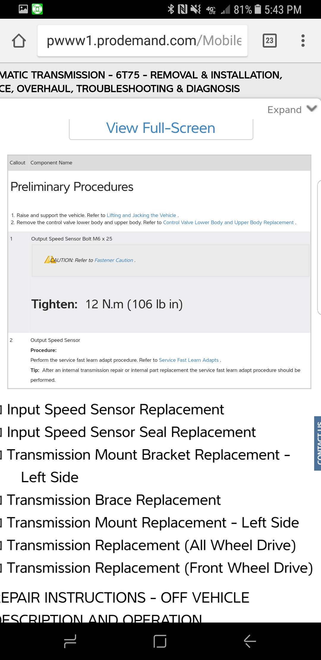

Looks like you have to remove the valve body so I would say it is a more difficult job. Plus you have to use a scan tool after replacing it and perform and fast adaptive relearn.

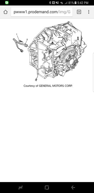

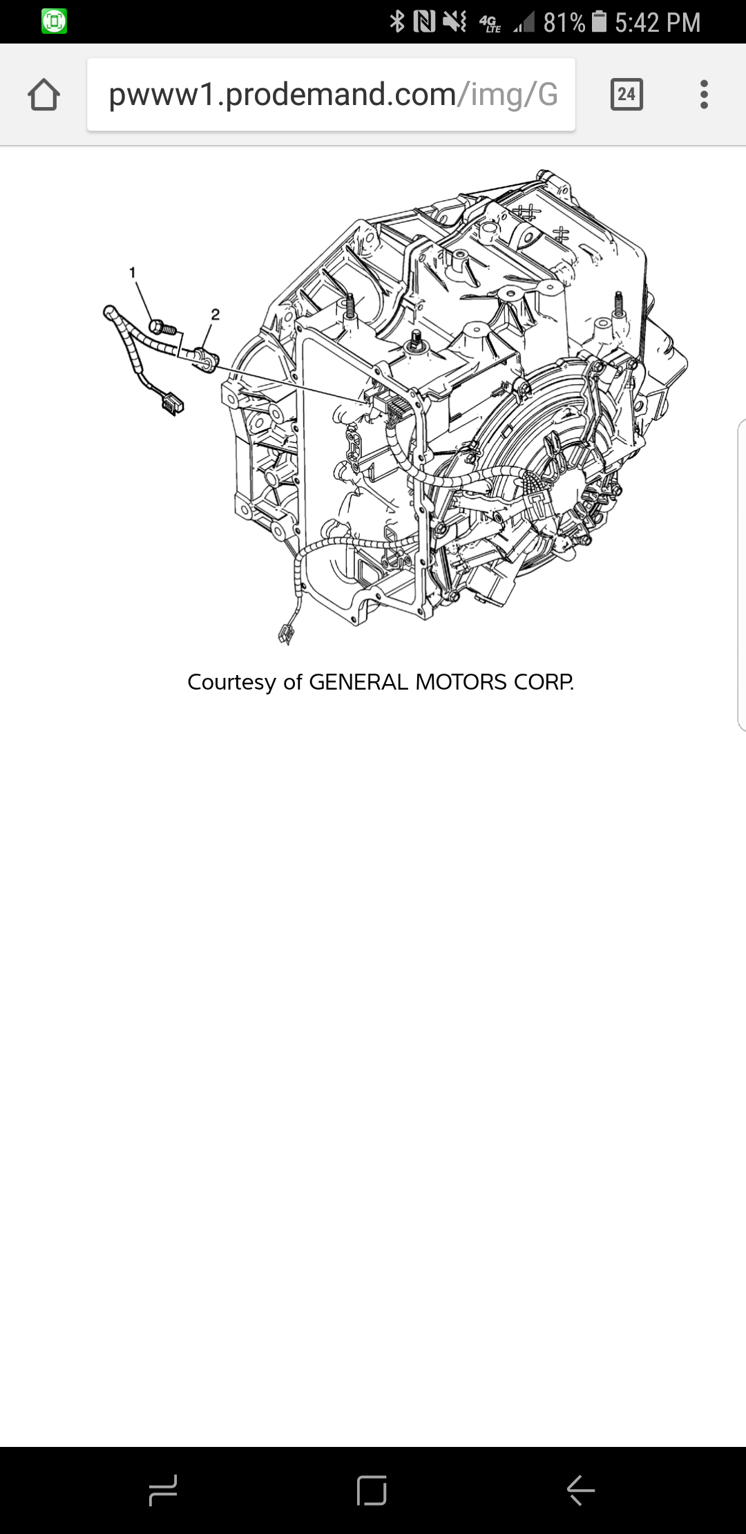

Here is some information on it.
