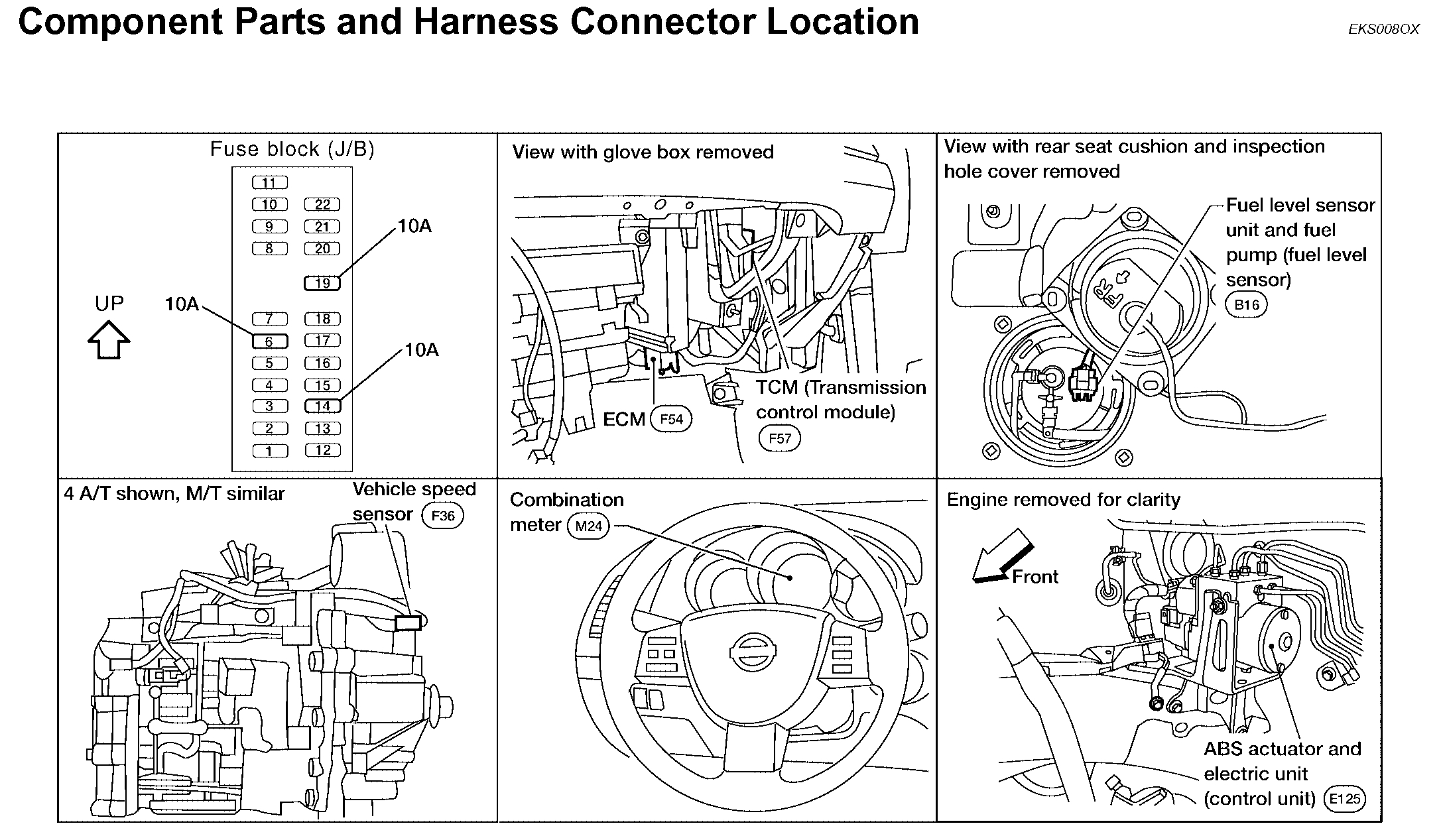

I need to know where the vehicle speed sensor is located. I am trying to change it and cannot locate it.
Sep 13, 2018 at 6:28 PM
CERTIFIED EXPERT
110,175 POSTS
I have attached a picture of its location. The image on the bottom left of the picture indicates its location.
Let me know if this helps.
