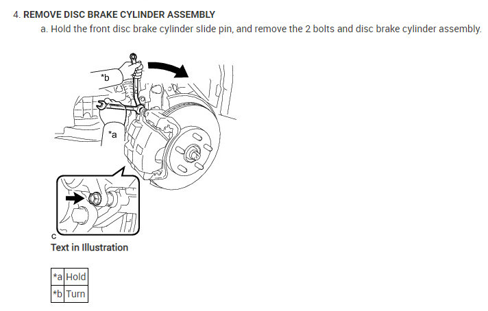

REMOVE DISC BRAKE CYLINDER ASSEMBLY
Hold the front disc brake cylinder slide pin, and remove the 2 bolts and disc brake cylinder assembly.
Pic 2

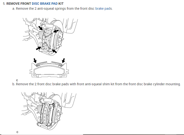

REMOVE FRONT DISC BRAKE PAD KIT
Remove the 2 anti-squeal springs from the front disc brake pads.
Pic 3
Remove the 2 front disc brake pads with front anti-squeal shim kit from the front disc brake cylinder mounting.
Pic 4

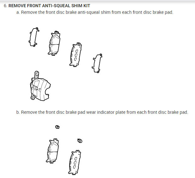

REMOVE FRONT ANTI-SQUEAL SHIM KIT
Remove the front disc brake anti-squeal shim from each front disc brake pad.
Pic 5
Remove the front disc brake pad wear indicator plate from each front disc brake pad.
Pic 6

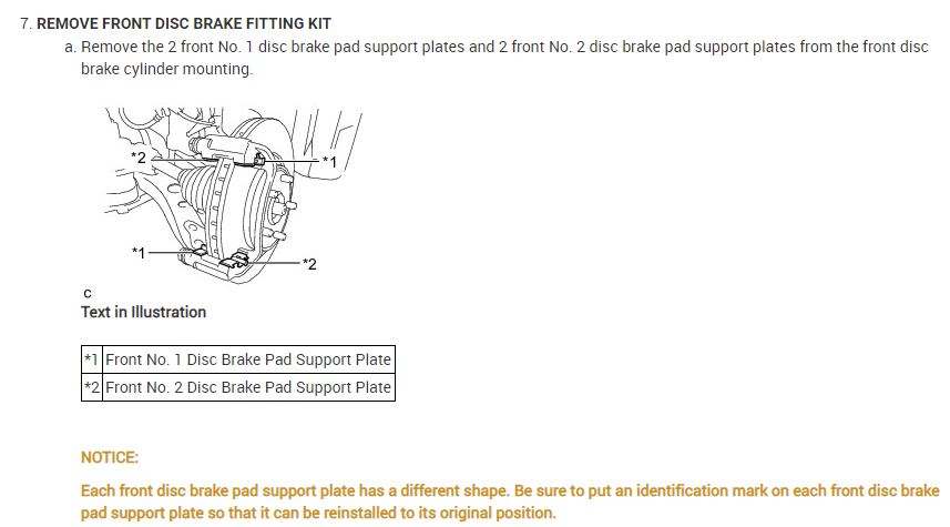

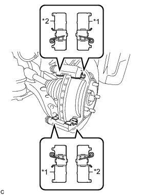

REMOVE FRONT DISC BRAKE FITTING KIT
Remove the 2 front No. 1 disc brake pad support plates and 2 front No. 2 disc brake pad support plates from the front disc brake cylinder mounting.
Pic 7
Text in Illustration
*1 Front No. 1 Disc Brake Pad Support Plate
*2 Front No. 2 Disc Brake Pad Support Plate
NOTICE:
Each front disc brake pad support plate has a different shape. Be sure to put an identification mark on each front disc brake pad support plate so that it can be reinstalled to its original position.

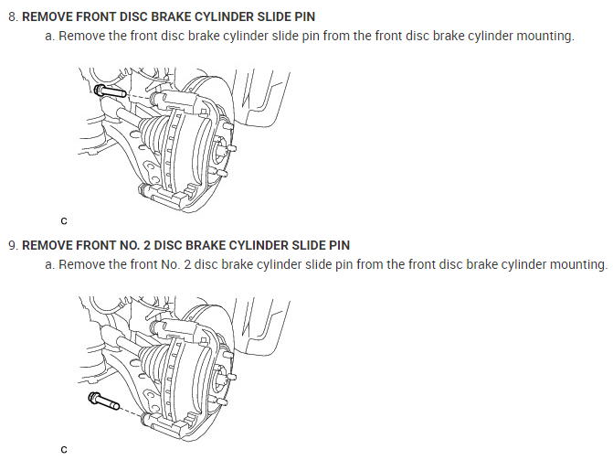

REMOVE FRONT DISC BRAKE CYLINDER SLIDE PIN
Remove the front disc brake cylinder slide pin from the front disc brake cylinder mounting.
Pic 8
REMOVE FRONT NO. 2 DISC BRAKE CYLINDER SLIDE PIN
Remove the front No. 2 disc brake cylinder slide pin from the front disc brake cylinder mounting.
Pic 9

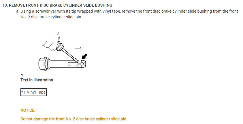

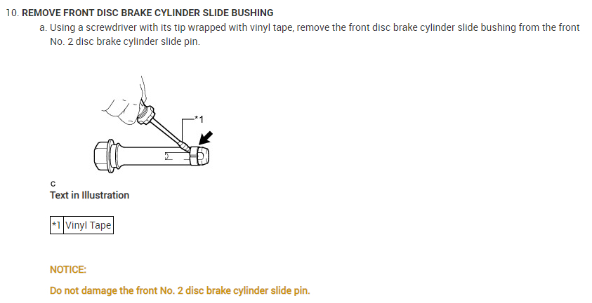

REMOVE FRONT DISC BRAKE CYLINDER SLIDE BUSHING
Using a screwdriver with its tip wrapped with vinyl tape, remove the front disc brake cylinder slide bushing from the front No. 2 disc brake cylinder slide pin.
Pic 10
NOTICE:
Do not damage the front No. 2 disc brake cylinder slide pin.

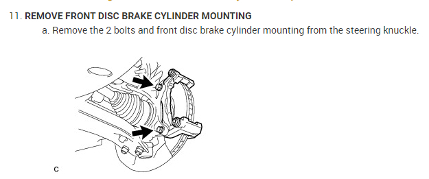

REMOVE FRONT DISC BRAKE CYLINDER MOUNTING
Remove the 2 bolts and front disc brake cylinder mounting from the steering knuckle.
Pic 11

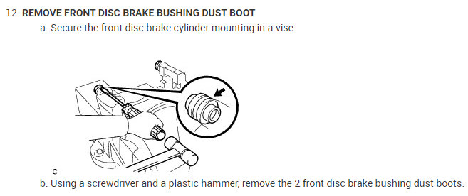

REMOVE FRONT DISC BRAKE BUSHING DUST BOOT
Secure the front disc brake cylinder mounting in a vise.
Pic 12
Using a screwdriver and a plastic hammer, remove the 2 front disc brake bushing dust boots.

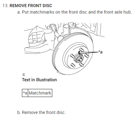

REMOVE FRONT DISC
Put matchmarks on the front disc and the front axle hub.
Pic 13
Remove the front disc.
