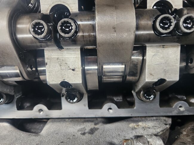

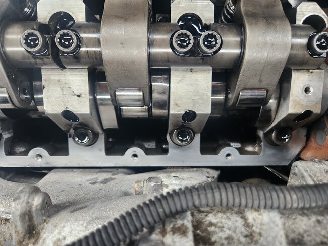

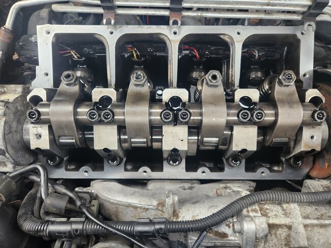

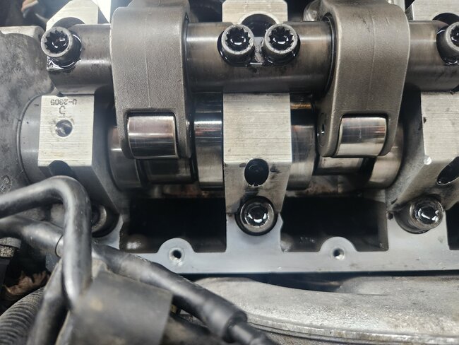

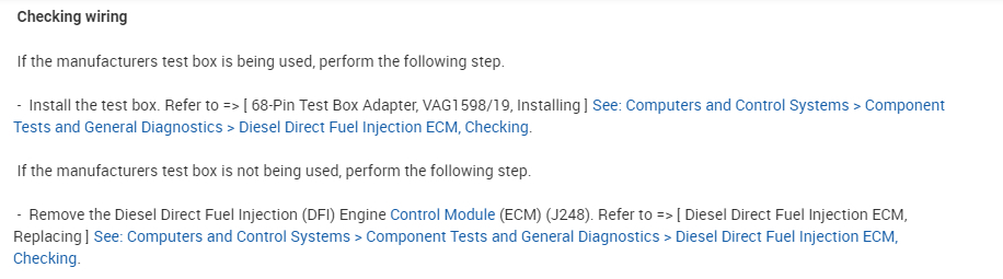

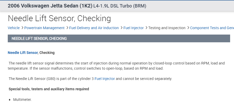

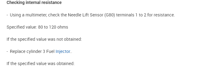

Upon rapid acceleration the vehicle blows black smoke until the throttle is let off. Initially the RPMs jump about 1000 so I'm assuming the turbo is working. I checked the vacuum at the pump, and it was about 30 inHg and at the turbo actuator where it was 24 inHg. I had an experienced VW mechanic listen to it and he thought it sounded like a misfire. Possibly a bad injector. I don't have a VAG-COM to aid in diagnosis. I removed the valve cover to inspect the cam and lifters and have included pictures of their condition. I was unable to remove the timing belt cover so I could rotate the cam to fully inspect the lobes and lifters but there does appear to be some wear and ridging on at least one lobe. I will inspect them more fully when I get the cover off. Then I can also adjust the clearance on the injectors. How do I know if each injector is working? It's not like I can check for a pulse since they are inside the valve cover. I'm new to this type of engine and any advice would be appreciated. The car is drivable, it just doesn't have the power it should.
