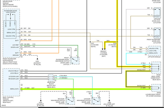

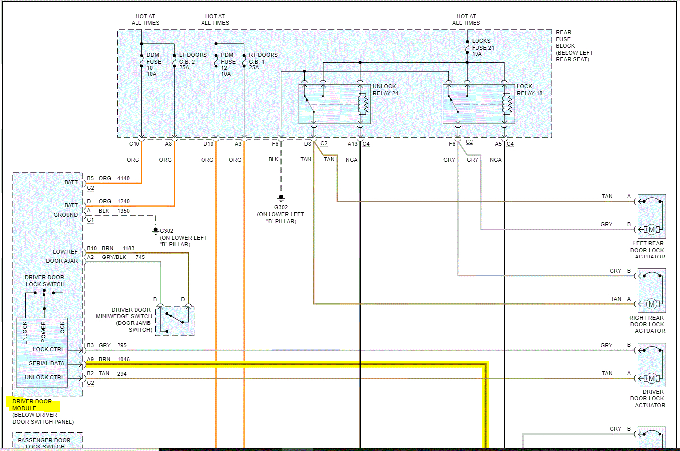

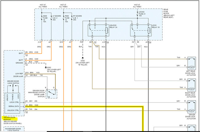

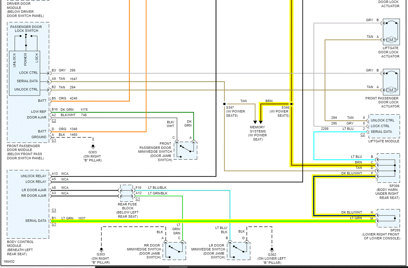

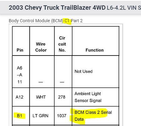

The only serial data line related to the DDM is from the body control module. I attached the wiring schematic below that shows how they are joined. I highlighted the wiring.

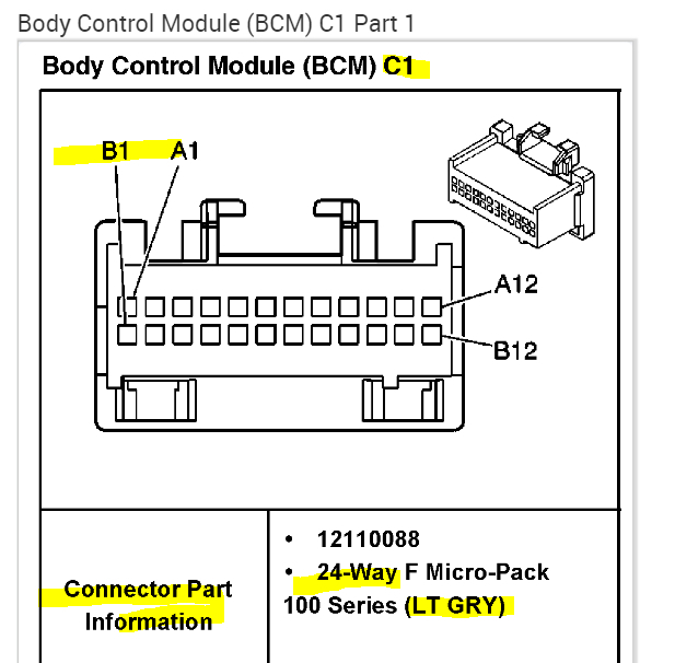

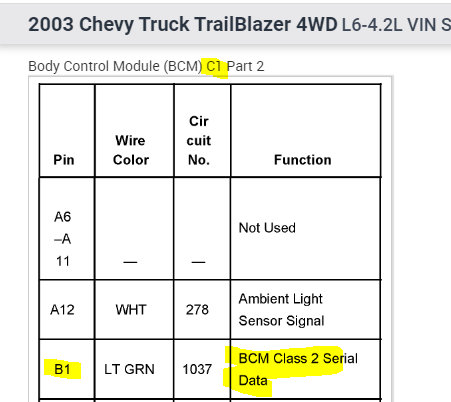

What I noticed is there is a splice under the right rear seat that may have been damaged or disconnected. This is where I would suggest checking. If the connection is good, disconnect the battery and check for continuity in the wiring.
See pics below. Note: It was one page long. I had to cut it in half to make it readable, but I did overlap the two so you can follow from one to the next.
