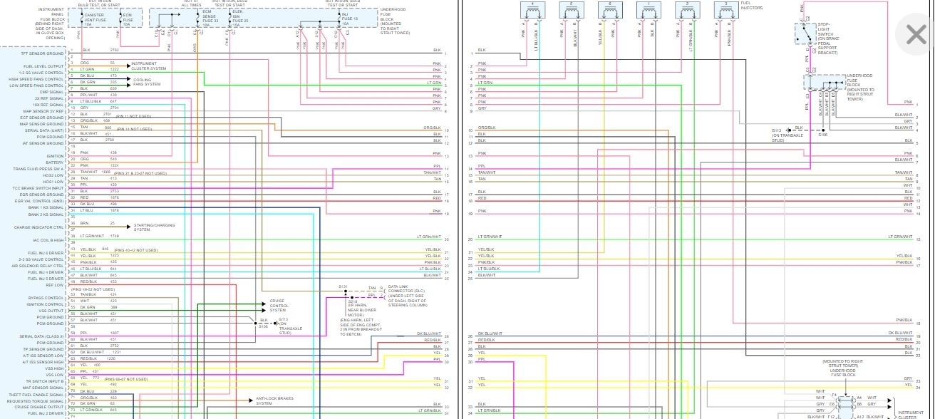

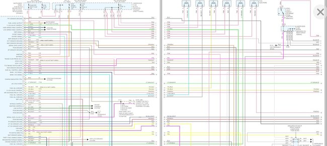

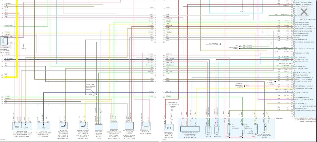

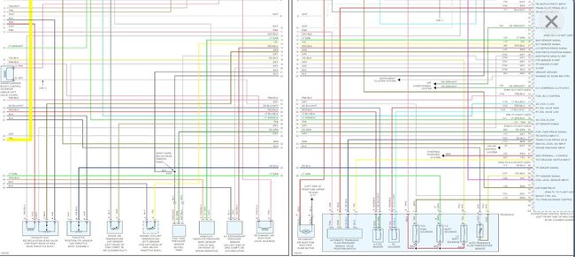

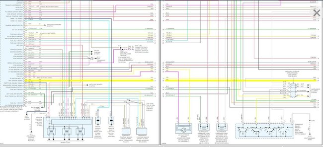

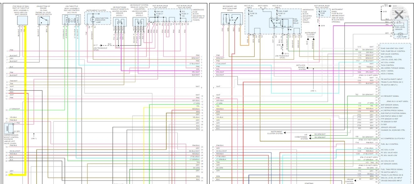

GTP 3.8l SC. Car had been parked for a while, upon getting vehicle back on the road , noticed engine was hesitant while accelerating . Also was not properly charging battery,so I thought. I actually think it was a unknown drain on the battery killing it. Got a jump start,headed to parts store to check alt.on the way blew the ignition main relay. Replaced relay with another. Blew that one as well, plus Another.had to tow vehicle. Started checking under hood fuse box for shorts .disconnected ignition control module wiring harness to check its power wire for voltage,and found the pink wire (12v+) to be grounded out. In fact nearly all positive wires under hood are grounded out. I've narrowed it down to the headlamp main fuse, battery main 1, and battery main 2 fuses. So I believe the short to ground is in those circuits or somehow related to all three.could it be PCM issue, BCM issue, or just a frayed wire grounding out the cars positive wires? Two weeks no car. Please help.
