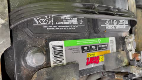

The vehicle will not start with a brand-new battery. The steering wheel doesn’t lock, and the key is locked into the ignition.

Thanks for the video, yep the car has no power, I saw the battery cable end which I believe is your problem. I would get a new negative battery cable end and re-strip the battery cable and reconnect the battery, the truck should spring back to life and the key will be able to be removed. Let me know.

So I went ahead and cleaned the battery cable and the car started. I drove the car around with no issues. However, I turned the car off and was able to remove the key from the ignition. After about a minute I went to start the car again and nothing. Car would not start.

I would get a new battery cable end and strip a new end from the cable, once the ends go bad for corrosion it is difficult to get them back to normal, ultimately a new cable would be best.
