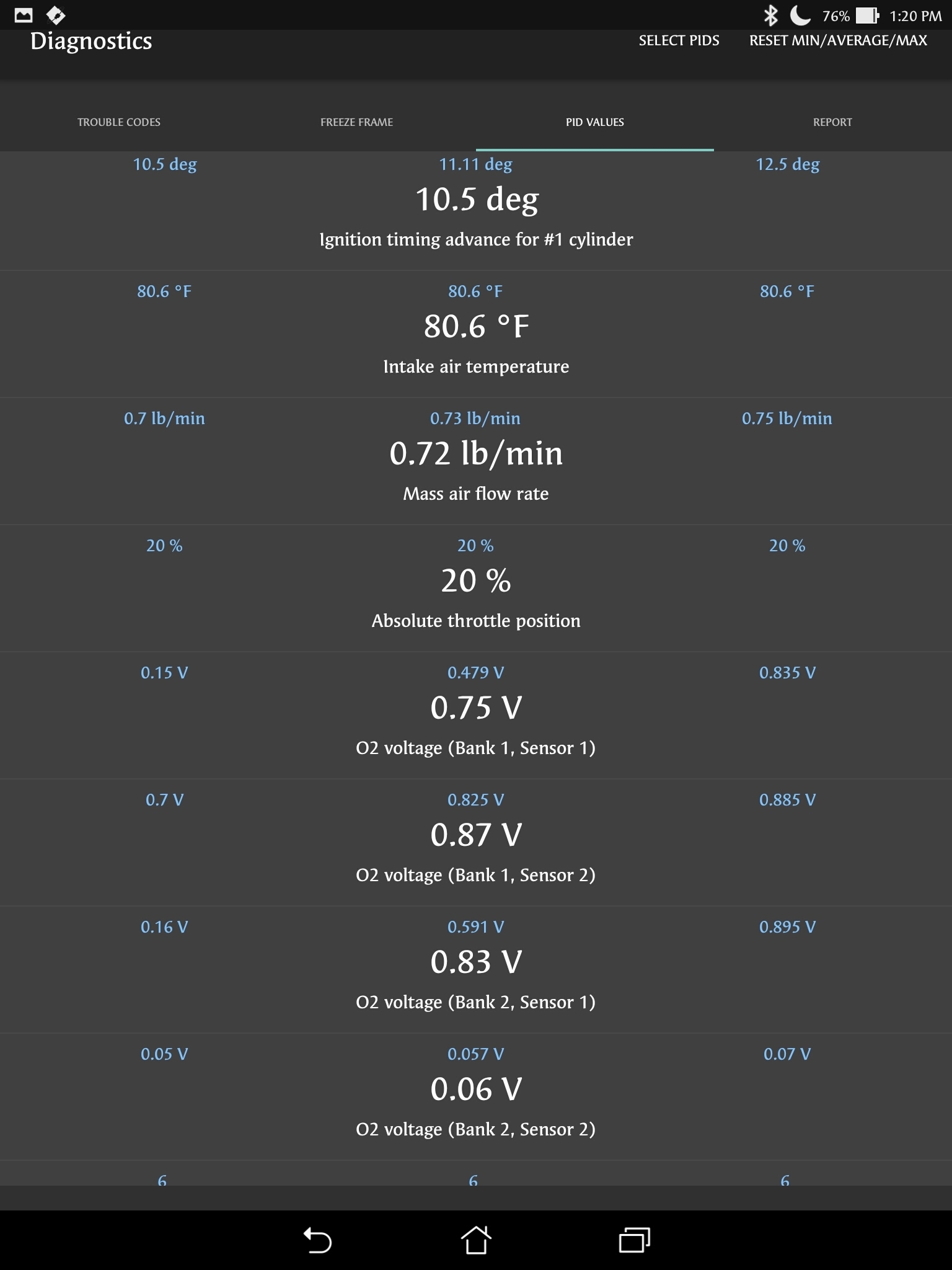

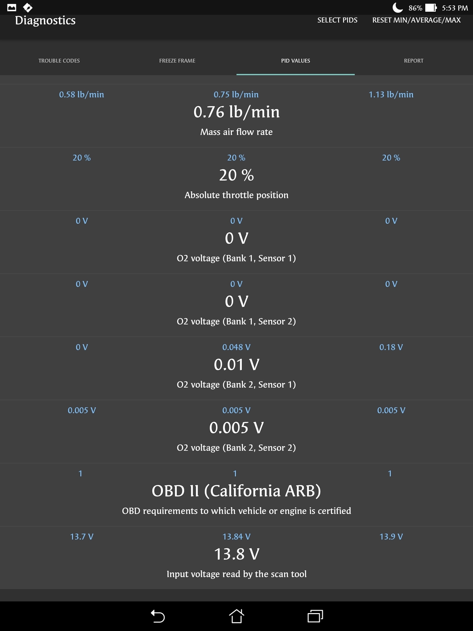

This vehicle does not raise or hesitate before it raise, I have diagnosed it after certain distance drive but it is not record any fault code. I have used live data to view of a particular sensor is out operating threshold but could not see except Absolute Throttle Position that reads:20%,(I attached the picture below). At this point I am confused what could be problem, any suggestions would be appreciated.

I have a couple of questions. First, I noticed no voltage signal on two of the oxygen sensors and very little response on the others. Was this test done when the engine was at operating temperature?
Next, absolute throttle position, is that a reference to the manifold absolute pressure sensor or the throttle position sensor?
Is it possible for you to provide the short-term fuel trims for me?

Was this test done when the engine was at operating temp? Yes the engine has reached operating temperature.
Next, absolute throttle position, is that a reference to the manifold absolute pressure sensor or the throttle position sensor? It's for reference to throttle position sensor.

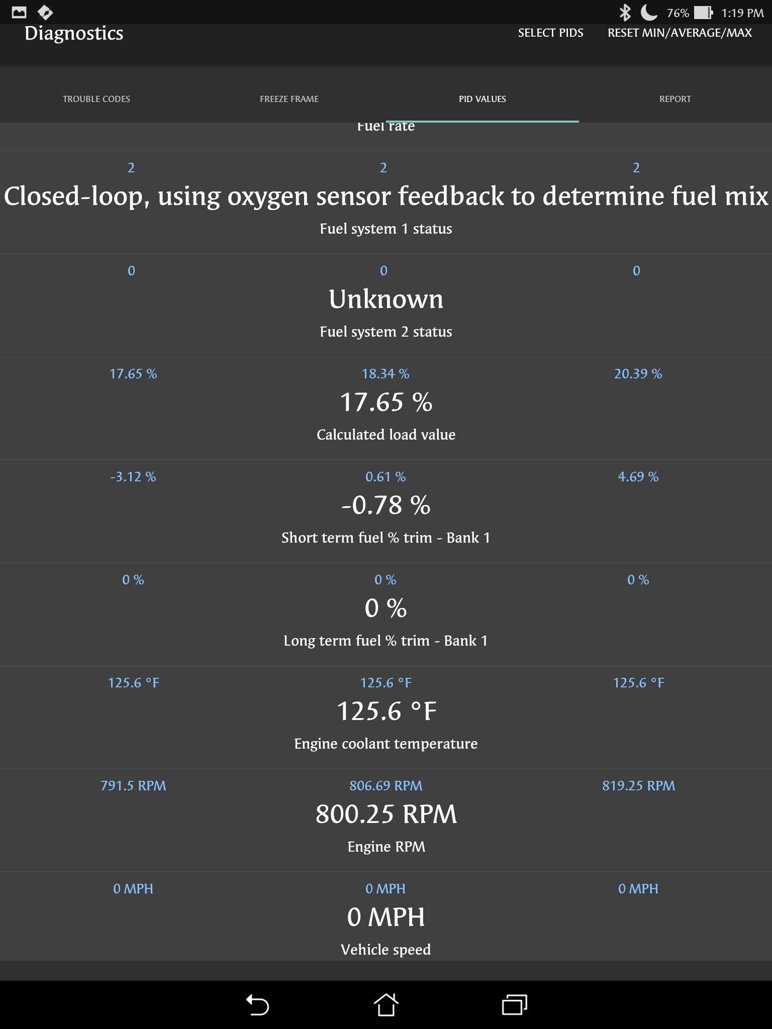

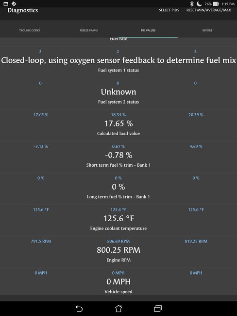

MALLYBOY
  • 327 POSTS
Hello! Good evening, Is it possible for you to provide the short-term fuel trims for me? Yeah I have provide it, look at the picture below.
Sep 24, 2021 at 1:13 PM
The short-term fuel trims are good. You want them to be between positive 10% and negative 10%.
If you are seeing 20% for the TPS at idle, something is wrong. At an idle, it should be around 0% to 2 or 3%.
Have you removed the connector at the TPS to inspect for damage or corrosion?
