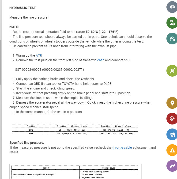

Based on this info I would suggest we double check and make sure the fluid is full. I assume it is but here is a guide that will help:
https://www.2carpros.com/articles/how-to-check-and-add-transmission-fluid

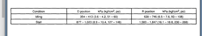

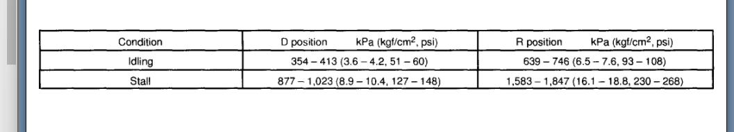

If the fluid is full then we need to do a pressure test and find out if this is low in reverse which I suspect it is.
This means we are most likely going to find an issue in the unit, but we need to start with this.
I am attaching the process below and the proper pressures.

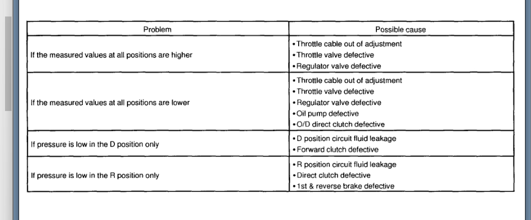

Then if you find it low in reverse only, the chart below will tell us what the issue is going to be.
Let me know what you find with this.
