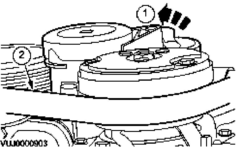

3. Detach the accessory drive belt.
- Rotate the accessory drive belt tensioner counter-clockwise.
- Use a 3/8 inch square drive bar to rotate the accessory drive belt tensioner.
- Detach the accessory drive belt.
pic 1

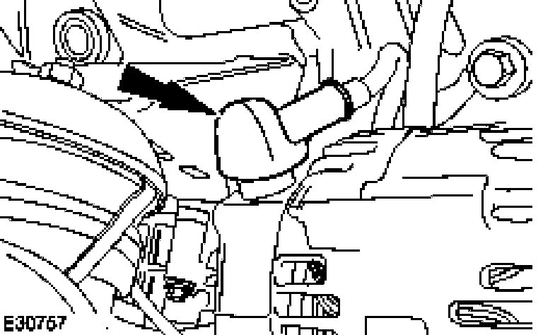

4. Detach the generator battery positive cable protective cover.
pic 2

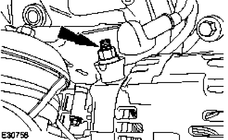

5. Remove the battery positive cable retaining nut.
pic 3

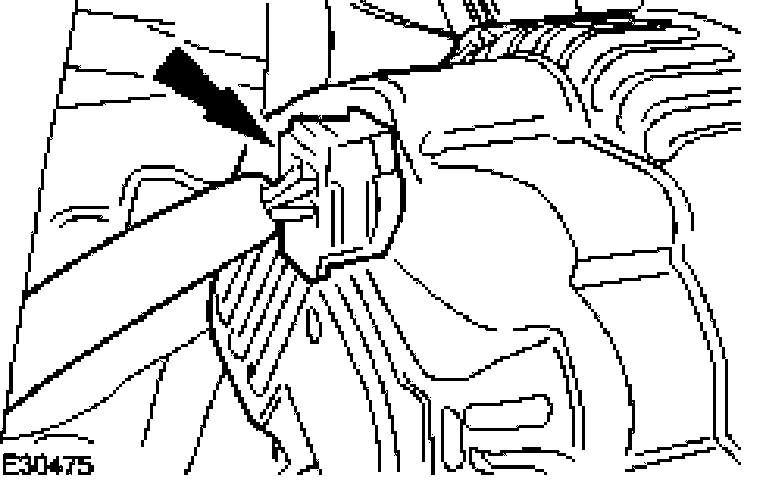

6. Disconnect the generator electrical connector.
pic 4

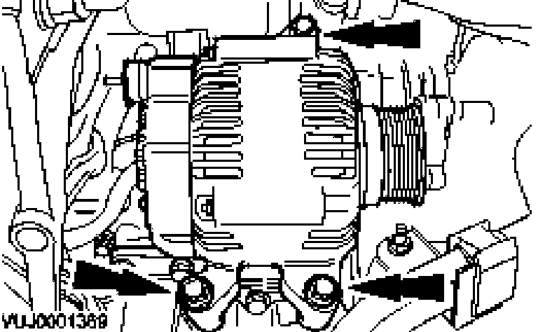

7. Remove the generator.
pic 5
