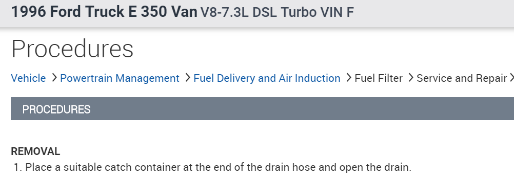

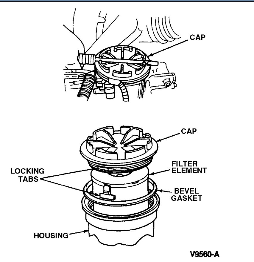

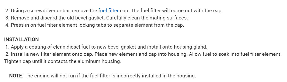

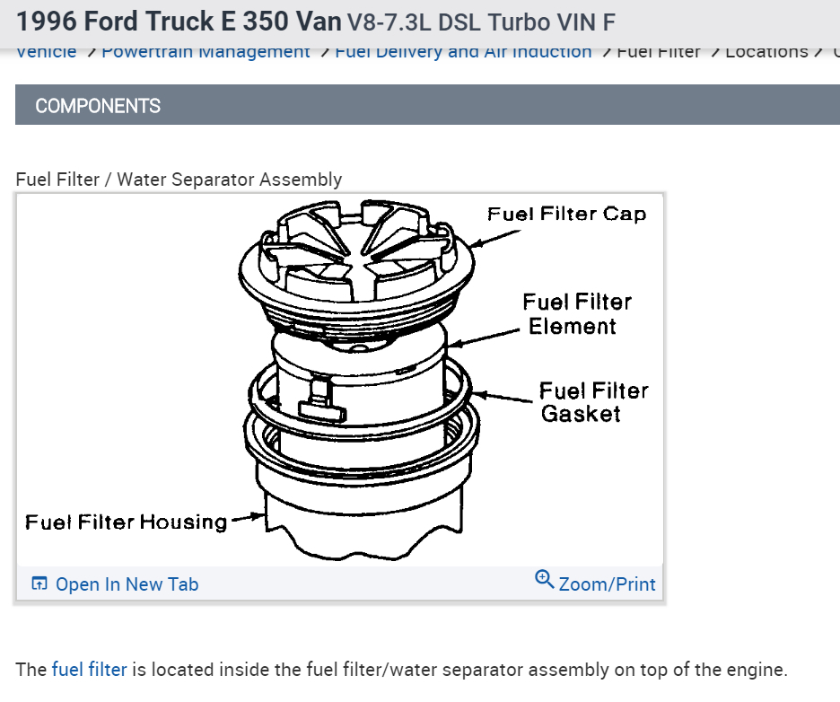

Parked my cargo van. Below zero temperatures. Plugged in the heater. Started fine and ran thirty seconds. Shut off as if ran out of fuel. Have not been able to restart. Weather has warmed into mid 20's. Fuel is blended as per station I bought it. Fuel filter issue? Where are they on cargo van?
