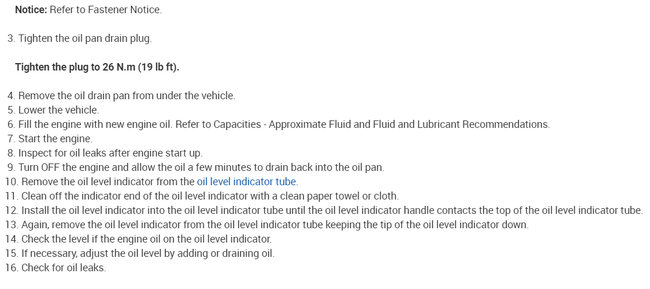

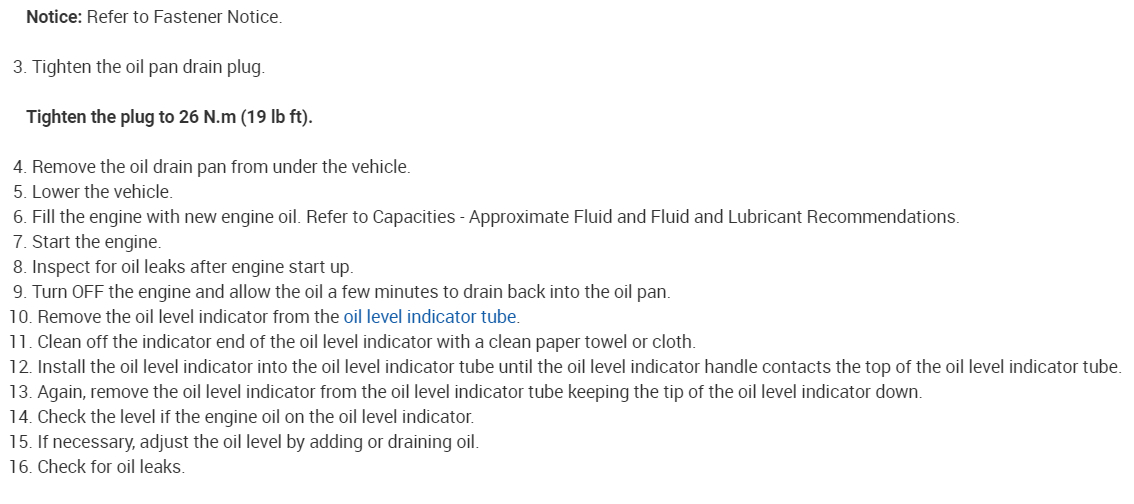

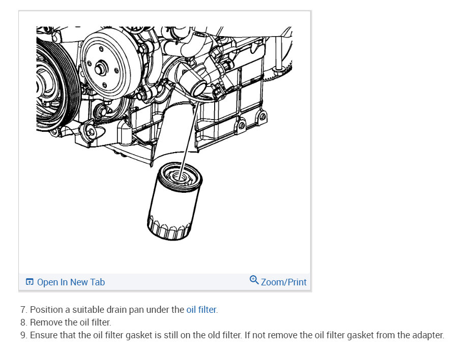

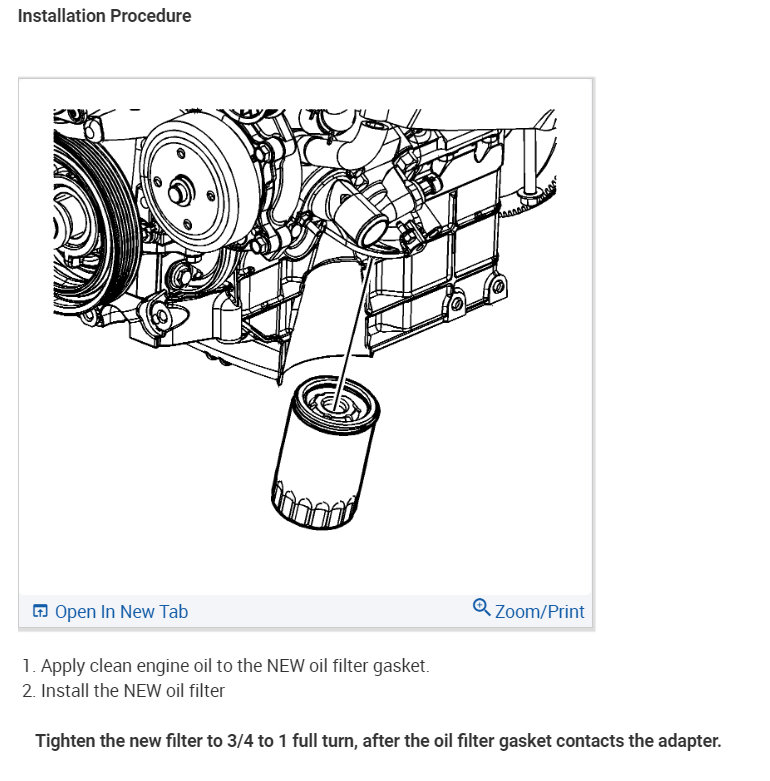

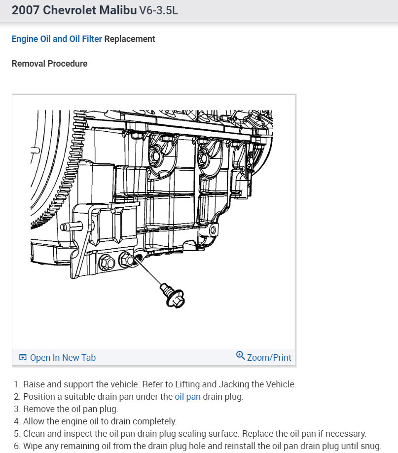

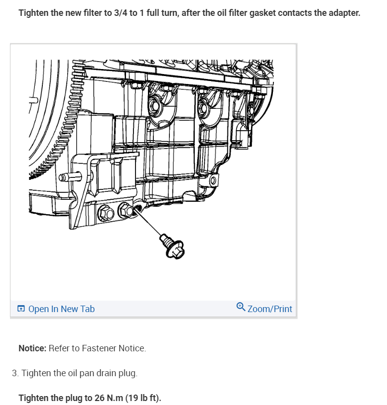

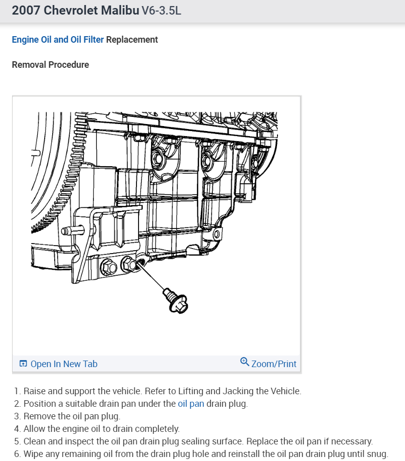

I would try to change the oil to see what happens. Here is a generic guide to help with instructions for your car in the diagrams below:
https://www.2carpros.com/articles/how-to-change-engine-oil-and-filter
