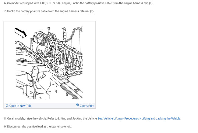

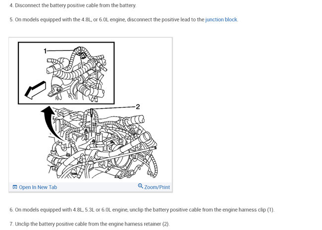

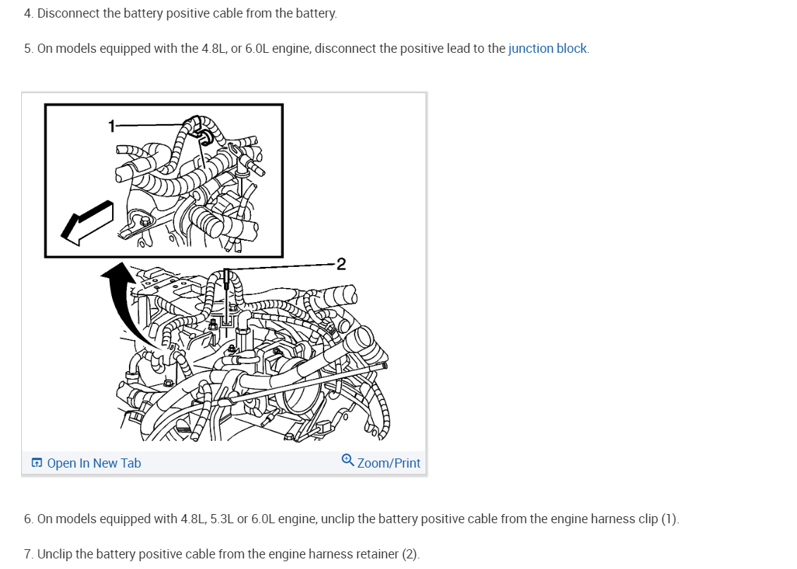

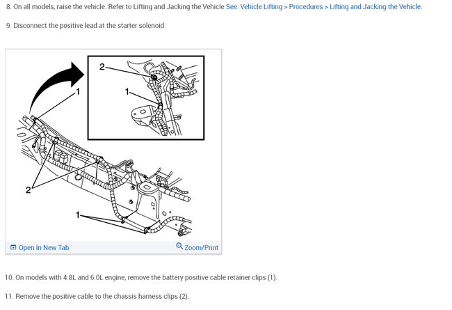

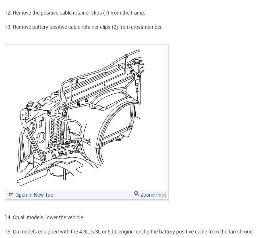

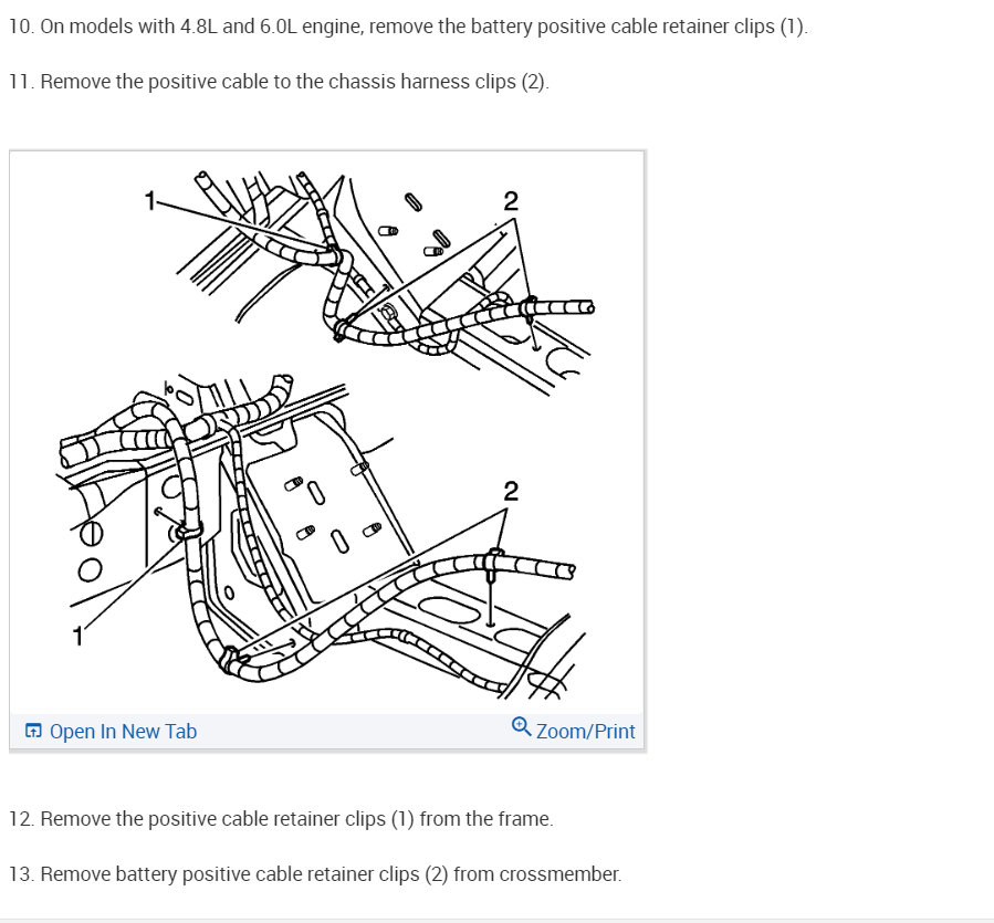

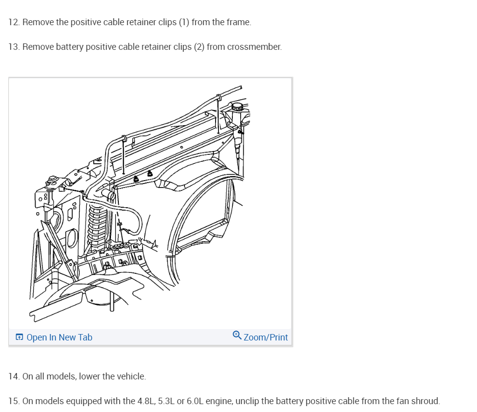

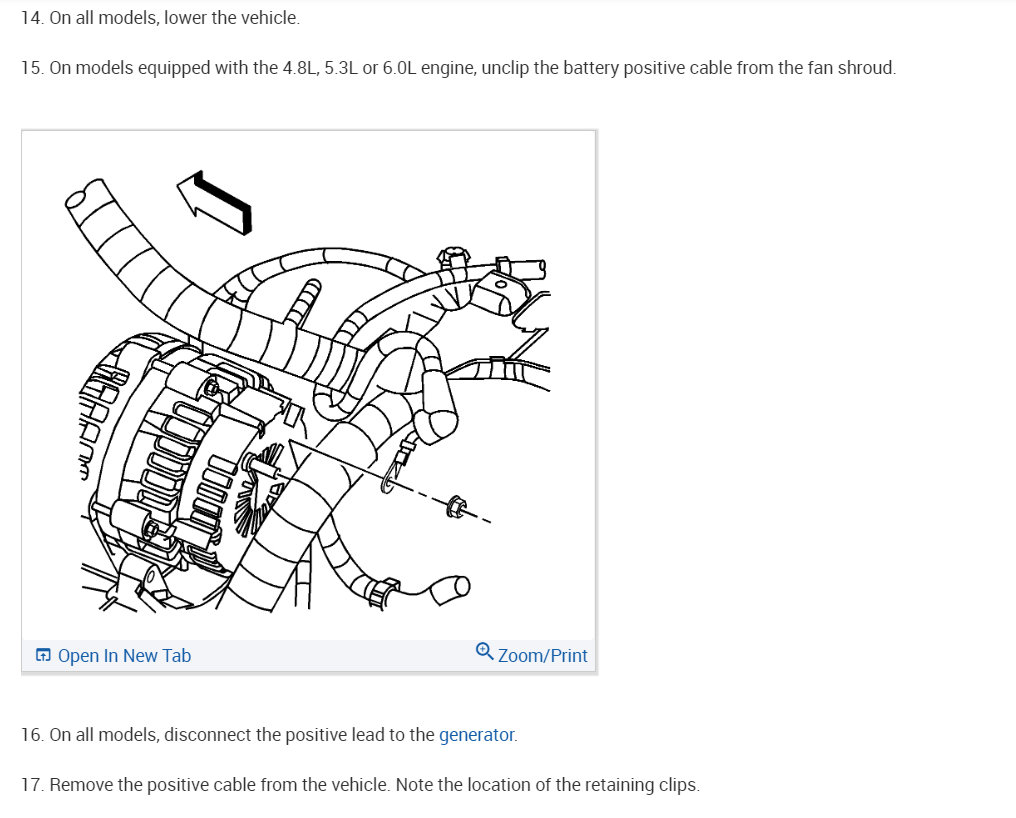

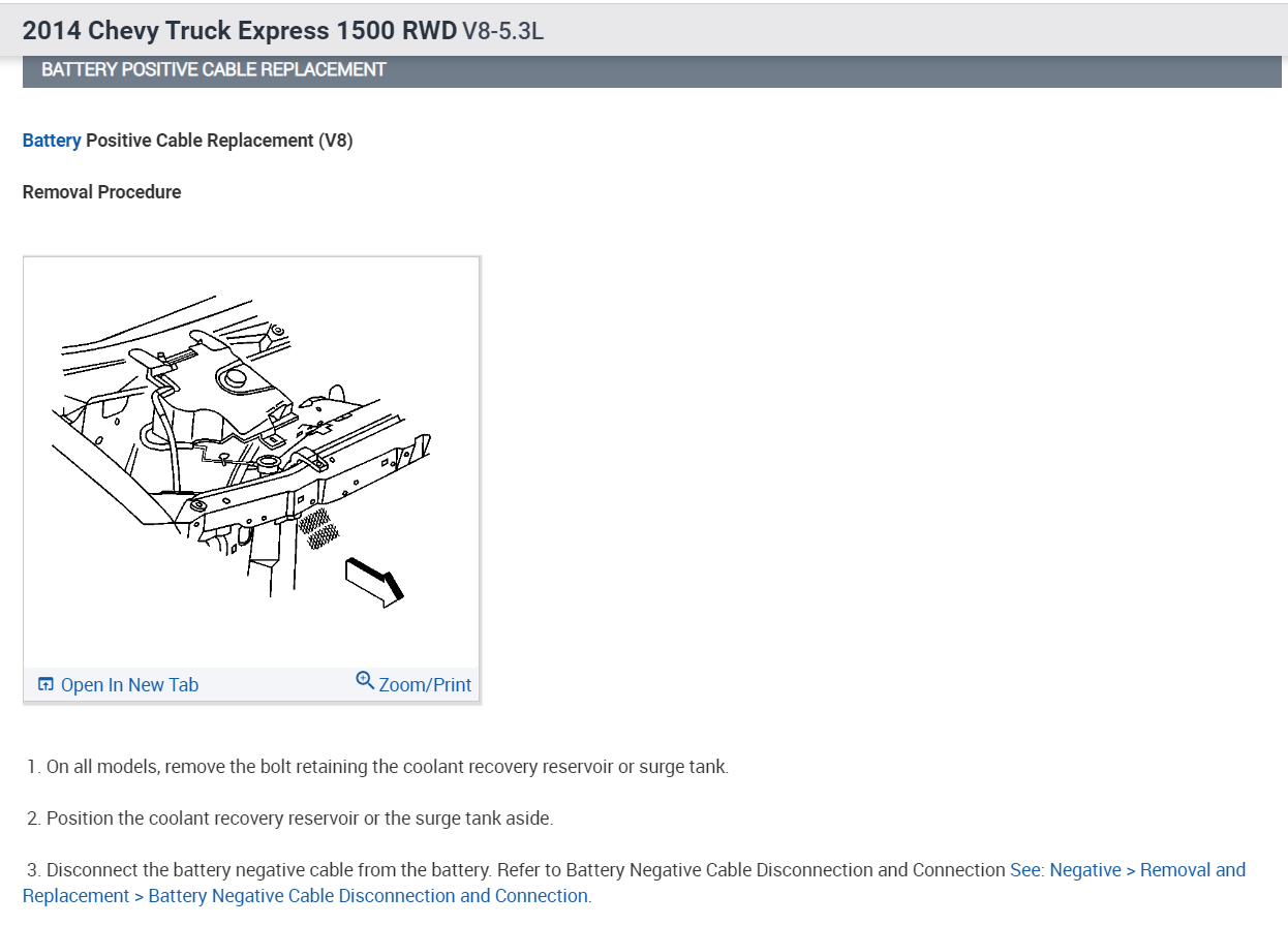

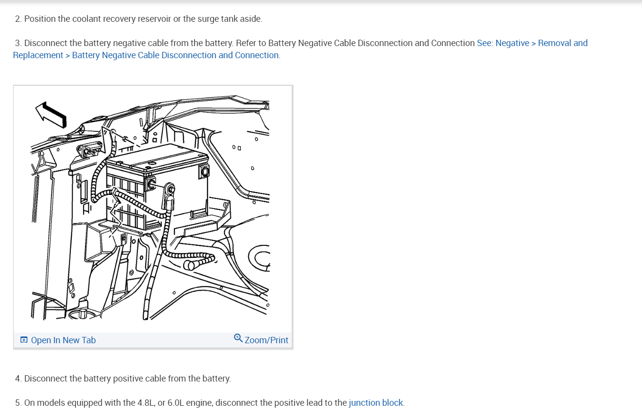

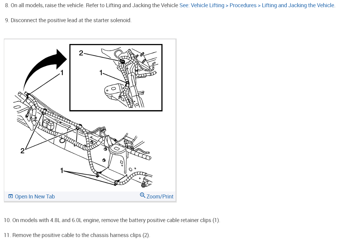

It sounds like you are losing connection at the positive battery cable. Here is how to change it out to fix the problem. This guide can help as well:
and
https://www.2carpros.com/articles/starter-not-working-repair
Check out the images (below). Let us know what happens and please upload pictures or videos of the problem.
