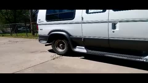

Okay, guys my van is acting up again.. my van is jerking when you drive forward and it makes this sound at idle as well. so far there are no error codes. I think it maybe the fuel filter or the fuel pump or both myself. The fuel filter has been replaced in 2018 but the fuel pump has never been replaced since i bought it. The sound i wanted you guys to hear is at the beginning of the video and close to the end of the video. I just wanted to know what you guys think before i start buying parts again etc. Hope to hear from you guys soon like always etc. :-)

Is the noise that you are talking about the reving or ranging of the RPM? It sounds like it is searching for the correct idle RPM.

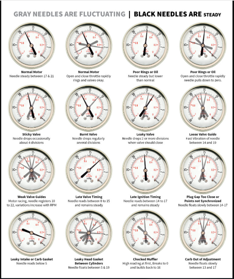

Here is the guide again but I would suggest stopping by a parts store and getting a vacuum gauge and hook it up to the motor through a vacuum line.
It may not be an external leak. It could be intake valves hanging open causing the leak. A gauge is the only way to show this. Attached is a diagram of common issues that are shown from the gauge.
