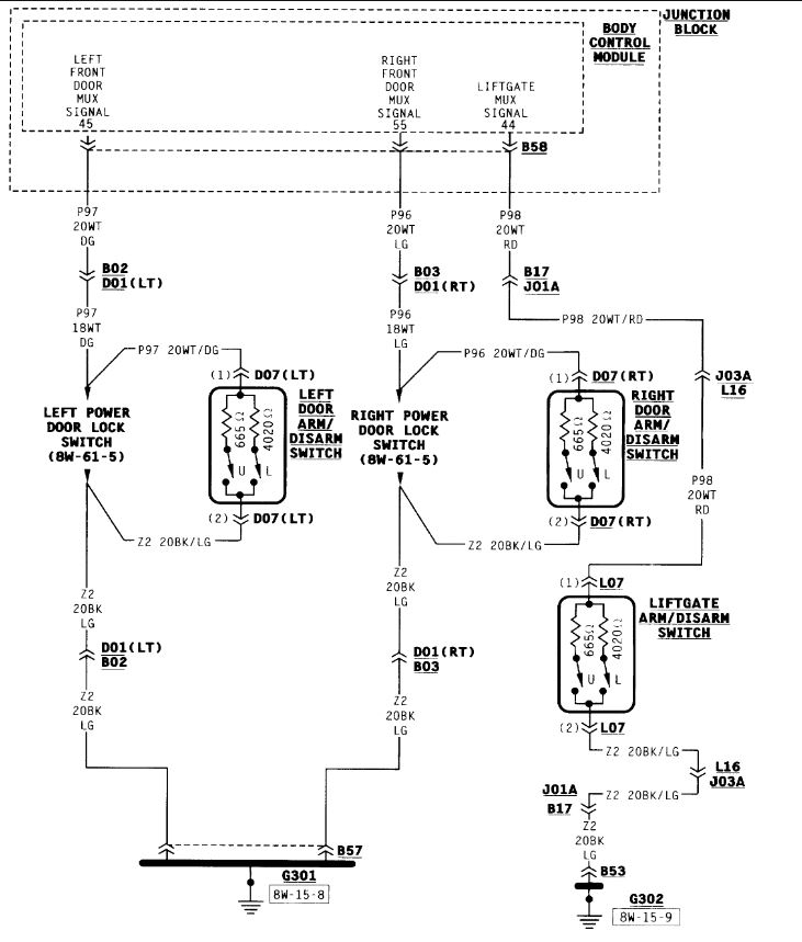

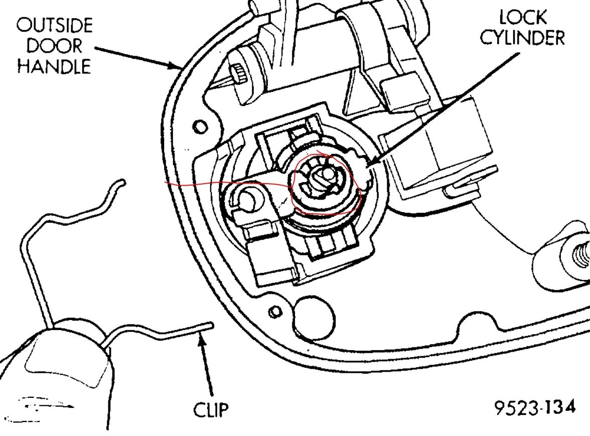

The wires can be broken internally but the actual switches are usually the problem. The ones in the doors attach to the back of the lock cylinder at the small pin I circled, but the last I knew they were a dealer only part, unless you can find them in a salvage yard. Testing wise there are a few shops that would have a tool that should work, you might call a few local to you and see who has one, the DRB3 should do it and that was the OE tool.
Most of the low cost aftermarket tools won't talk to the security system so that rules those out.
As you have taken the panels off you could do some testing yourself. For that you just need a cheap VOM that can read resistance.
Now go to the door alarm switches on the back of the lock cylinder and use the meter on the two leads in the connector. Now turn the key to lock and you should read 4020 ohms or real close to that. Then turn to unlock and you should see close to 655 ohms. If you see one that only shows the lock numbers and nothing on unlock that is the bad switch. If the switch tests good follow the wires to the door switches and test there as well.
