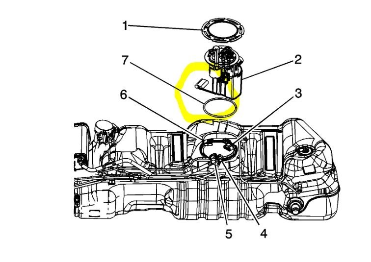

Good evening,
There is no adjustment for the gauge.
Good chance the float is the issue in the tank not reading correctly. Most likely will need to be replaced to get it to read accurately.
Otherwise, do not let it get that low and re fuel accordingly.
May 26, 2019 at 5:10 PM
Just to add, you will need to replace the sender unit assembly not just the float.
