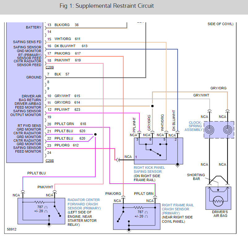

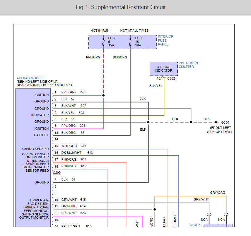

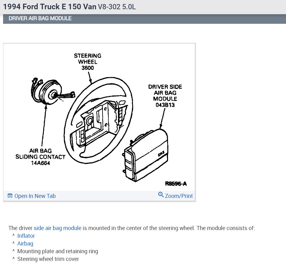

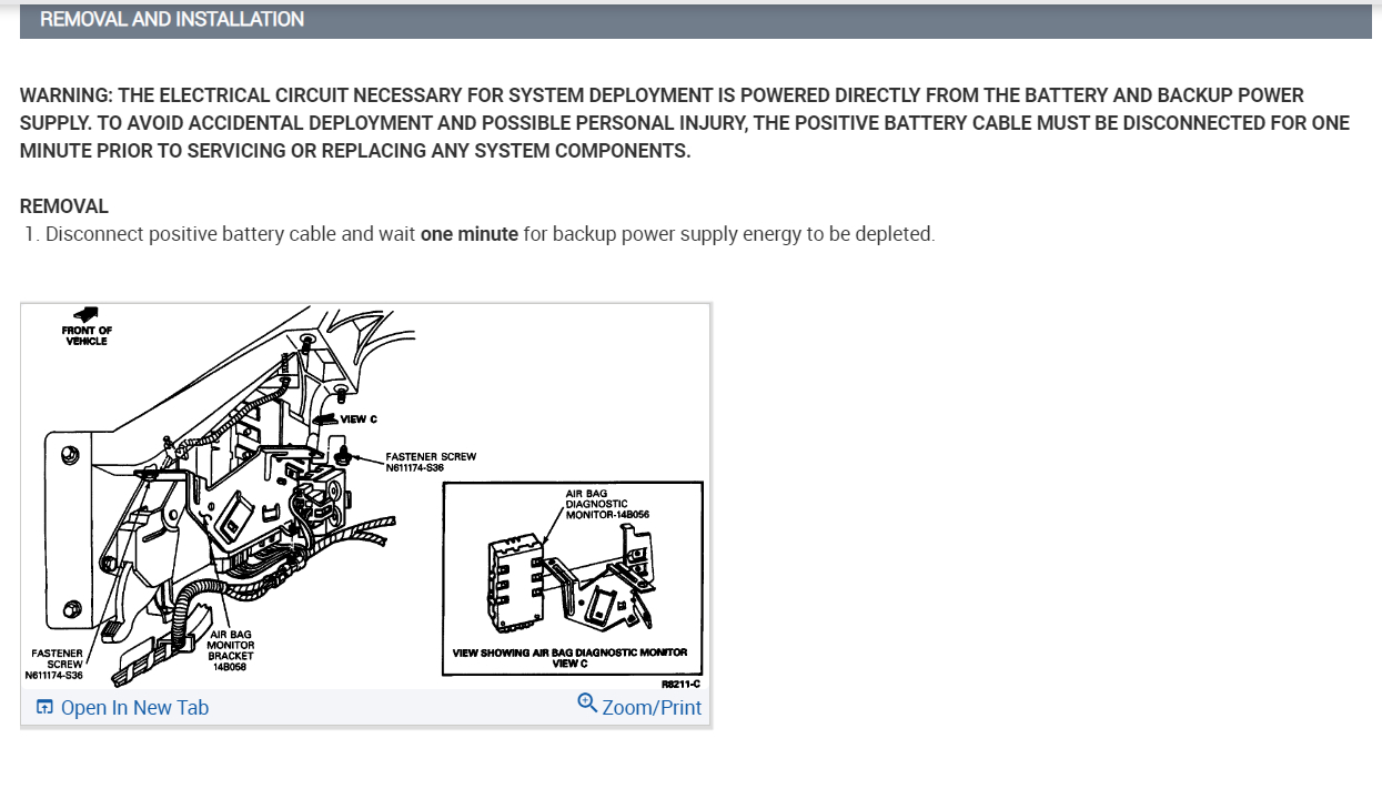

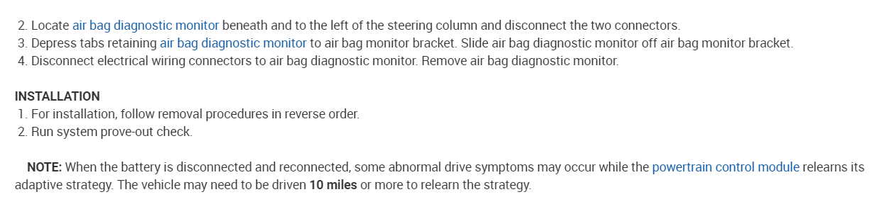

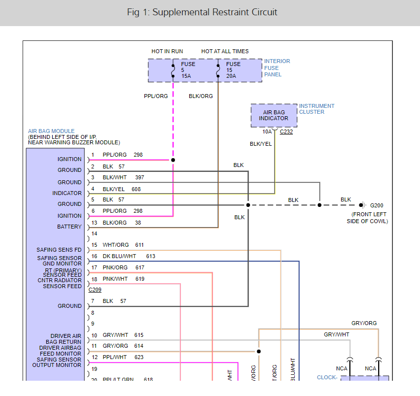

So, what happens is the airbag module or the spiral wire behind the steering wheel goes out. Here are the wiring diagrams so you can see how the system works and which wires to test to make sure they are working. Also, I have included the module location in the images below as well. Start by checking the fuses.
and
They call it a sliding contact. Check out the images (below). Please let us know what you find. We are interested to see what it is.

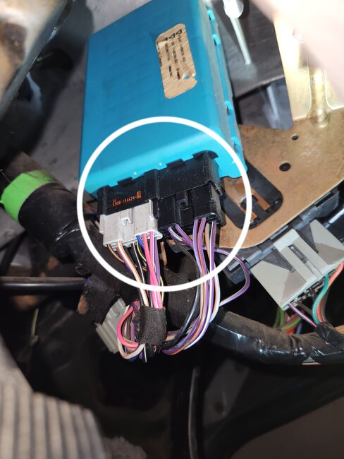

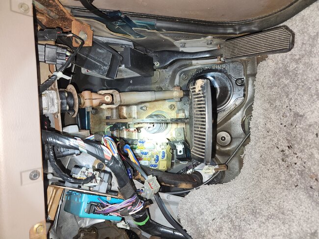

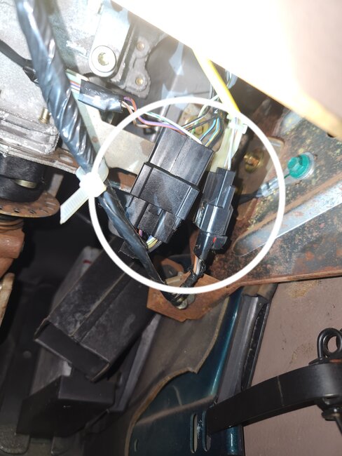

Also, i did inspect all of the wires beneath the dash leading from the airbag diagnostic monitor and fuse box and none seemed to have any damage (i included photos below). I'm not 100% sure which wires to voltage test, i circled all of the ones i believe I'm supposed to check but i wanted to ask first before i unplug anything.
Oct 31, 2022 at 5:18 PM

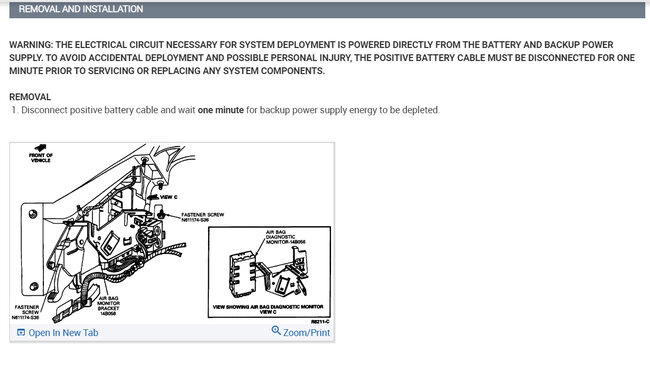

Thanks for the images, everything looks okay but before you start testing or removing anything undo the negative battery cable for 1 minute before work begins.

Okay, the image you shared up above says the positive battery cable, does it actually matter?
Nov 1, 2022 at 12:24 PM

I went ahead and removed just the negative battery cable and tested all 4 plugs i circled and got no reading on any of them. I'm not sure if thats because i'm testing them incorrectly or if the air bag module is bad and causes them not to work. Any info or advice is appreciated, thank you.
Nov 1, 2022 at 4:29 PM
If you are getting a good ground and power inputs the module is bad. I would replace the module.
