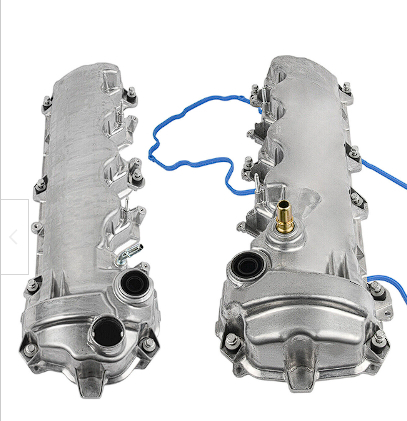

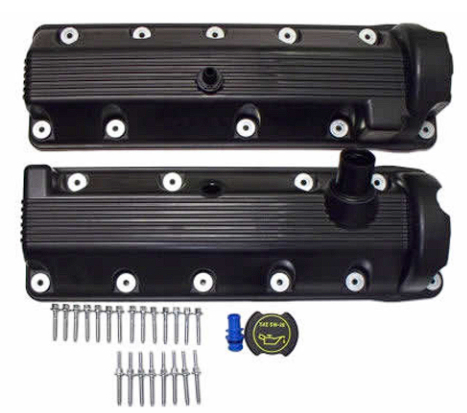

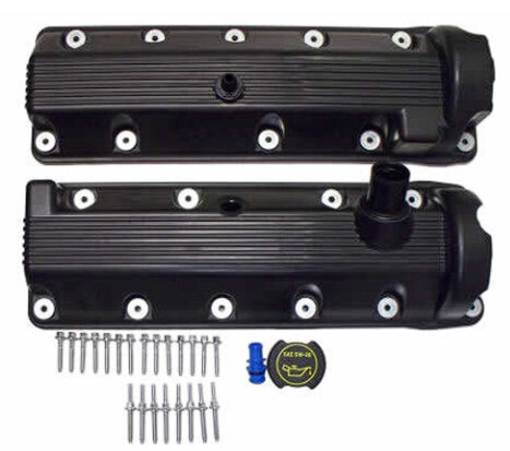

If you want to know at a glance, the black rocker covers are on 2-valve engines, 4.6 and 5.4. The silver/gray rocker covers are on the 3-valve versions.
