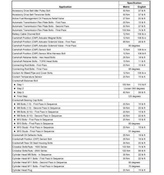

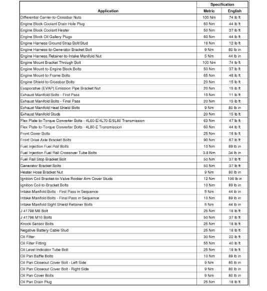

I need torque specs for the cylinder head bolts rocker arms and intake manifold bolts.
May 11, 2020 at 2:53 AM
CERTIFIED EXPERT
52,796 POSTS
Good morning,

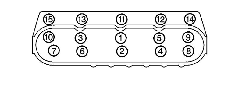

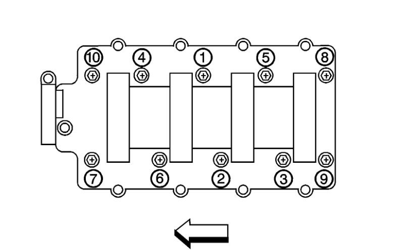

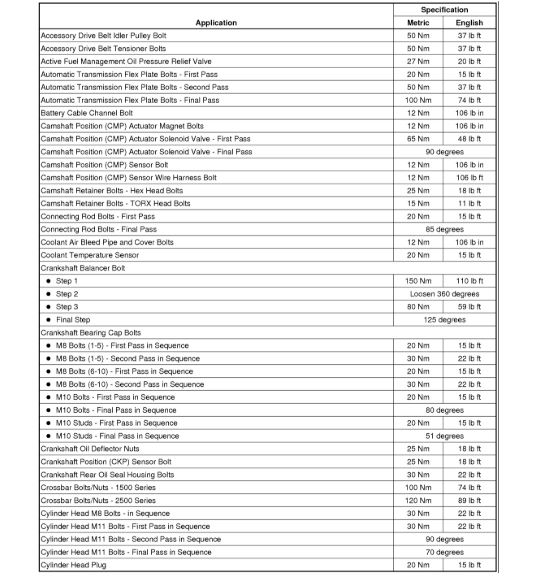

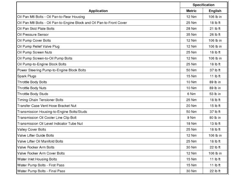

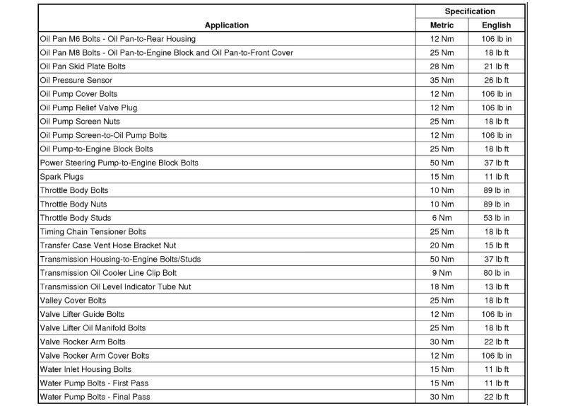

I attached all the torque specs for you fro the engine below.
I also attached the sequence for tightening the cylinder head and intake manifold.
Let me know if you have any other questions.

Hello, I'm Danny.
You didn't specify if it is the RPO L9H or the RPO L94 VIN H.
