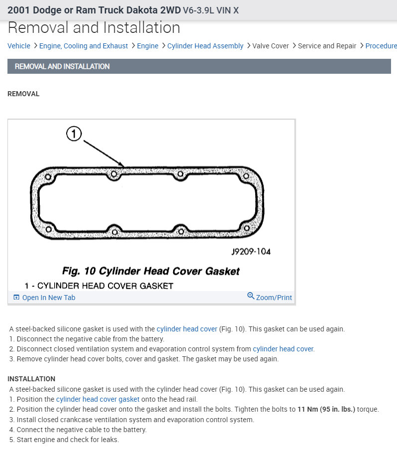

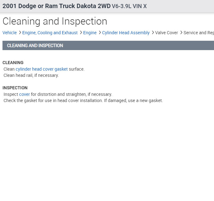

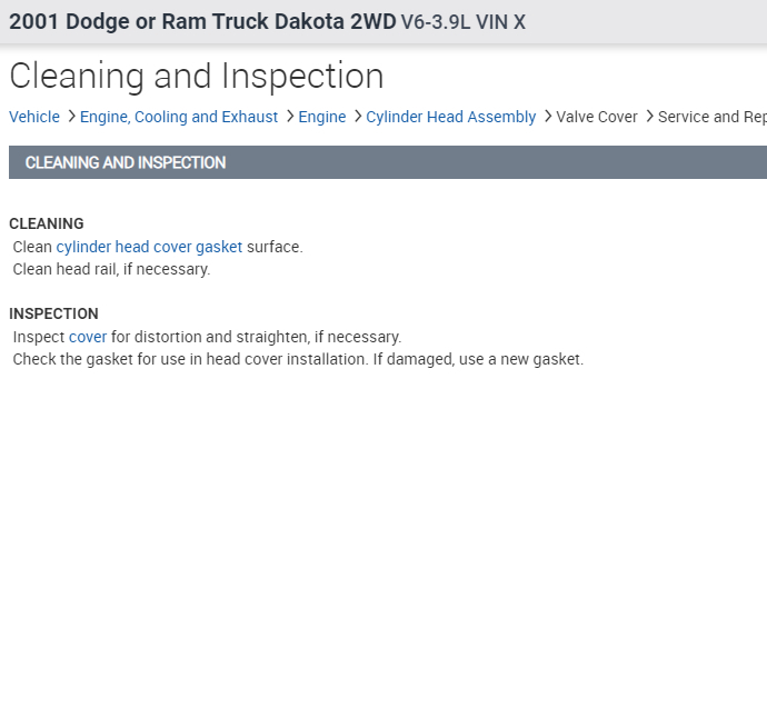

When i replace the valve cover gaskets what should i look at when the covers are off? Should i check for loose lifters or clean it up any? There is a slight tick I hear at times but I'm not sure if it's lifters.
Also, do i need to replace bolts or can i reuse the same ones?
Also, what is the torque spec on the screws?
Any additional info is appreciated.
