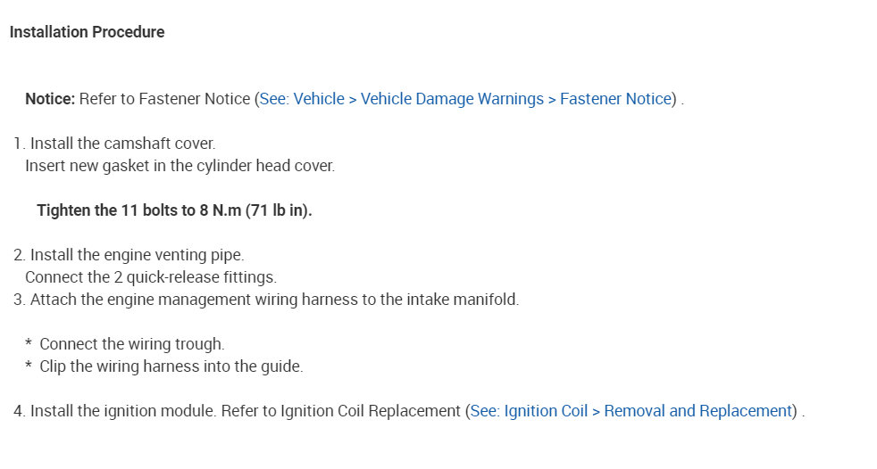

I am replacing the valve cover gasket on the car listed above XE model and am trying to find the torque and sequence for the bolts.
Sep 5, 2022 at 9:36 AM

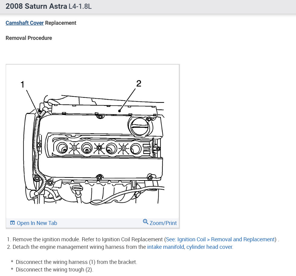

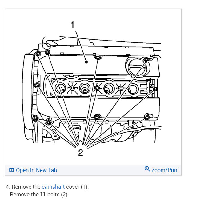

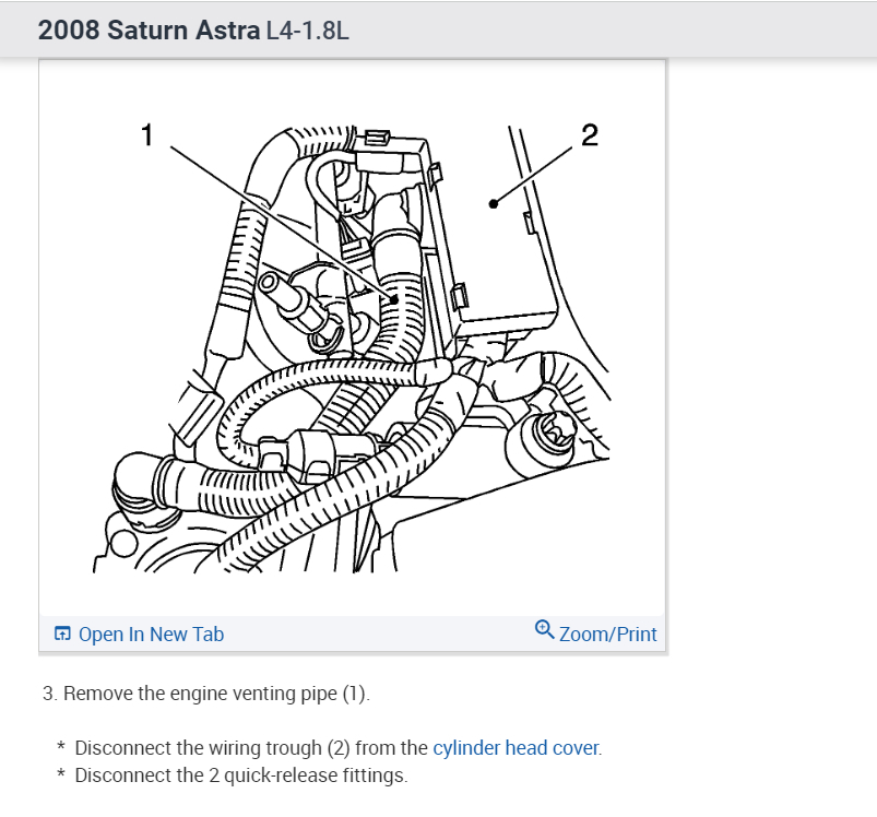

Here is a generic valve cover replacement guide so you can see what is involved in the repair and the instructions and torque specs to get the job done in the images below.
