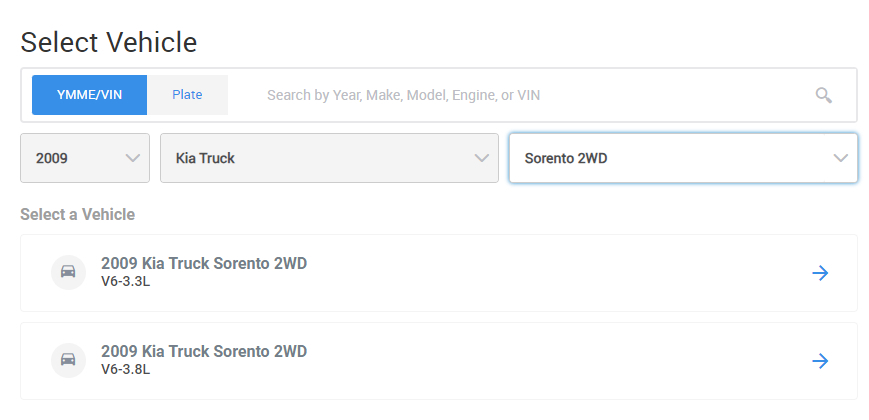

I tried to get the information for you, but they are only showing two V6 engines, a 3.3L and a 3.8L. See attached. I realize the crdi indicates a common rail direct injection and that is normally related to a diesel engine.
If that is correct, let me know. I don't believe that engine was offered in the US.
See pic below.

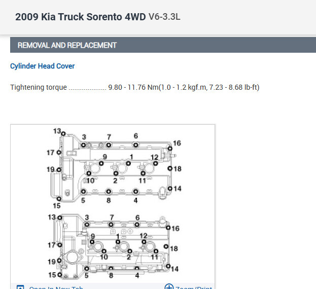

If the vehicle is the same year, make, and model, I attached the torque specifications below for you. Note there is a sequence that should be followed when doing this. Tighten them in the order indicated.
The actual torque specifications are located above the valve cover pic. It is 8.68 ft.lbs. I would go an even 9 ft/lbs but make sure not to go above that.
I hope this helps. If your vehicle is a different year, make, or model, please start a new thread and give us all the specifics.
Here is the link to start a new post:
Let me know if this helps.
joe
See pic below.
