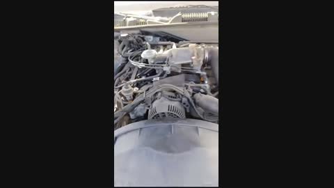

Here is a video of the noise.

Hello, just so you know, pulling the spark plug wire off a coil like that can damage the coil, it stresses it too much, but that noise sounds mechanical, when you're taking spark away from that cylinder there isn't as much pressure in the cylinder due to combustion not taking place. You might try pulling the spark plugs out and turn the engine over by hand slowly and see if you notice any noise. I have heard serpentine belt tensioners make a semi random tap like that as well, although I don't think it's a belt tensioner, but you can run the engine with the Serpentine belt off for a few seconds to see if the noise disappears, but you seem to be isolating it when disabling the ignition. Have you kept up with oil changes as well?
At least take the valve covers off and rotate the engine by hand, make sure there isn't a broken valve spring, lifter or anything on the top end causing the noise, see if any of the rocker arms are loose. It is noteworthy that the noise at idle is not consistent, only at higher rpm its more constant. Check the cam lobes for any wear or damage, with the valve covers off you should also be able to see the timing chains and check them for any slack on either side. If you have a stethoscope or long handled screwdriver you could identify the area where the noise is coming from better.
Having the spark plugs out will make it much easier to turn the engine over and possibly hear the noise from that cylinder as well. It could also be piston slap against the cylinder wall. It sounds so much worse when you raise the RPMs, it made me cringe a bit. I would also say maybe a timing chain component except it really does seem to be affecting just one cylinder. I've heard many of these Grand Marquis make these noises before, but it was always more of a constant rapping type of noise, whereas the high rpm causes this more.

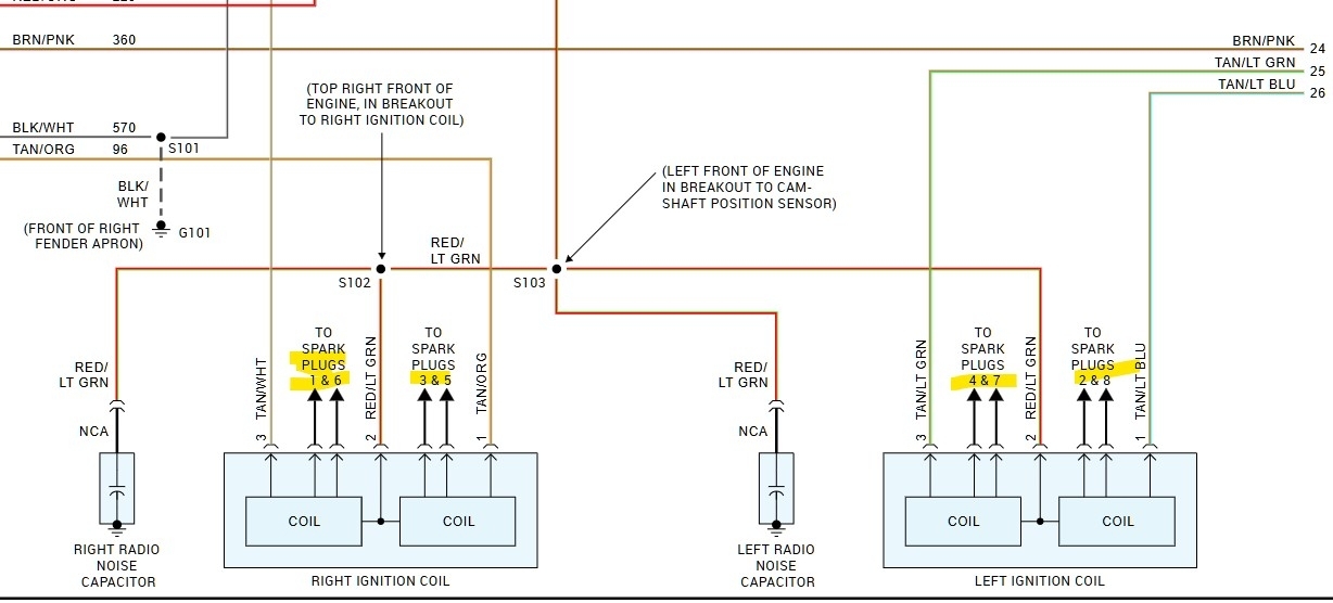

Your question regarding the ignition wire being disconnected is, this is a waste spark system, meaning one coil is firing 2 cylinders, when one cylinder is on its compression stroke, and another is on its exhaust stroke. The coil fires, spark travels through one plug wire to the spark plug, travels through the engine block to another spark plug on a different cylinder, through that plug wire and back to the coil pack. This car being a V8 has two coil packs with 2 coils per coil pack, here is a diagram of the coil packs. Cylinders 2 and 8 share a coil.
