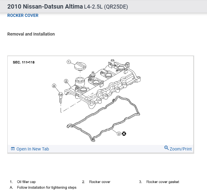

Just need to know where to support motor while taking off the motor mounts to get access to the valve cover.
Mar 29, 2023 at 12:51 AM

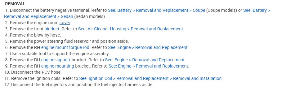

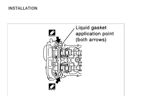

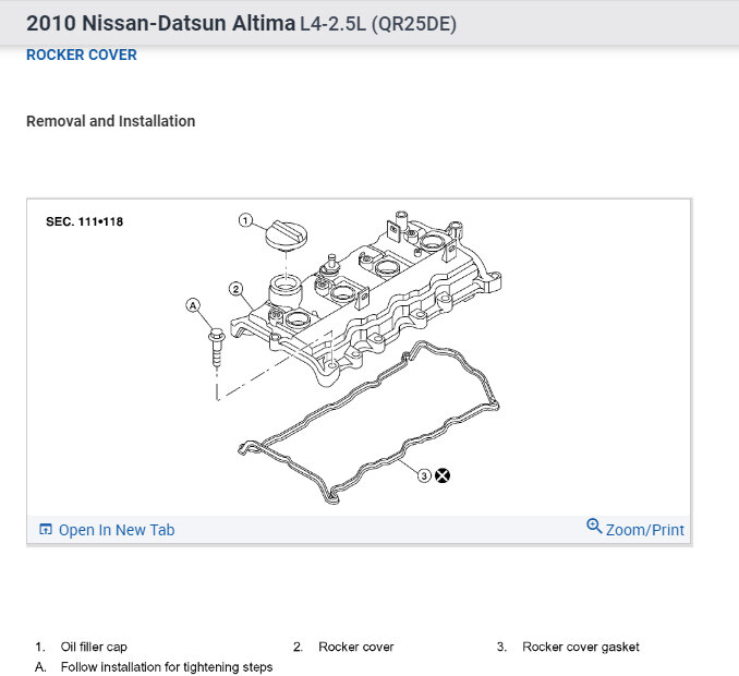

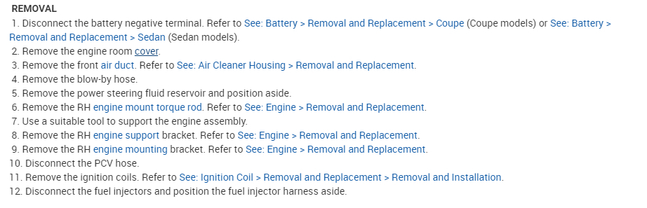

On these vehicles (not in a manual) I use a floor jack with a 2x6 between the jack and engine oil pan to support the engine. Only use it to support the weight of the engine or slightly remove weight from the mounts.

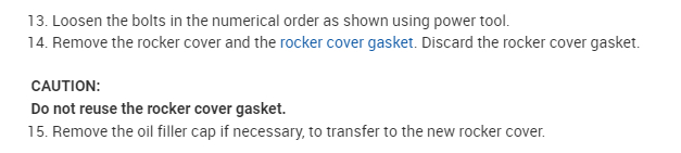

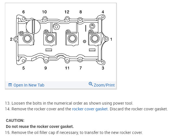

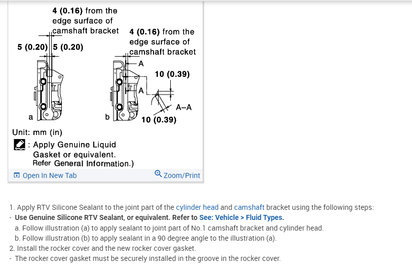

I attached the manual directions below for you.
See pics below.
