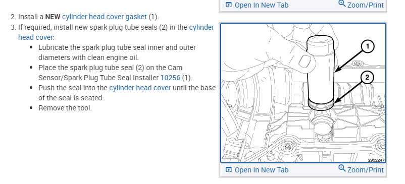

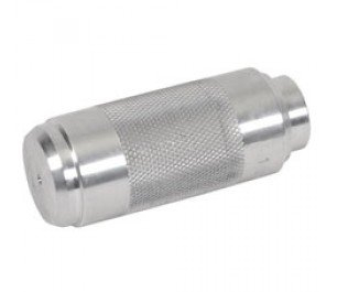

the center rings of the set are not going all the way in, they are too tight, how do i get them all the way if, is there a trick? do they have to go all the way in? the old ones seem to be.
the cover is plastic, so i don't want to hit it too hard and brake it.
